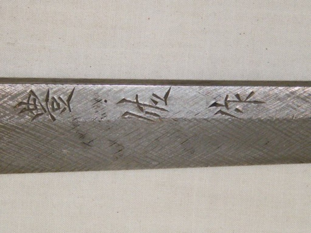

matt l Posted March 8, 2013 Report Posted March 8, 2013 Hello im a new member who seeks info. I have recently acquired a sword and would like to get opinions and help with the kanji. Quote

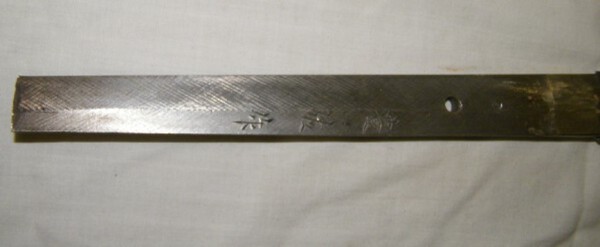

Jiro49 Posted March 8, 2013 Report Posted March 8, 2013 Hello, you need to post pictures of the nakago. Also an overall shot of the blade would help as well.. Regards, Quote

cabowen Posted March 8, 2013 Report Posted March 8, 2013 Stain resistant, machine made, Naval blade. Not traditionally made. Quote
Brian Posted March 9, 2013 Report Posted March 9, 2013 The "sake" part is actually "saku" and means made. So "made by Toyosuke" if that translation is correct. Mill steel swords, with very little "making" by the smith since these weren't even quenched imho (or were they? Stainless doesn't have a hamon...) Brian Quote
ROKUJURO Posted March 9, 2013 Report Posted March 9, 2013 matt l said: ..... The Northern California Japanese Society said the kanji were TOYOSUKE SAKU. Here in Sacramento I have a very reputable jeweler who has a spectrometer that analyses metal down to the parts per mil. I had the blade and its parts analyzed, the blade came back 99.9 percent pure iron with no trace elements....... Matt, if you had a 99.9% pure iron blade then it would be worth something because this material is quite expensive (see: http://www.aksteel.eu/de/1-produkte/0-reineisen/). On the other hand you could bend it with two fingers (or three...). So I am quite sure that the jeweler's spectrometer can perhaps tell tomorrow's weather but is not as precise as you would like it to be. If it had measured 99,4% or less, then I would have believed the remaining percentage to be carbon and this would have left some hope for a good tool steel. Stainless steel is another story: to make a corrosion resistant steel you want to have about 17% of chromium in the alloy. If your sword proves to be stainless as it looks to be, then the spectrometer is perhaps only working for gold alloys. Quote

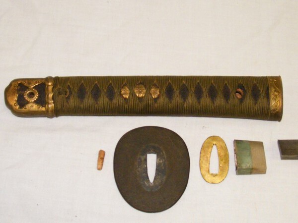

george trotter Posted March 10, 2013 Report Posted March 10, 2013 Matt san, You don't describe the mountings (Army, Navy?) but this blade definitely looks to be anti-rust steel (we call them stainless) made in great numbers for naval officers in WWII. They are very characteristic and often have a anchor inside a circle stamp (yours seems to have a small stamp above the signature?...what is it?). Look on the thread here called "Arsenal Stamps" I think there are a few pics of similar tangs. Telling you anything about the smith is difficult as virtually nothing is presently known about the Navy sword smiths...either traditional smiths or those who made the more common kaigunto like yours. Regards, Quote

sanjuro Posted March 11, 2013 Report Posted March 11, 2013 Matt. What you seem to be missing the point of here is that a sword is usually made of steel, ergo it has a carbon content. Pure iron (at 99.9% it would be as pure as possible), makes lousy swords which tend to bend even under their own weight and cannot hold an edge. Something is obviously amiss with the spectrometer reading or the guy interpreting the reading. The opinions given here are based only upon photographic evidence, yet they are seldom if ever entirely wrong, being founded in years of experience and a thorough group knowledge of the subject. Military swords and the materials from which they were made in particular are well documented and I would hazard a guess that none of them are made of what is definable as 'pure' iron. Even so, in the final analysis it is not a nihonto, being a machine made bar stock blade of second world war vintage. It is basically militaria. Little is known about some of the 'smiths' engaged in these factory operations, so nothing in effect can be relayed to you concerning the mei on your sword. However, if you think it is a beautiful sword then so be it. With no intention of being adversarial here, I'm just telling it like it is. Quote

george trotter Posted March 11, 2013 Report Posted March 11, 2013 Hi Matt, Can you tell us if that mark above the mei is a stamp? perhaps we can help you a bit further. Just as a hint...the higaki yasurimei (criss-cross file marks) are very common on navy anti-rust WWII kaigunto nakago (tang). While the blade may be pronounced "iron" by the analysis machine, it has some additive which puts it in the class of "anti-rust steel" (if I remember correctly it is sometimes written on the tang "fu-sabi') so yours, being unrusted in the tang I would say has some nickel in the mix. The members are simply trying to advise you that a "pure iron" sword is just too soft for practical use...this blade must have some degree of carbon for hardness and in this case, also some degree of (probably) nickel for its anti-rust properties. Hope this helps. regards, Quote
