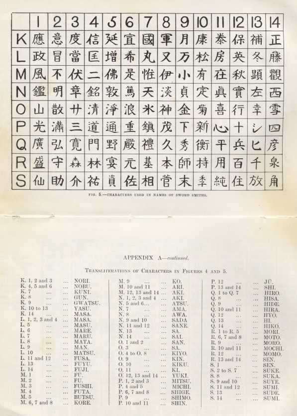

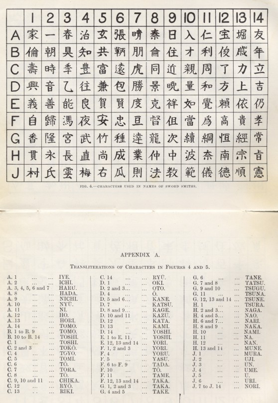

Stephen Posted May 19, 2007 Report Posted May 19, 2007 Welcome to the NMB see D5 for your Kane one of the better begginer books is the Samurai Sword a Handbook by John Yumoto very eazy to find with lots of common Kanji in the back. Opps is a good cleaner and will not discolor the blade dont know if they have it in the UK or not. Quote

Stever Posted May 19, 2007 Report Posted May 19, 2007 I use the 99% isopropyl you get at the druggists. Works just fine and that 1% H20 has not been a problem in any way. Stephen, where did you get those kanji sheets? They're great! And I agree, Yumoto's book is quite handy for kanji as well. cheers, /steve Quote

Stephen Posted May 19, 2007 Report Posted May 19, 2007 the tables are from Japanese Sword Blades by Alfred Dobree Quote
Splidge Posted May 19, 2007 Author Report Posted May 19, 2007 Thanks Steve for the welcome much appreciated. The book "The Samurai Sword a Handbook" is the first book I bought, thanks for the tables Steve realy helpful. Thanks all for the suggestions in which chemicals are available only now Im confused which is probably the best to use. I have been told that I could also use a mixture of charcoal and meths? but would'nt that create a mild abrasive Going back to the chemical way what about application, cotton wool bud or small artists brush? I was told not to use the cottonwool bud? Quote
