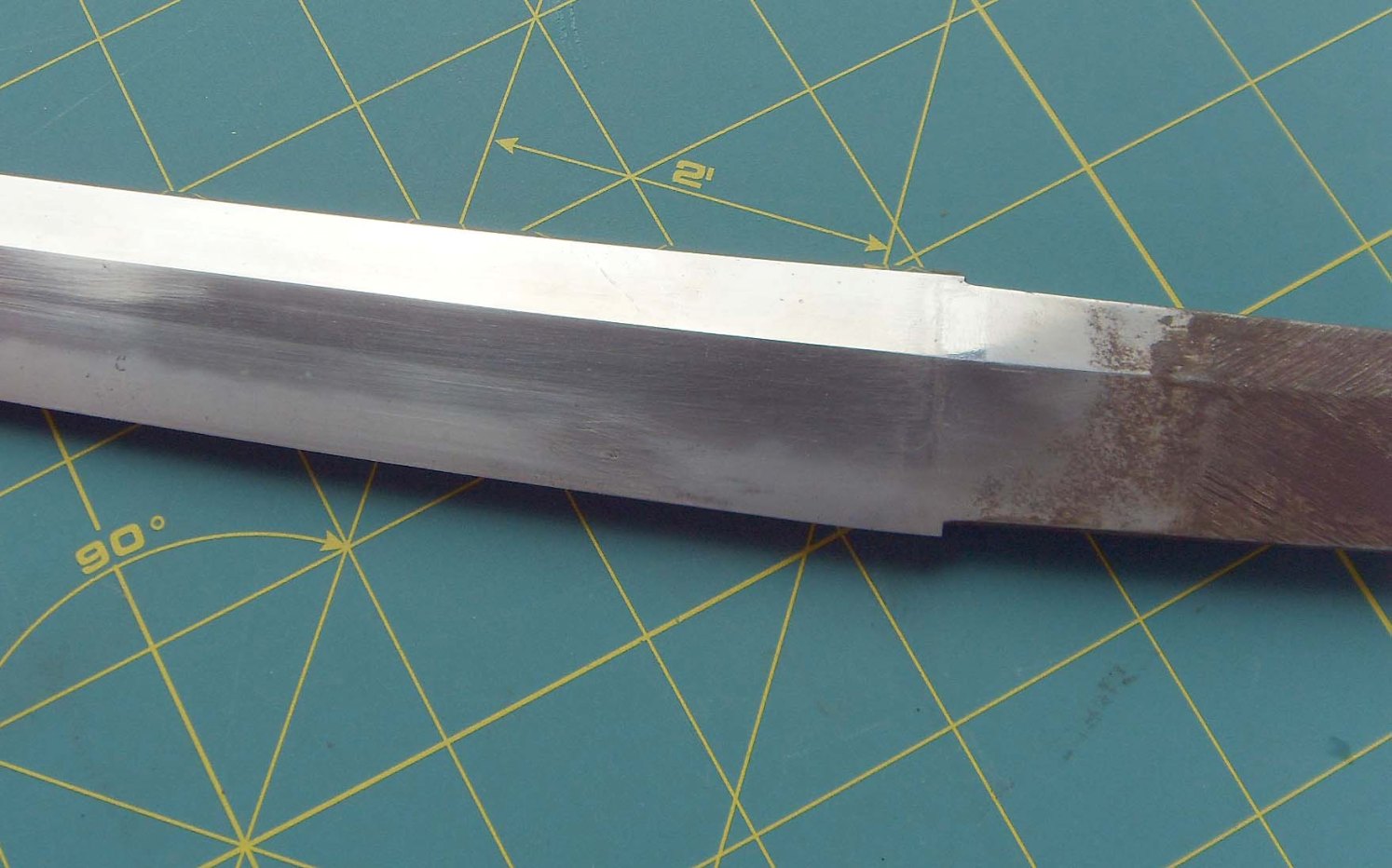

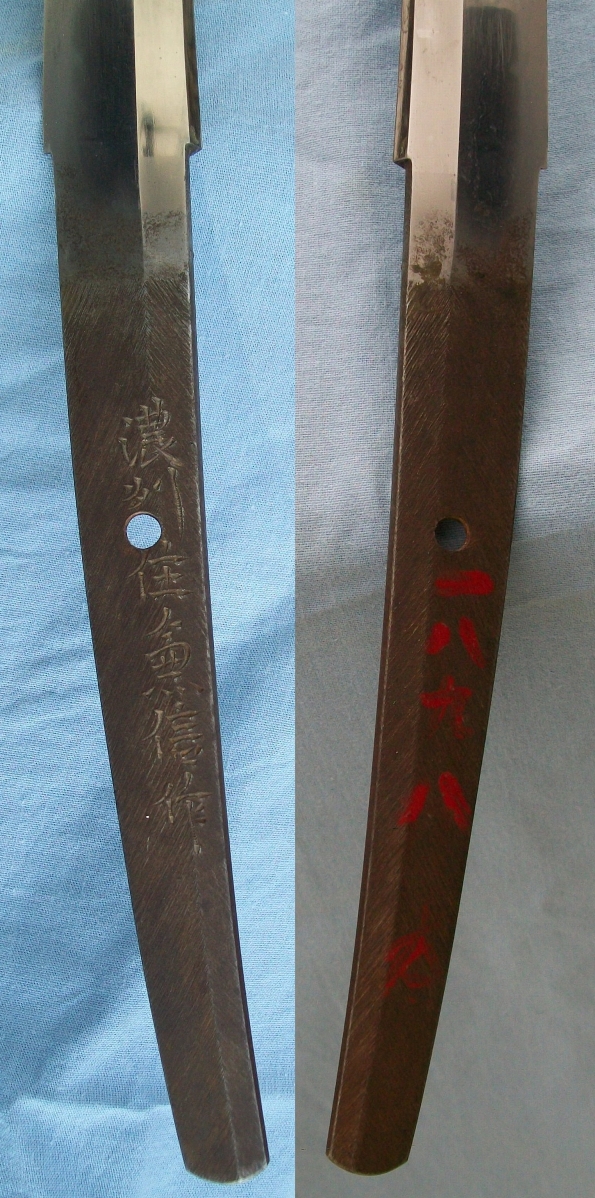

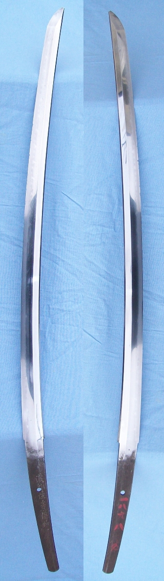

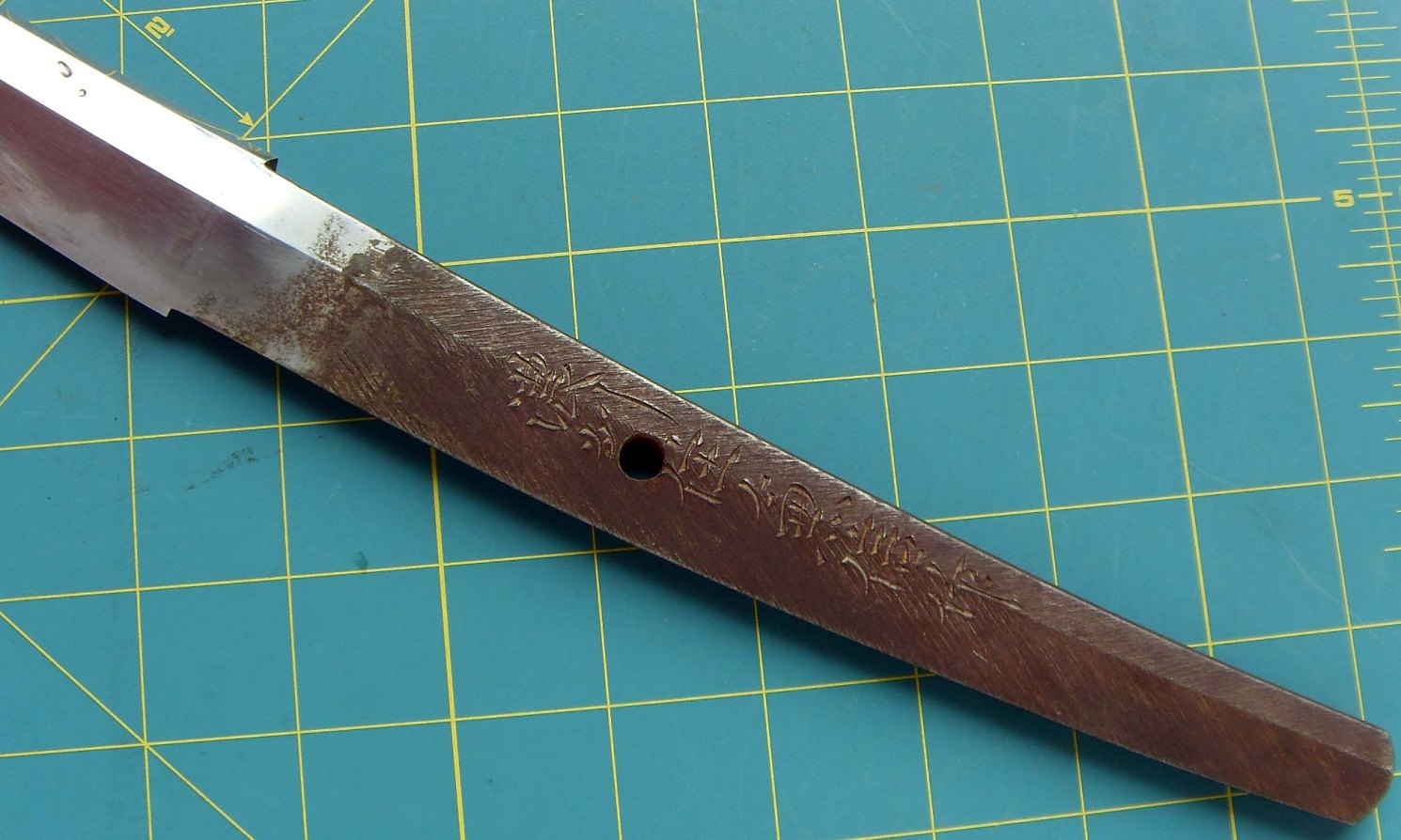

I want to ask you for help and advice. I got the sword with this signature. It is in gunto koshirae. Sword is most likely from the ww2 period. On the sword are no stamps (Showa, Seki etc.). Sword is not dated.
I read the signature as follow: "Noshu ju Kanenobu saku". But I do not know which Kanenobu it should be. If I'm right, Niwa Shuji Kanenobu use a different second character in his name (延). All swordsmiths named Kanenobu, who used the same character as is in the signature of my sword (信), are much older (koto, shinto).
Is it possible that Niwa Kanenobu used two forms of writing of his name? Or is it some other Kanenobu? Can someone help me? In advance thank you.

I agree, looks WWII. Nice signature and nakago finish and shape (much better than usual Seki WWII shape and finish).
This is (I feel confident) Niwa Kanenobu. The modern Seki line goes like this:
Kosaka? Kaneyoshi - 4 students
#3 was (this) Niwa Kanenobu - 17 students (2 he taught himself and 15 with teacher Watanabe Kanenaga)
#1 of the 2 "private" students was Niwa Kanenobu (the "other" nobu)...his son?
At first glance you seem to have the "father"...looks like a good sword.
Hope this helps.

No...the Kanenobu signature you show in the pic is the Father...Niwa Kanenobu
His 2nd son is Niwa Kanenobu (Shuji) shown in Slough p.54-5.

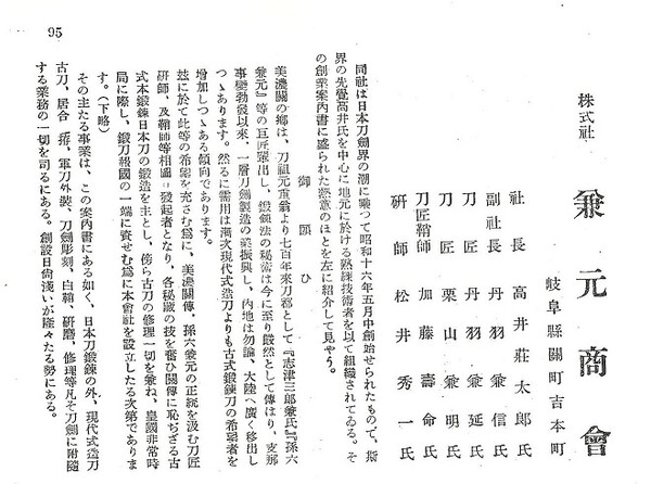

Here is a page from 1942 "Dai Nihon Token Shoko Meikan"
It is the info for the Kanemoto Co.Ltd. (Kanemoto Shokai, Seki Gifu..."Noshu"). This forge is run by Kaneko Kanemoto...1944 he is called 27 gen Magoroku Kanemoto I think....this Kanemoto is also a student of Watanabe Kanenaga (like Niwa Kanenobu the son).
The article lists the swordsmiths as (large print) Niwa Kanenobu (father) Niwa Kanenobu (son) Kuriyama Kaneaki, Kato Jumyo.
This means that both worked together at this sword forge.
Download the page for your file.

the information about the 2 kanji for "nobu" comes from Japanese records. You can see the two ways of writing the kanji for "nobu" in the page I posted from 1942. Both father and son were alive then...the journalist who wrote that page would have just spoken to both of them and asked them their names/kanji.

NO. Kanenobu father used the "nobu" kanji on your sword.
son used a completely different kanji for "nobu"...look again at your sword and at the 2 "nobu" kanji on the 1942 page.

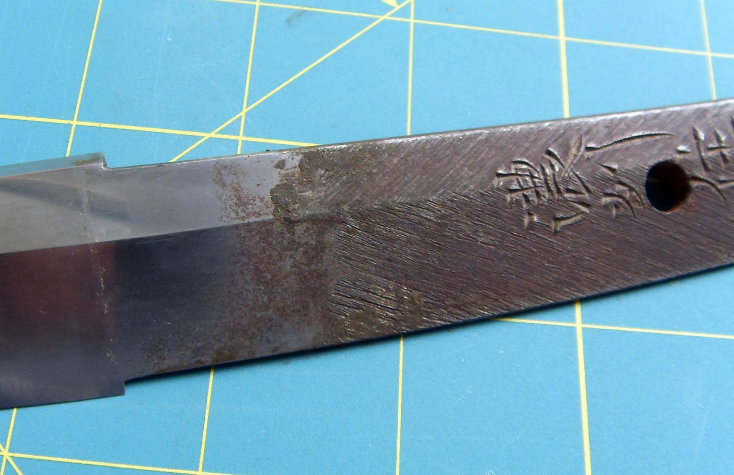

If Petr's sword is by the father, Niwa Kanenobu must have copied his mei style pretty close. This sword almost looks like it was signed by the same hand as a Niwa Kanenobu tachi I own. The "No" in Noshu is not as precisely carved but everything else is almost a perfect match...
It would be nice to see an example of the fathers work... Petr, do you have any pics of your sword.

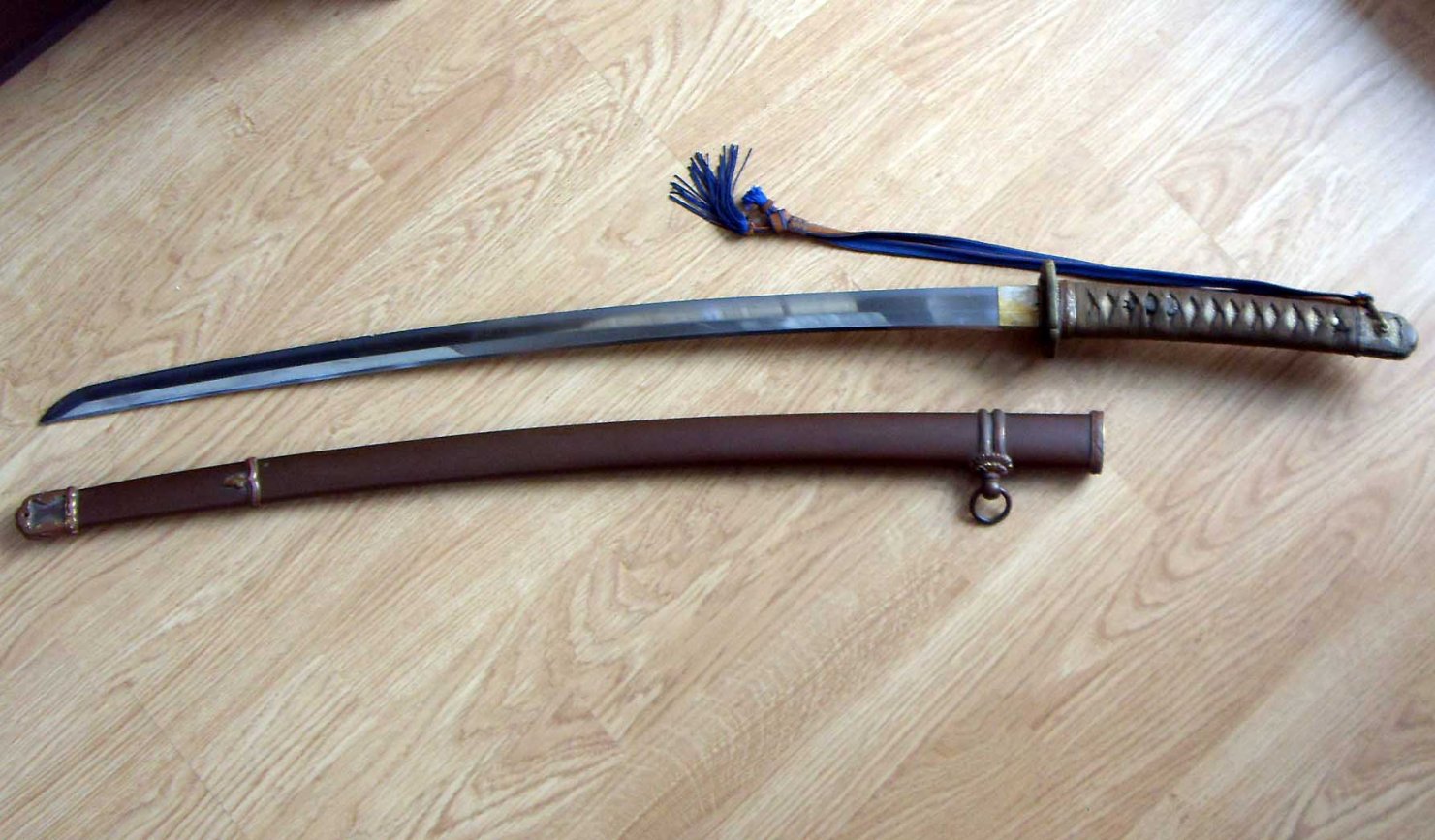

So now I got my new sword ...

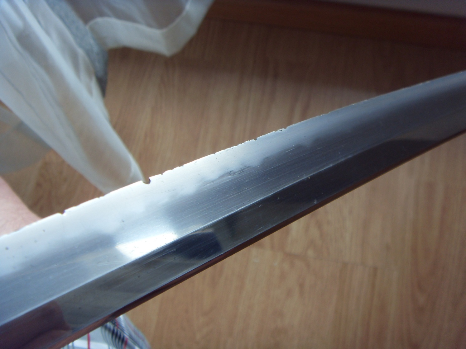

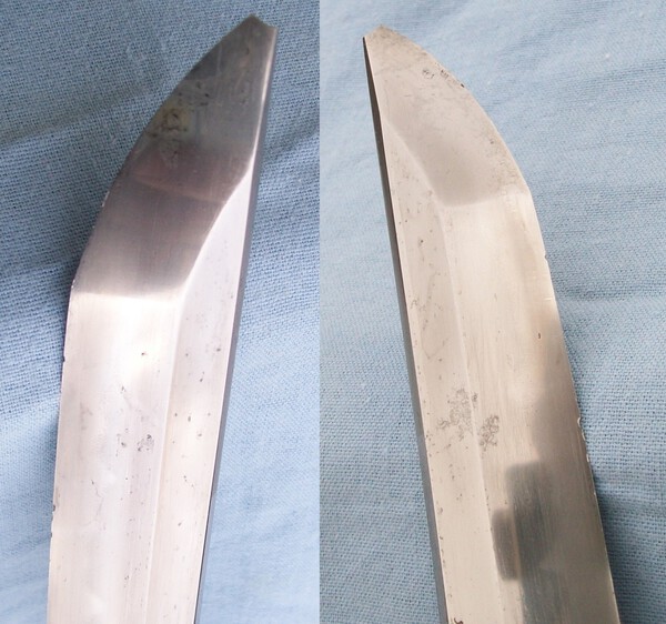

First impression: the sword definitely is not in the best condition, original wartime polish is dead, on the edge is a lot of nicks - and especially missing big piece of the tip of kissaki (likely work of some modern "samurais" who cut off completely anything ... :bang: ).
On the other hand I like the overall shape of this blade - much finer than on most Seki blades from ww2 period.

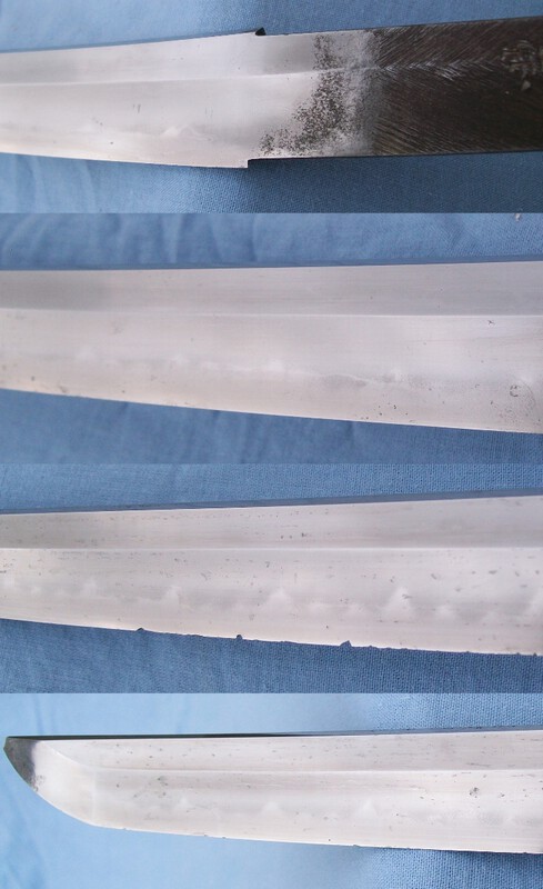

I tried to take a picture of the sword as best I could. I apologize for the quality of images. I'm not a studio photographer (definitely) ...
Appears to me to be clearly the work of the father, Niwa Kanenobu. He was a good smith (there, I admitted it, there were good smiths in Seki). His mei is nicely cut. The nakago is mediocre but it was war time.
Yes, unfortunately it is pretty rough. It could be repaired by a competent togi, but it would be expensive and probably not worth it.

The Kanenobu I have, has a Nakago Jiri like the one in the photo Chris posted. As I said earlier, the Kanji Nobu is different ( same as Niwa). The Nakago Jiri in the Photo Petr Supplied, is like the Oshigata I've seen by Niwa :dunno: Also, I was under the impression, that Kanenobu senr. died before the war :?: It is very hard to find records of Kanenobu senr.

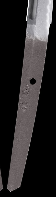

Further to our recent discussions - in the archive JapaneseSword.com I found a sword by Niwa Kanenobu father. Mei is almost identical and also the shape of the nakago. Although the sword bears the stamp Showa, the seller called it gendaito. And indeed - the blade has by water tempered hamon and seems also hada ... Very interesting sword.
http://www.japanesesword.com/Images/Swords/08/608/608KAT7/608KAT7.htm
