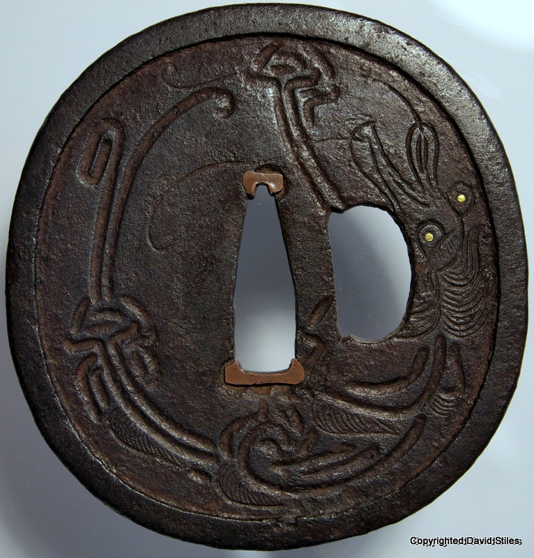

Soshin Posted April 8, 2013 Author Report Posted April 8, 2013 Hi Everyone, Just wanted to update this topic before I when on my honeymoon with some additional information and new photographs of the tsuba after I have cleaned off some of the rust and dirt using some small pieces old ivory, dried bamboo, and a white cotton rag. The lighting on these photographs are much better then the originals. I heard back from two experienced collectors that I sent photographs to of this tsuba to and they both are thinking Shimizu-Jingo school of Higo Province circa the early part of the Edo Period. One agreed with Pete K. that this would be a very interesting tsuba for NBTHK shinsa. Right now I withholding judgement on this tsuba and will try to submit it for NBTHK shinsa later this year maybe June or August depending on my finances after my long visit to Japan. Quote
Henry Wilson Posted April 8, 2013 Report Posted April 8, 2013 Well done, they are nice pictures David. Have a nice honeymoon. Quote
Pete Klein Posted April 8, 2013 Report Posted April 8, 2013 Please be aware there is no NBTHK August shinsa. After June the next is October for fittings. Quote
Soshin Posted April 8, 2013 Author Report Posted April 8, 2013 Hi Pete K. and Henry W., Thanks for the replies and the helpful information in regards to August which is the yearly special Juyo shinsa if my memory is correct. This requires tokobetsu hozon to be even allowed to submit to the Juyo shinsa. I know not to be in such big hurry when it comes to NBTHK shinsa submittals anyway. Yours truly, David Stiles Quote
Soshin Posted April 9, 2013 Author Report Posted April 9, 2013 Hi Pete K., Well so much for my memory... Setting in the airport now looking forward to visiting the NBTHK on Friday. :D Yours truly, David Stiles Quote

Marius Posted April 10, 2013 Report Posted April 10, 2013 Excelllent write-up about dragons, Henry Thanks for posting it, I have saved it as reference. As for the tsuba - I love it. The design is bold, the patina looks good. What puzzles me - why does the obverse and reverse side have an identical design? This makes me think Namban. An excellent piece, both for study and for its aesthetics. Quote
Henry Wilson Posted April 10, 2013 Report Posted April 10, 2013 Hi Mariusz Thanks for the kind words. The dragon is a common motif so felt it was worthy of a bit of research. Quote
Pete Klein Posted April 10, 2013 Report Posted April 10, 2013 My thinking has also been toward Nanban Mariusz. I am having some difficulty understanding where the Shimizu call is coming from which is why I mentioned earlier that shinsa might be a good idea. I simply do not see anything Shimizu in it. Quote

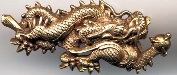

Brian Posted April 10, 2013 Report Posted April 10, 2013 Same dragon as the one pictured here I think....end of the tail is a giveaway. http://www.ebay.com/itm/Japanese-Sword- ... 1e7975cfed Brian Quote

Soshin Posted April 26, 2013 Author Report Posted April 26, 2013 Hi Everyone, Just wanted to add a bit of mud to a already unclean attribution with this tsuba. I found this very similar tsuba listed as Nanban but I think it might be Jingo: http://www.shibuiswords.com/NambanGallery.htm. Keeping in mind that I am not a expert and I am going to submit my tsuba as soon as possible to NBTHK shinsa. The tsuba I am taking about is the 11th from the top. Notice the very similar design along the dote-mimi style rim. On a related note here is what I found about the Rain Dragon design in The Art Appreciation of Japanese Sword Fittings by Shigeo Fukushi. Quote It was believed that the Rain Dragon ("Ama Ryu") was the bringer of rain and good opportunity. The Rain Dragon is often regraded as an Immature Child Dragon ("Mizuchi Ryu"). When the time has come, it ascends into the sky and it transforms into a matured dragon with horns and scales. These features made the Dragon a symbol of a successful leap and it was often used as the symbol of Emperor. Yours truly, David Stiles Quote
Soshin Posted May 13, 2013 Author Report Posted May 13, 2013 Hi Everyone, Just wanted to quickly update everyone about this tsuba. I have sent it to Bob Benson and he will be hand carrying it to the June NBTHK tosogu shinsa. I will update everyone once I have the results with a new topic referencing this original tread. Bob's impressions on seeing my tsuba was that is was from Higo Province. Yours truly, David Stiles Quote

Soshin Posted February 27, 2014 Author Report Posted February 27, 2014 Hi Everyone, Received the news late yesterday from Bob Benson about my tsuba. The attribution of my nice tsuba went to Higo. I am happy with the results. Any more details if any will come when I get the paper and the tsuba back. Feel free to discuss. Quote
John A Stuart Posted February 27, 2014 Report Posted February 27, 2014 That's it, Higo. A little bit narrower of an attribution would have been nice, or some commentary added. John Quote
Soshin Posted February 27, 2014 Author Report Posted February 27, 2014 John A Stuart said: That's it, Higo. A little bit narrower of an attribution would have been nice, or some commentary added. John Hi John, I agree some commentary and some more detail information would have been helpful. Upon reading some of Ito's sensei book on the Hirata and Jingo schools (thanks Pete K. for selling me the book) I feel the tsuba doesn't completely fit the work of Jingo school. But there is a few features that do remind me of the early work of the Jingo school. Quote
Winchester Posted April 15, 2024 Report Posted April 15, 2024 Hi David, I understand this is an older post, but I may have some feedback (my opinion after studying) that may be of interest. I believe your tsuba was made as an homage--so-to-speak--of the style from the Kamakura period. I believe it is also mid-to-late Edo; further, any tsuba of this design are not common. Someone mentioned the design being the same on the reverse--this was true with earlier examples, as well. The example that Christian M. posted with 'flames' or 'spikes' is also, perhaps more so, rare. I believe the dimensions of the tsuba, along with the execution of design, give insight as to an early piece or a 'revival' piece. Hope this may be of interest and helps. Quote
