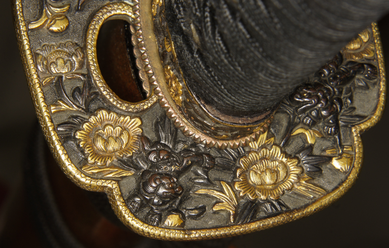

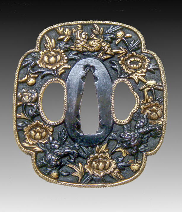

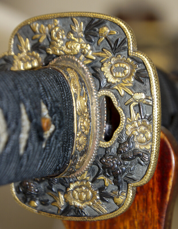

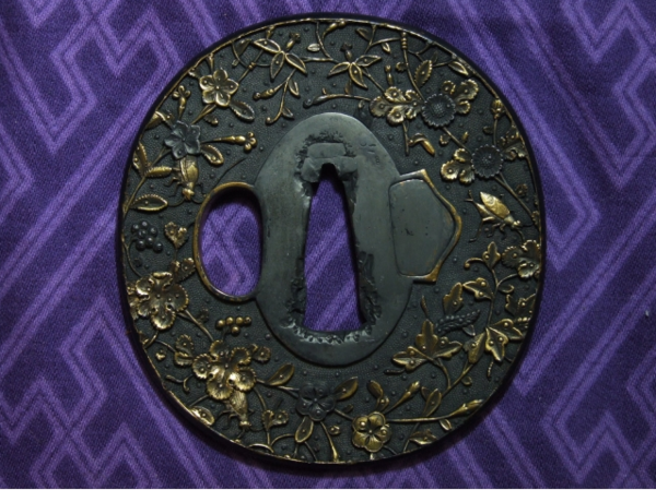

CSM101 Posted January 28, 2013 Report Posted January 28, 2013 Last weekend I visited a friend and he showed me his newest sword. It is just a piece of steel (gimei) but the koshirae is very nice. We discussed it and he thinks, this is Goto. For me, it looks more like Higo Kinko. But in the end, we will be both wrong. Because we both have no knowledge about kodogu. And so,maybe it is just GoTo-hell-with-that-crap. I post here the photos and I hope someone can tell me, what it is and why it is, what it is. I will just post the tsuba, If you need more photos, please, let me know. Thank you Uwe G. Quote
Brian Posted January 28, 2013 Report Posted January 28, 2013 Which is certainly not real Goto. Brian Quote

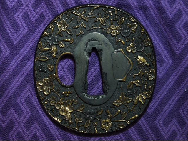

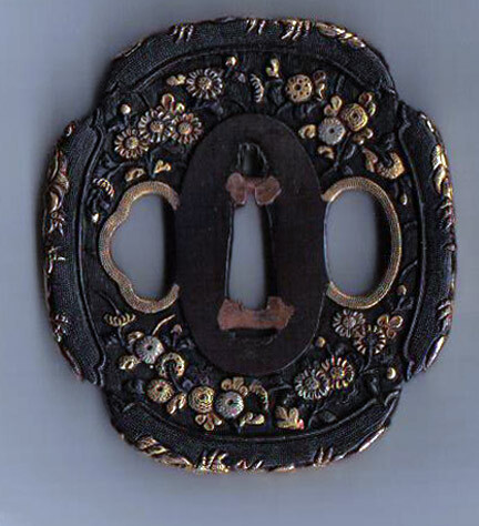

NihontoEurope Posted January 28, 2013 Report Posted January 28, 2013 Jean, Thanks - I don't enjoy whiskey, but I got the point ( : I did search for "Goto Tsuba" and obviously many results. Checking the images I found one Tsuba that I recognised from my collection. Is this a Mino-Goto or a "real"? [attachment=0]products_1154_1_medium.jpg[/attachment] I will try to find some more info. /Martin Quote
Jean Posted January 28, 2013 Report Posted January 28, 2013 Neither schools. A good overview of what tsuba schools look like http://www.arco-iris.com/George/tsuba.htm Ko-Mino http://tsuruginoya.com/mn1_3/b00071.html Goto http://tsuruginoya.com/mn1_3/f00187.html Look at the difference in the nanako Quote
NihontoEurope Posted January 28, 2013 Report Posted January 28, 2013 Jean, Thank you. The Acro-Iris page was excellent for me. A few schools I can detect easy, but this was an eye opener. /Martin Quote

docliss Posted January 29, 2013 Report Posted January 29, 2013 I too am surprised that Thierry’s Mino Goto attribution has not been questioned. In my opinion, the lack of delicacy; the absence of a nanako-ji;and the lack of depth of the decoration all preclude such an attribution. These observations, together with the crude, gilded mimi and ryō-hitsu surrounds, are indicative of Nagoya-mono rather than Mino Goto work. I am sure that, if we could see the seppa-dai, this tsuba would be seen to not be of shakudō. John L. Quote
John A Stuart Posted January 29, 2013 Report Posted January 29, 2013 I have a fondness for Goto and Minobori and also would be inclined to slot this as shiremono/hamamono. It just hasn't got that quality of the real deal. John Quote
Jean Posted January 31, 2013 Report Posted January 31, 2013 http://www.aoijapan.com/tsuba-mumeiunsigned-mino-school Quote
CSM101 Posted February 1, 2013 Author Report Posted February 1, 2013 So, here is another photo of the tsuba and I hope that Mino-Goto is still a possibility. Uwe G. Quote
christianmalterre Posted February 2, 2013 Report Posted February 2, 2013 concerning an ranging to an specific school i rather tend to say no classical Kinko at all-rather an latter Shoami school piece. relating it´s age i tend to say late to very late Edo. Sorry-there´s already an real Mino Goto piece shown here by Pete-and in browsing,you may find plenty of others by picture... Do compare workmanship and you will very soon see the differences... (But hey-we do have an Kinko-Front "league" of collectors here-it´s up to us "Sukashi"-Front guys so to answer here?)(?) Christian Quote
Brian Posted February 2, 2013 Report Posted February 2, 2013 No..I don't think so..missing the nananko and I don't think that is shakudo. But a call for Mino Goto wouldn't be preferable anyways in this particular case..it's not a better call than Hamamono and Mino Goto really doesn't have anything to do with true Goto, although as Pete showed there are some very nice Mino Goto examples. Brian Quote
docliss Posted February 2, 2013 Report Posted February 2, 2013 There appears to be a general consensus that Uwe’s tsuba is not Mino Goto. I know of no example of this group that possesses a heavy, gilt-nanako decoration of the mimi and/or the ryō-hitsu, and there is no such tsuba illustrated in the Gifu Museum of History catalogue, Kinko Mino Chō (1993). This is a flashy, late Edo innovation, appealing to Western tastes. John L. Quote

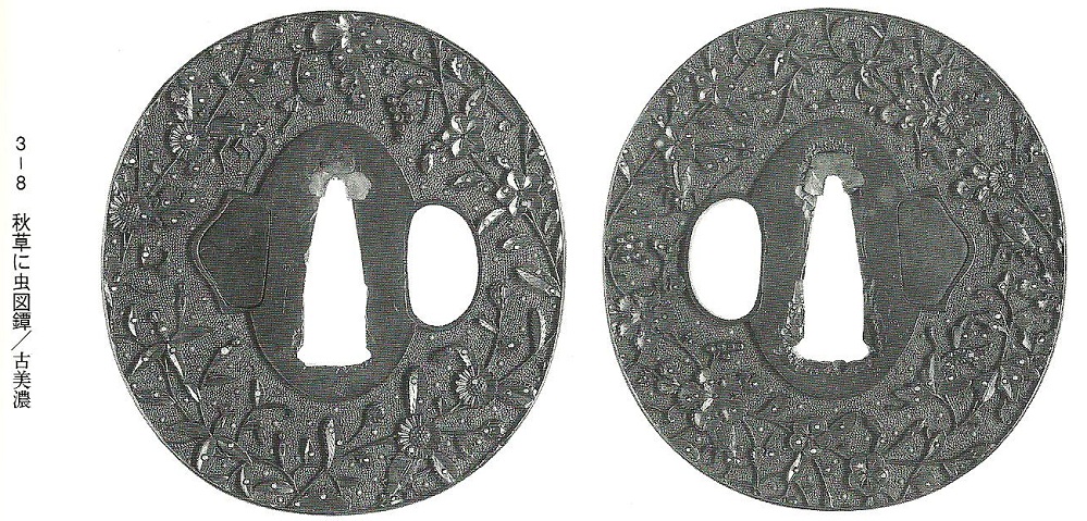

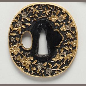

Pete Klein Posted February 2, 2013 Report Posted February 2, 2013 How about this one then: It's in the Gifu book John mentioned, pg. 30, middle: Oh, and BTW, here's the link to the Bonham's one above: http://www.bonhams.com/auctions/16717/lot/334/ Better picture as you can magnify it. Quote

John A Stuart Posted February 2, 2013 Report Posted February 2, 2013 Here is my Mino tsuba mounted on a koshirae ensuite with Mino fittings. It is well made, but, not of Momoyama age, rather Edo period. John BTW, The OP tsuba shows a slightly related stylisation related to what we see with Minobori and never minding the quality, but, keeping it in mind I have yet to see a Mino-bori treatment of botan and shishi within the school. J Here is one for sale by Aoi-Art http://www.aoijapan.com/tsuba-mumeiunsigned-mino-school Quote
