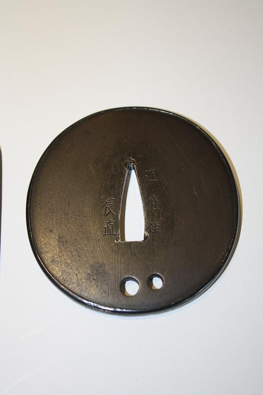

I would like some translation assistance please and some comment on if we think these guys are the same person - who perhaps changed his name at some point, or is a relative (father, son, etc.) of the other. The kanji look very similar and the nakago ana have similar characteristics. I don't have any reference material on this guy(s), so any assistance would be appreciated.
I cannot make out the last Kanji on my tsuba.. is it Nao? I think it reads Kofu Ju (Edo) Naganao..?? Is that correct?

江府住辰直 kofu (no) ju Tatsu-nao
江府住辰壽 Kofu (no) ju Tatsu-toshi
Tatsunao is a son of Tatsutoshi.
Edo (Tokyo) Bakumatsu.
Both signatures are good.
Very much appreciated. I also had Tatsu (as well as Cho & Chou); however, I was sure it was Naga. Very many thanks for your assistance. I actually have two Tsuba by Tatsunao. I unfortunately missed out on the Tsuba by his father. Nevermind..
This has helped me out a lot. Very many thanks.

Hi,
Here are some photos of my two Tatsunao Tsuba as requested. Both are tetsu, but the larger (77.5 mm H x 74.7 mm W x 5.7 mm T) is mokume with a Shakudo Fukurin. The wak size is 71 mm H x 68.5 mm W x 5.3 mm T. Both Tsuba taper slightly to the Mimi, so the (thickness) measurements are taken at the Seppa dia.
Thank you for the info and help. It was much appreciated.
Barrie.
Hi lance,
Nice Tsuba. Tetsu as well I see.. I haven't seen any soft metal tsuba from him yet, but I guess now that I have looked into him, I may see one eventually..
Thanks for posting.
