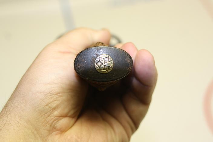

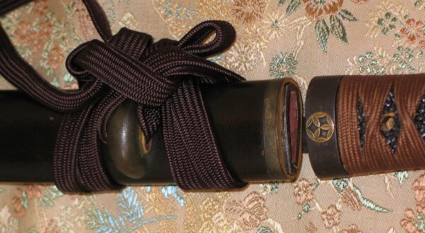

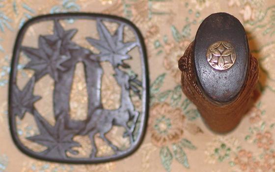

bmoore1322 Posted November 23, 2012 Report Posted November 23, 2012 Okay this Mon / Crest is on my favorite Nihonto in my collection right now, I'm not bringing up the subject matter of the sword, but I need to know if anyone has any idea how to identify the Mon / Crest on my sword. It is on my sword in two places, if I can identify the family of it, it would help me with the research of this Nihonto. Seems to be fashioned in Bamboo leaves. thank you Brian Quote
drbvac Posted November 24, 2012 Report Posted November 24, 2012 Looks a bit like Takanaka? http://www.otomiya.com/kamon/plant/sasa.htm Quote
bmoore1322 Posted November 24, 2012 Author Report Posted November 24, 2012 Yes, it does. Here is what I found, thanks for helping me, would this have been owned by an Samurai, and not an merchant. http://en.m.wikipedia.org/wiki/Takenaka_clan Brian Quote
Brian Posted November 24, 2012 Report Posted November 24, 2012 Mon mean very little as the Edo period went by. Almost anyone could adopt any mon they liked...by the Meiji period, there is little correlation between a mon and who used it. It's not a family indicator that can be traced to people like we expect. Brian Quote
bmoore1322 Posted November 24, 2012 Author Report Posted November 24, 2012 Okay, thanks Brian, I understand. But this one does seem to be able to be traced back, Now that I have a name to go with this particular crest. I'm trying to do as much research as possible on this Nihonto. Brian Quote
Brian Posted November 24, 2012 Report Posted November 24, 2012 Brian, How do you have a name? You have a mon that was originally for a family/clan way back when. However in later times, by which times your fittings had been changed numerous times...almost anyone could adopt that mon, and put it on anything they liked. So it is very unlikely your sword was carried by anyone from a Takanaka clan. There is no research that you can do to get back to an owner..it could have been anyone with even a passing link to an old family. Basically, unless you have a documented sword with original fittings that is probably a Koto and has paperwork showing who passed it down to who over the years..there is nothing a mon is going to tell you. It is a misconception that a sword with mon will tell you who owned it. Brian Quote
bmoore1322 Posted November 24, 2012 Author Report Posted November 24, 2012 It's more info then what I had before, and happy to have that now. I have a name of the family that used the Mon is what I meant. Thanks Brian Quote
KORSH Posted November 24, 2012 Report Posted November 24, 2012 Hi Brian, what the (other) Brian is trying to say, is that during that last 200 years, almost every Japanese family has adopted a mon. If you see a mon for example originally used by the takanaka clan, today or by the time your nihonto was mounted, this mon could been used by someone who has nothing to do with the takanaka clan and who carries a different name (Yamamoto, Kato, Ikarashi etc.). Knowing the name of the mon is a good thing, but unfortunately it will not help you on your research. Quote

ROKUJURO Posted November 24, 2012 Report Posted November 24, 2012 tony edmunds said: ...Does Brian's undoubtedly correct argument in relation to Edo/Meiji mon also apply to the mon we see on Gunto fittings? I'm thinking about those mounts attributed to known military officers with the family mon. ...... It may be of some interest that I tried to trace back a GUNTO in very well preserved mounts, containing a 55 cm BUNGO blade in acceptable condition. The KASHIRA had a silver FUJI MON (Wisteria), and I asked the NBTHK for help (back in 1985 or so). I told them I was prepared to hand the blade back to the family. Their reply was that unless there was a tag with a familiy name and troop unit attached to the blade it would be impossible to find out the former owner or family as the MON was so widespread in use. Quote
Toryu2020 Posted November 25, 2012 Report Posted November 25, 2012 My little handbook of Japanese mon lists no less than 96 families that used this mon in the Edo period, the Takenaka being the most famous, it notes that more than 200 families (they mean families that count) used variations of the take mon during the more two hundred years of Tokugawa rule. If you have an object with more than one mon on it, it may be possible to connect it to a particular generation of a particular family as the main house, the mothers house and the particular generation could be represented by mon. For this you need a copy of the Taisei Bukan which is a who's who of Edo-jidai Japan... -t Quote
bmoore1322 Posted November 25, 2012 Author Report Posted November 25, 2012 @ Thomas, thank you for the info. I'll try and find that book. My Nihonto does have two mon on it. Brian Quote
ROKUJURO Posted November 25, 2012 Report Posted November 25, 2012 Brian, I am sure Thomas was referring to two different MON which then would allow to specify a family branch of a clan. Quote
