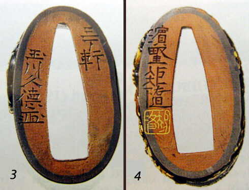

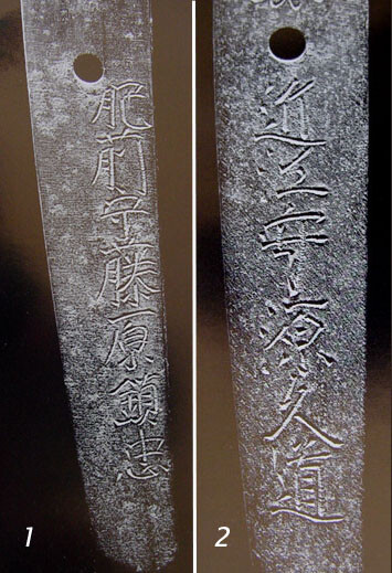

Ok all, as requested I am giving the translation conundrum a go. This is just a trial to see if it is successful. All that is required is to have a go at the translations of the following 4 mei. I have used fittings as well as sword mei to give it some variety. Some of these are fairly basic, while others will require a bit more work.
They are taken from old catalogs..so no points for finding the catalog and posting the translation from there :D
No prizes for correct answers..but a good chance to test your knowledge and learn a bit. I hope the listed answers are correct, please let me know if there are any mistakes.
I'll give it until Monday before giving the answers. Please don't post your guesses in this thread to give others a chance to have a go. You can pm or email me your answers, and I'll post the results when the answers are given, or just check the answers against your work. Please note that I won't have time to reply to pm's to tell you if you are correct or have a mistake, so your pm is your final answer unless followed up by another :)
Suggestions and comments are welcome. Feel free to ask for hints or advice..but I can't guarantee any :D
Have fun, and good luck.
Regards,
Brian
Edit to add: You don't have to have a go at all 4. Just do the ones you feel comfortable with if you prefer.
Ok..so here are the results of the first conundrum....
I hope many of you were keeping answers to yourselves, as I only had 3 attempts sent to me. Slow start, but we will give it another try in a while and see how it goes. These ones ranged from pretty easy to really difficult. Just a trial, and next time I will sort them a bit better and make them a bit easier.
Thanks to those that gave them a try, I hope they were educational.
1 - Hizen (no) Kuni Fujiwara Shizutada (could be read as shigetada too)
2 - Omi (no) kami Minamoto Hisamichi
3 - San no Ken TamaGawa Hisanori (kao) (various readings and I'll avoid ones like these next time. San tei ken could be a reading too)
4 - Hamano NoriYuki (kao)
Full points to Koichi Moriyama. SteveR tried the sword mei, and got both correct.
Simon got 3 out of 4. Well done guys.
A good result all who attempted them. Please let me know if you have any comments for the next one.
Regards,
Brian
