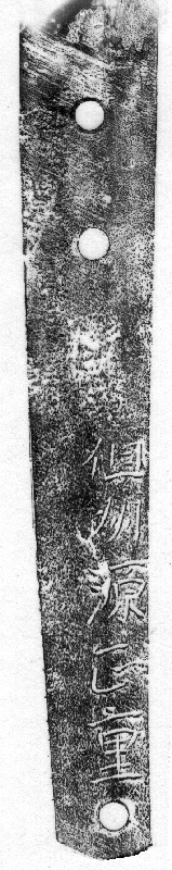

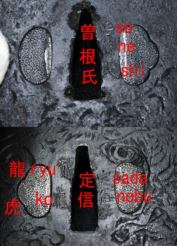

Jorgensen Posted November 13, 2012 Report Posted November 13, 2012 Hello collectors, I would like to show you this large o'kissaki Katana with swastika kamon on f/k and appreciate some help and info too. Blade mei I get to: Tanshu Minamoto Masashige, but I cant find anything on this smith. Info and if possible an Oshigata will be very helpful. The Tsuba signature I cant read, its too hard for me to read, I am not that skilled in reading kanji. There is kanji on both sides. There is kanji on the seppas as well. Any info and help will be much appreciated. Link to pictures: BLADE: http://reklamezonen.dk/katana_blade.html KOSHIRAE: http://reklamezonen.dk/katana_koshirae.html Here are the different measures: BLADE: Nagasa: 77,6 cm Sori: 1.8 cm Motohaba: 38 mm Motogasane: 8,5 mm Kissaki: 10,5 cm Weight: 1238 grams (without habaki) TSUBA: Width: 9,5 cm Height: 8,5 cm Thickness: 5 mm Weight: 256 grams Koshirae total lenght: 109 cm Koshirae + blade total weight: 1626 grams Quote
John A Stuart Posted November 13, 2012 Report Posted November 13, 2012 May I suggest shinshinto Hoki, signed 伯州原正重 Hakushu Hara? Masashige. Don't get the hara, wara kanji. I know it does seem more like 但州 Tanshu; but.... John Quote
cabowen Posted November 13, 2012 Report Posted November 13, 2012 John A Stuart said: May I suggest shinshinto Hoki, signed 伯州原正重 Hakushu Hara? Masashige. Don't get the hara, wara kanji. I know it does seem more like 但州 Tanshu; but.... John 源 minamoto Quote
John A Stuart Posted November 13, 2012 Report Posted November 13, 2012 Should have figured that out, duh. Thanks, Chris. Can't find anything on this smith using Tanshu either, which seems to be what that kanji is, more and more as I look at it. Oh well. John Quote
cabowen Posted November 13, 2012 Report Posted November 13, 2012 Soshu ju Minamoto Masashige 祖州住源正重 Quote

John A Stuart Posted November 14, 2012 Report Posted November 14, 2012 That Nihonto Meikan entry has 相州住正重 with no 源 and using 相 rather than 祖 Also signing 武州下原正重 Bushu Shitahara Masashige. Listed as Tensho 天正1573.7.28-1592.12.8 not Tenbun. I am still unsure though. John Quote

Jorgensen Posted November 18, 2012 Author Report Posted November 18, 2012 Just an update for those who are interested - facts revealed in my search about the sword so far: SIGNATURE IS: Tanshu Minamoto Masashige. KAMON ON F/K: Family crest by the HACHISUKA daimyo. MENUKI STRANGE PLACEMENT: Special order or because not to cover the 2 mekugi ana. Menuki are 8 cm long each. SEPPA'S: Kanji reads Nakayama. Has no further importance. TSUBA DETAILS: "Sone-shi” (to Mr. Sone) on the obverse side. “Sadanobu” and “ryu-ko” (dragon and tiger) on the reverse. Sadanobu may be the name who engraved on the tsuba, and the “ryu-ko” is a title of the engraving. Probably the person named Sadanobu made the engraving as a present to Mr. Sone. BLADE: Blade is a Katana (and not a nagamaki-Naoshi - J Reid is correct (I will let you know as the first in case of sale )). Probably gimei and probably cut down (is believed to originally have been somewhat over 80 cm's long). It is believed so far by a highly regarding polisher the sword might could turn out to be a Tanshu Hojoji Kunimitsu (1300 cth). I am suggested it is then a very good sword to submit it to Juto Shinsa. I will probably have the blade sent to the polisher and then if okay, submitted to Shinsa. Its going to be very interesting to see what will happen in future and what it turns out to be. Quote
Markus Posted November 18, 2012 Report Posted November 18, 2012 I am pretty sure that the mei reads "Tanshû Minamoto Masashige". This makes him a meikan-more, a smith who didn´t make it into the meikan lists. There is clearly the ninben (亻) to the left and the (旦) radical to the right. Quote
cabowen Posted November 18, 2012 Report Posted November 18, 2012 Markus said: I am pretty sure that the mei reads "Tanshû Minamoto Masashige".This makes him a meikan-more, a smith who didn´t make it into the meikan lists. There is clearly the ninben (亻) to the left and the (旦) radical to the right. Looking at the linked photos of the mei, I completely agree and having looked in the Meikan, he is indeed Meikan-more. Or, the signature is gimei.... Quote

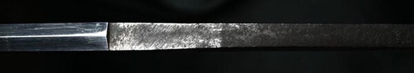

Kai-Gunto Posted November 25, 2012 Report Posted November 25, 2012 Here a better picture with it ,compared with standard size katana. Quote

Toryu2020 Posted November 25, 2012 Report Posted November 25, 2012 I want to ask, is this not a gendai work? Are we maybe looking in the wrong place for this smith? The depth of the ha-machi especially makes me wonder. 龍虎 BTW is the theme of the tsuba - dragon on one side and tiger on the other... -t Quote
Kai-Gunto Posted November 26, 2012 Report Posted November 26, 2012 About the tsuba , yes, tiger on one side and dragon on the other. Quote

runagmc Posted February 11, 2013 Report Posted February 11, 2013 An older sword would usually show less thickness in the mune, compared to the nakago mune, due to the number of polishes it would've likely received... In other words, you can tell this sword has seen very little polishing and is probably not so old... Quote

cabowen Posted February 12, 2013 Report Posted February 12, 2013 There were many swords made in this style in the Shinshinto period. WWII era blades, certainly not. Modern shinsakuto, again, many. Quote
drbvac Posted February 12, 2013 Report Posted February 12, 2013 Thank you Chris - I was pretty sure that later gendaito were never this large. Quote
Ruben Posted February 12, 2013 Report Posted February 12, 2013 just the ha- machi and mune- machi were moved, so the ha- machi is to brought i think. But realy don´t now about era, but if it is not "very" old should be ubu, ...no? About sugata, hmm could be shortened also On the other side the nakago is not too bad shaped, it looks ok so far. Ps.: the fuchi dont fit, hard to find some over 39mm, had this doruble as well :| Greetings! ruben Quote
