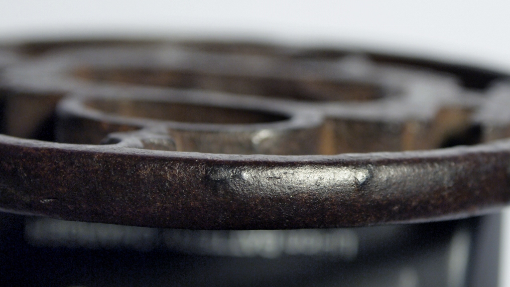

Soshin Posted November 12, 2012 Report Posted November 12, 2012 Hi Everyone, A friend of mine and long time collector of Nihonto and Tosogu wanted me to take and post on the NMB some nice photographs and a description of this tsuba that he let me borrow for awhile to study. I will begin with some basic information and some nice detail photographs of the plate and rim. I will then follow with my own kantei of the tsuba. Your own analysis, feedback, and opinions about the tsuba are always welcome. The tsuba has not been papered by any organization. Thank you. Basic Information tem Name: Wild Geese and Pine Trees Japanese Title: 雁に松地透 図鍔 (kari ni matsu ji-sukashi zu tsuba) Material: Iron (tetsu 鉄) Size: 7.0 X 7.0 cm, 5.5 mm at the rim Signature: mumei (無銘) Shape: Maru-gata (丸形) Openings: Ryohitsu ana (両櫃孔) Surface Finish: Tsuchime-ji (槌目地) Attachment: None General Observations Along the rim of the tsuba has many large granular iron bones (tekkotsu). The rim has a rounded square shape (kaku-mimi koniku). Overall the tsuba was a bit over cleaned by the previous owner before my friend specifically along the inside surfaces of the sukashi. It also has a few places where the patina is thin but overall not that bad. Yours truly, David Stiles Quote
Soshin Posted November 12, 2012 Author Report Posted November 12, 2012 Hi Everyone, Here is my kantei attempt at the tsuba. To me it looks like a classic Kanayama tsuba from Owari Province of the Azuchi-Momoyama Period (1568 – 1615) (安土桃山時代). The small size, great thickness, many granular iron bones, hammer marked surface, and the rounded square shaped rim when but together all in a single tsuba with a some what abstract ji-sukashi design is characteristic of Kanayama craftsmanship. Yours truly, David Stiles Quote

kunitaro Posted November 12, 2012 Report Posted November 12, 2012 Sure it is Kanayama tsuba. Beautiful jitetsu and tekkotsu. The design reminds me "a cross". We see sometime kind of cross design in old kanayama or ko-shoami tsuba. I think it is possible before prohivited Christianity in Japan. between 1550-1600.... Quote
Soshin Posted November 12, 2012 Author Report Posted November 12, 2012 David you are a funny guy! (why "informal" Kantei?-why do you post pictures which already bear an "name" on bottom,and why do you give an "call" immediadely after? Can you but tell me why it may not even be an Ko-Shoami?(LOL!) Christian Hi Christian, I call it a informal kantei as the tsuba is not papered by a recognized organization and any judgement right or wrong is just my educated opinion as a collector. Yes you might be right about the calling it immediately after posting the tsuba I likely should have waited a bit. In regards to your second question I have never examine any Ko-Shoami tsuba with this many large granular iron bones. Generally they are much fewer and smaller in size on Ko-Shoami tsuba. Also the thickness in relation to overall size of tsuba isn't often seen in Ko-Shoami tsuba as well. Hi Kunitaro-san, You bring up an important kantei point about the jitetsu which is also characteristic of Kanayama craftsmanship. Typically the jitetsu of Ko-Shoami is more of a dark brownish black in color while the jitetsu of Kanayama tsuba are a dark brownish blue in color. In terms of the design at the top and bottom it could be a cross or some other design of European influence. Thanks for everyone's interest in the tsuba. Yours truly, David Stiles Quote

Curran Posted November 15, 2012 Report Posted November 15, 2012 Lovely tsuba. It would have been exactly my cup of tea a few years ago. David's was almost certainly a "Kaneyama" a bit heavy on the Owari feel, but I think it should be classified as one of the late Momoyama - Very Earliest Edo Kaneyama that enjoyed a period of en vogue. The carbon nodules are almost too prominent little heads and have sort of been shaved around or finessed to be highlighted so clearly. Everything else looks right. Now the funny thing is that the NBTHK, depending on the year such tsuba go to shinsa, will sometimes give these late momoyama - earliest Edo examples calls to Kaneyama, Ono, Owari and Shoami, in basically that order of frequency. I've seen one tsuba that got "Shoami" and the owner said it was an idiot call, then waited a few years and sent it back. Second time it got "Kaneyama". I've seen both sets of Hozon papers. With these momoyama-earliest Edo ones, don't be too overconfident that it will paper Kaneyama. NBTHK seems to like to give the sharp stick to the eye on people papering these about 30-40% of the time. Quote
