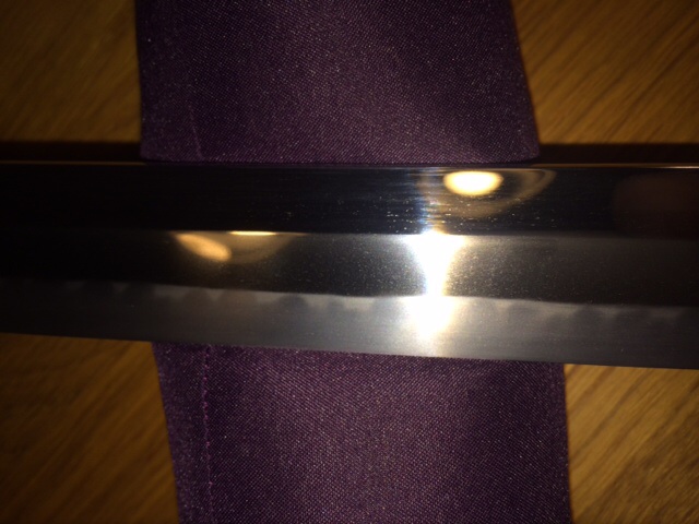

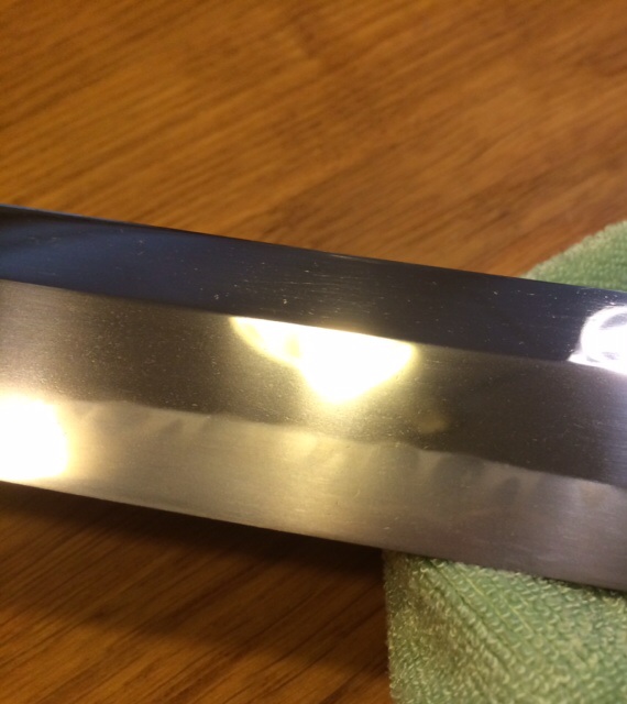

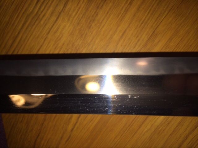

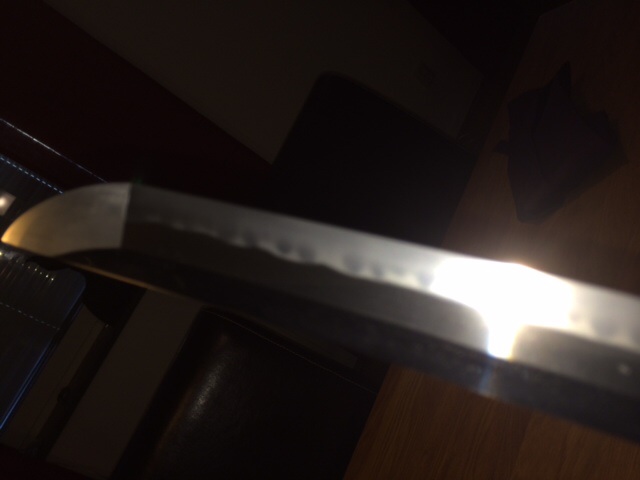

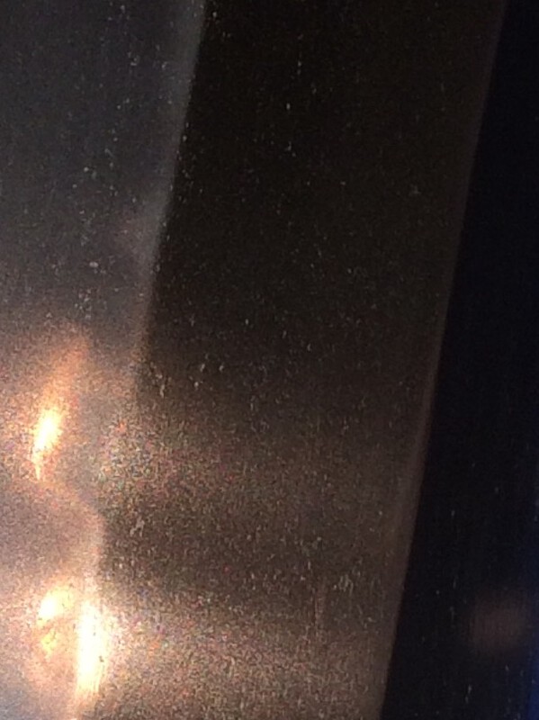

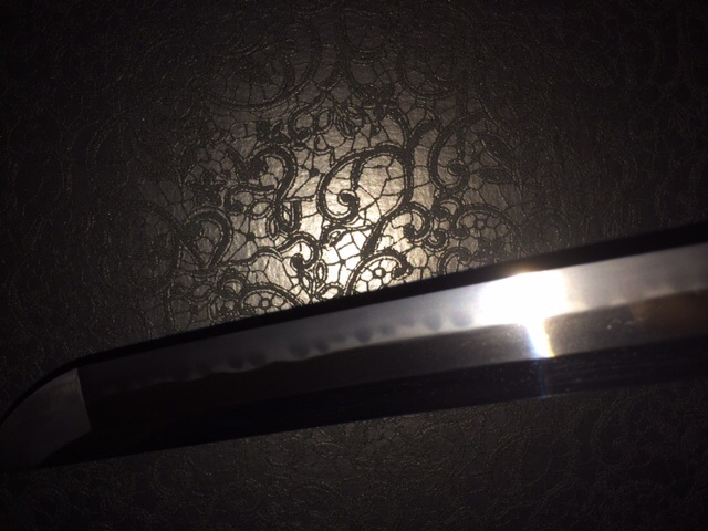

Ok, I gave it a new try this morning. I have a real hard time capturing those deep ashi. Please bear in mind these are all photos taken by my iPhone since I don't have a good camera yet. Anyway I hope they are at least somewhat less worse.
Best Regards
Daniel
If you are going to collect swords, you need to buy a camera folks. You cannot rely on cellphones, and with the price of decent little point and shoot cameras, there is no excuse.
Can see the hada in some pics, but most of the details are hidden by the photos I suspect (not by the polish)
Brian
Thanks for the photos...
As I recall, Kunitaro san was offering different levels of polish; which level of polish did you select?
Thanks again.
Thank you for posting photos, Daniel san,
Good sword with cheap camera is better than a cheap sword with good camera !
Chris san, Yes, It is Standard polish,
The most of swords are good enough with our standard polish,
I offer master polish only the master think that it is worth to take time by himself with his old Jizuya,Hazuya stones, some old sword needs to be re-shape properly,,, some old high quality sword with a bit weak hamon,or needs sensible work,

At last my four year old son is sleeping upstairs and I finally had the time to really study the blade and the polish. I feel my lousy pics made Kunitaro san's great service an even greater disservice. I want to point out even though the Hada is a very tight Ko Itame it is brought out and easily seen in reality and the Kesho follows the original Hamon in a nice and natural way. I wouldn't hesitate using his sevice's again. Also this has been another step for me in the learning curve. It is very satisfactory to have restored a blade to it's glory, all financial aspects aside ;-)

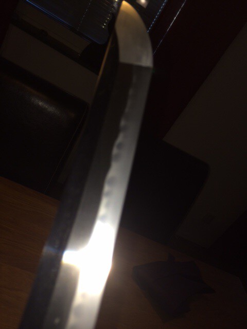

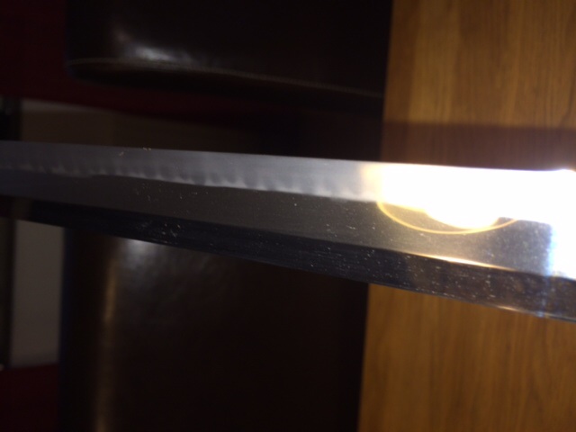

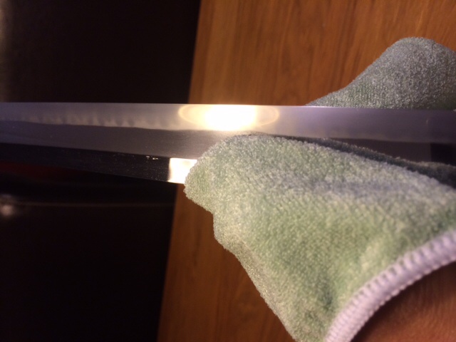

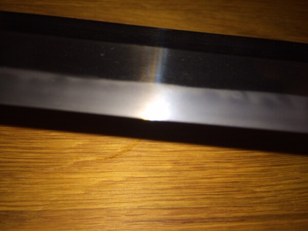

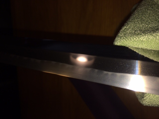

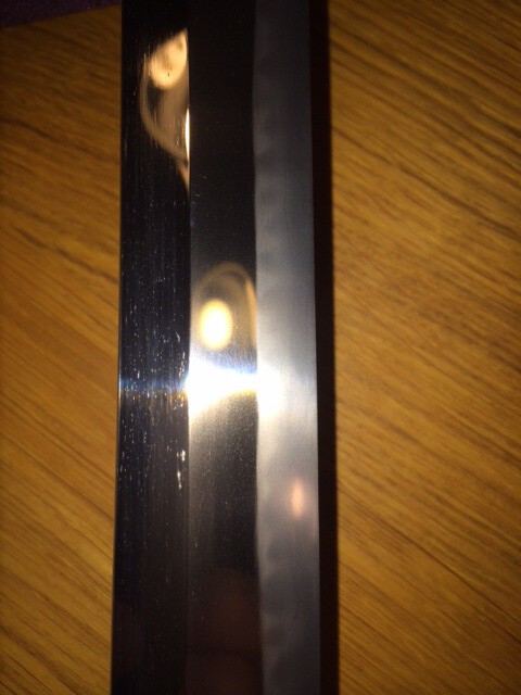

If somebody's still interested I had the blade out for cleaning during the weekend and took a few shots. Still a lousy photographer with the same iPhone ;-)
Well anyway I think you can see the Hada is a very tight ko-itame.
The blade look a lot better in hand and under the right light it really sparkles.
Regards
Daniel
Thank you Stephen for your advice and comments.
I was hoping the new pics along with the previously posted would give an idea of the sword. I normally read this forum and post pics from my phone but viewing the pics at work from a computer I have to admit they are huge. Also as I'm sure many of you are aware of, some swords are a joy to photograph and some are impossible to capture. This blade I'm afraid is the latter. However as said before it's beautiful in hand.
Regards
Daniel
