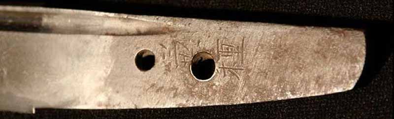

Lee Bray Posted October 30, 2012 Report Posted October 30, 2012 Hi Geraint. There are pics of the mei and papers somewhere on this board if you do a search. The blade is dated to 1663 and part of the mei says roku dai, or sixth generation, yet the nidai worked in that time period and the 6th worked in 1740's. Because of the time difference, I sent hi-res pics of the mei and date to a couple of dealer associates in Japan and both thought it gimei. Good questions regarding the reasoning behind the gimei/papers. I've never understood it myself. Quote

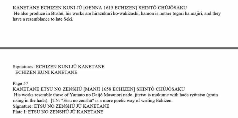

Eric H Posted October 31, 2012 Report Posted October 31, 2012 Toranba was invented first by Tsuda Sukehiro II. The hamon by Kanetane I is described as to be „notare togari ha maijiri with a resemblance to late Seki“... and from another source „notare mixed with gunome choji or also a hiro-suguha“ Eric Quote
