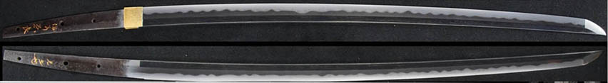

Drago Posted October 23, 2012 Report Posted October 23, 2012 Hi, I'd like to point you to this Aoi-Art auction: http://www.aoi-art.com/auction/en/aucti ... 1213703271 (I thought about uploading the picture but didn't know about rights and stuff. If one of the admins knows if it is okay to upload the picture...) What happened to this sword? The bo-hi runs on the shinogi for most of the blade and only runs above it at the tip. The tip of the bo-hi is very close to the kissaki. And at one point there seems to have been a second hi below the bo-hi that has been lost to polishing or perhaps it was just a short one. Does it just look so odd because the blade is tired? Was the bo-hi cut later without caring for the shinogi? Or what? I'd be happy if you could explain. Thanks. Quote
Jean Posted October 23, 2012 Report Posted October 23, 2012 And you Tobias, what is your opinion or hypothesis, you must certainly have one? Quote
Drago Posted October 23, 2012 Author Report Posted October 23, 2012 :D Well, I'm a beginner. So I asked because I'm not sure. My guess would be: The bo-hi was cut later and/or not that professionally, the second hi was only one of those short ones (don't know the term). And the blade is polished down so much that the tip of the bo-hi has gotten that close to the kissaki. Quote
Jean Posted October 23, 2012 Report Posted October 23, 2012 My guess: the small one is original to the blade. The bo hi may have been added later to try to hide the shinogi ware. The kissaki has probably been reshaped. The blade has suffered from too many polishes. Quote
zatoichi Posted October 24, 2012 Report Posted October 24, 2012 jean, some questions , only because I do not know. would they except a blade for tokubetsu hozon that was so badly damaged from polishing? This sword has the hi going through the nakago so it is probably a cut down tachi, do you think the hi proximity to the fukura of the kissaki is due to the tip braking and the kissaki being remade vs a cover up? Your saying the blade has been over polished is this due to the hi kissaki relationship or is there something else you are seeing in the blade? If so what are these things? Your help would be much appreciated. I am sure you have heard all these questions before. J edwards Quote
nagamaki - Franco Posted October 24, 2012 Report Posted October 24, 2012 First, this sword is O suriage as stated in the description. The bo hi and soe bi look to be original and in fact the bo hi runs off the nakago on the ura side, and on the omote you can even see evidence of the soe bi having been longer once upon a time, too. The kissaki has obviously been reshaped most likely from a broken tip as evidenced by the boshi, plus the ending of the bo hi in relationship to the koshinogisaki. This sword has seen its share of polishes/repairs. Quote

micha Posted October 27, 2012 Report Posted October 27, 2012 Hi, Some pictures of my Kencho (Kanenaga). Micha Quote
