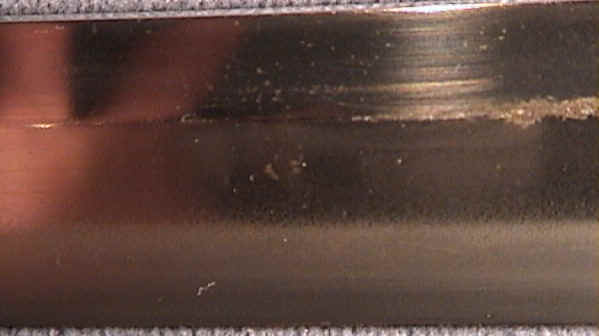

Which blade(s) are showa-to? ANSWERS HERE NOW
Here is a little game called "spot the showa-to". Who wants to play? Just have a look and identify the blades that you think are showa-to, if any. Maybe our showa-to expert Jacques will play too!
Showa-to is a rather loosely used term for any non-traditionally made blade made during WWII. Usually they are made of western steel and oil quenched. There aren't any water quenched, western steel blades, and few if any oil quenched tamahagane blade. Some western steel blades were partially forged, but these are rather rare, as are other varieties, like the Mantetsu, etc. For this, just identify anything you think is non-traditionally made...
This will be a fantastic learning tool for those less experienced such as myself so could members please elaborate as to what it is that they see and base their opinions.
Thank you.
Regards,
Stu

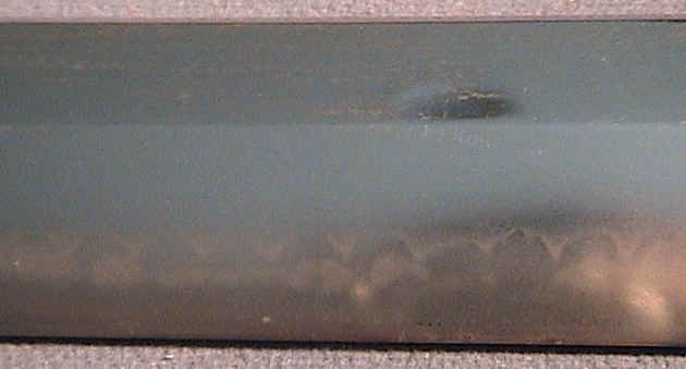

I'll say maybe 2 and 7 (koa-isshin? or I'm wrong and one or both are Yasukuni) and definitely number 9 (Seki). Should be fun even if incorrect.. Due to the limited pictures it might be more fair to say "X" out of 11 pics is a Showato? :dunno:

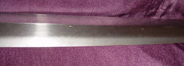

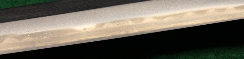

this is not my area of greatest comfort, but to play the game, my guess..... 5,6, 8,9,10. are showato

I am also inclined to believe they are all Showa-to
If I had to say 5 and 8 do not seem to show nie (in the images) and so may be made in the era but not with 100% traditional materials or production.

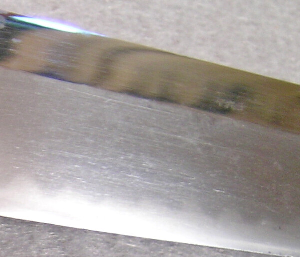

Using the non traditonally made definition of Showato I would go for nos 4 5 8 and 9 as being Showato
Like Tom I think they are were all made in the Showa period.

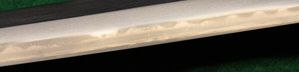

The other swords exhibit either a lot of nie or a more complex nioi with a lot of activity within the hamon.
Although sword 4 shows odd patches of nie it appear accidental rather than intended. I saw something similar on a blade that was attributed as oil quenched in an NTHK shinsa.
5, 8 and 9 show little life in the hamon and not much going on in the hada.
Having said all the above I believe it is difficult enough making these judgements sword in hand. doing it from a partial image increases the challenge considerably so I am far from confident in my choices.

Well back to reality...a couple of pics make it hard to see , but going mainly on hada being present and hamon nie and ko-nie, my previous experience would say to me that all are nihonto except possibly # 5 and #9. (Edit to correct: I meant... I meant #8).

I am going to make a fool out of myself but never mind: 1,5,6,10 are showato.
Edit: by 10 I mean 10.jpg = 9 by number.
Veli

I would say 9 and 5. After that, I am hesitant in also including 4 and 8...with 1 as a last possibility.

1,4,5,8,9,10 maybe.. Sometimes showato look like they have hamon and hada, but really its just the oil hamon and ji natural pattern under lighting.

Showa era blades include 1, 3, 4, 5, 6, and 10
Non-Showa-to are 2, 11, and 8
In the "No clue category", I'd put 7 and 9.
