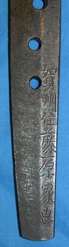

Cuirassier Posted October 10, 2012 Report Posted October 10, 2012 Hi Guys I bought this not bad at all thank you wakizashi for a good low price; the blade is really not bad at all. It was one at one of those live auctions, where the item was badly described with quay spulling meerstakes, so udders did not see a waki in amongst other things where it really should not have been. Saw it and quickly bid, and got it; thought "God, what have I just done" but now am pretty glad I did buy it. Anyway So then I came to the mei. I thought I had this one beaten, but no! I tend to find the smith's name OK, one way or another, and then use some detective work to work out the rest (have books, have Internet). This one has me beat though. First, there was no "saku" character at the end, so I looked at the last two characters hoping this was the name. I got the second to last as "Iye" but that did not work when I tried to find a smith's name beginning with "Iye", and the last character I can not work out. So went with forth and third from last, and got Fujiwara; I am right, aren't I? Please tell me it is Fujiwara! So I found three Fujiwara's, but this is not any of them. So I thought "OK, look up the province. Should be easy enough, the "shu" character is there", right? So I think I found the character, number 70 of Robinson's "The Arts of the Japanese Sword" This character can be found in the provinces "Iga" and "Kaga" but not where it is the lead character followed by "shu". I can not find the province but am convinced I have identified the charcter correctly. Please, please help. Images of the mei below. Insanity will come soon otherwise. Mark Quote
Mark Posted October 10, 2012 Report Posted October 10, 2012 KaShu Ju Fujiwara Iyetada Kaga province Quote

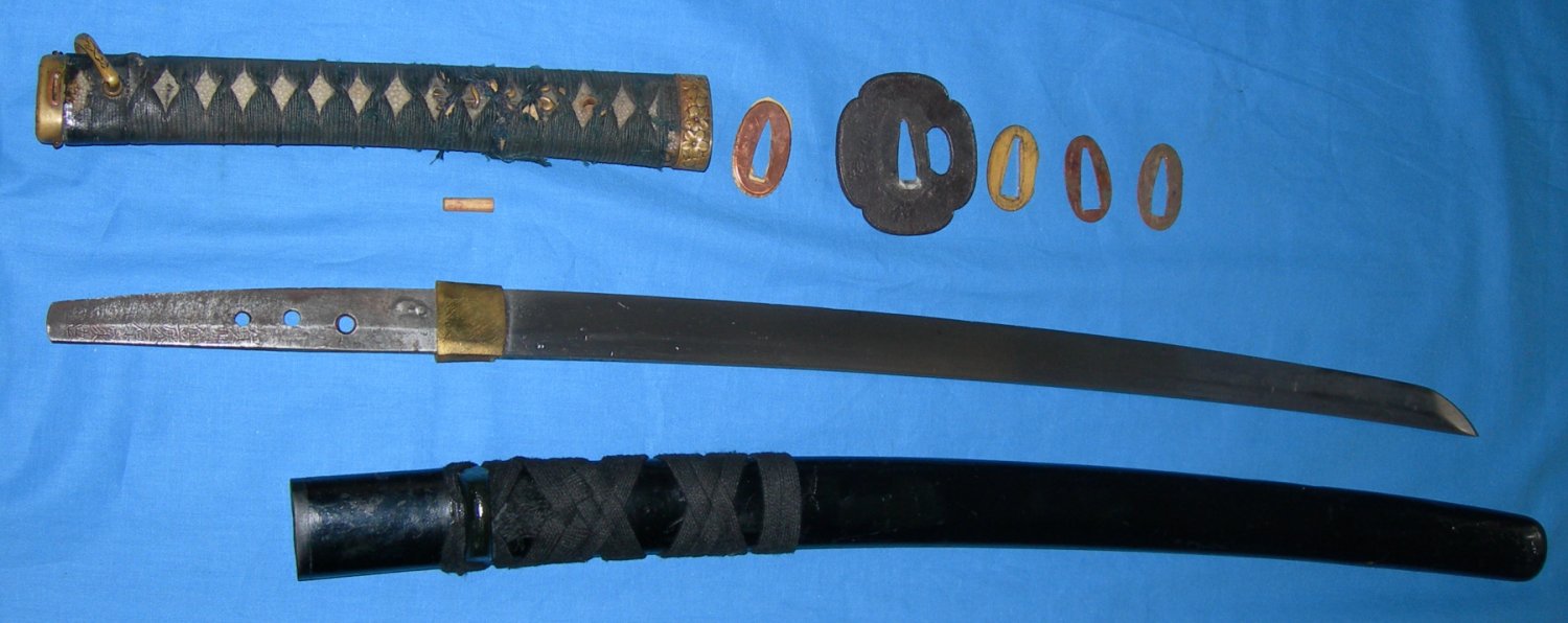

Geraint Posted October 10, 2012 Report Posted October 10, 2012 Which is a promising start so can we see some images of the rest, please? Quote
Toryu2020 Posted October 10, 2012 Report Posted October 10, 2012 Mark (Cuirassier) You shoulda stuck with this one, the characters are all clear and clearly defined. Any way you have your answer and indeed it looks to be a lucky find. I too would like to see more pictures... In regards to Fujiwara - so many smiths used the name you could hardly narrow down a search using that info. Now that you have your answer you should once again look at your references to compare what is on your sword with what you see in your books. -t Quote
Brian Posted October 10, 2012 Report Posted October 10, 2012 Fujiwara is not a name in this case, but an honorific title often used. Brian Quote

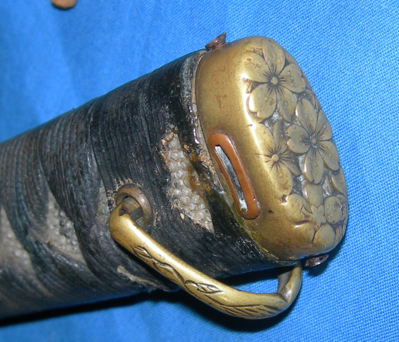

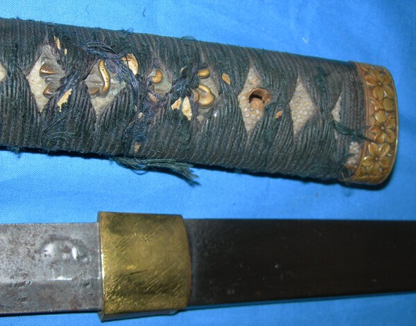

Cuirassier Posted October 11, 2012 Author Report Posted October 11, 2012 Thanks guys. Yes, maybe I should have stuck with it, as I had the key elements, but the trouble is I think my books. Certainly now the smith's name makes a lot more sense now I know Fujiwara is a title. As requested, extra photos, but I am not the world's best photographer for sure. The blade appears to be very well made; I am sure the fittings are early 20C Maybe it is worth me spending some money on a polish and refurbishment, maybe I will just sell it on for a quick profit As I said, I bought it as it flashed on my Internet bidding screen when I was not expecting to see an edged weapon; I was waiting for swords which were to come later in the sale. It just flashed up, I saw the cat scratch habaki, the asking price was low, I bid and got it ! Normally such impulsive buys burn my fingers, so I was due some good luck! Cheers again Mark PS If you ever need help with Napoleonic / 19C European swords, I may be your man! Quote
Jacques Posted October 11, 2012 Report Posted October 11, 2012 Hi, Brian said: Fujiwara is not a name in this case, but an honorific title often used. Brian Fujiwara, Taira, Tachibana, Minamoto and Sugarawa are not honorific titles but clan names. They were extensively used (mostly without any link with the real family). Quote
cabowen Posted October 11, 2012 Report Posted October 11, 2012 I believe the correct term is Sugawara 菅原。。。 Quote
Jacques Posted October 11, 2012 Report Posted October 11, 2012 Hi, cabowen said: I believe the correct term is Sugawara 菅原。。。 Yes, sometimes my fingers don't want to obey my brain Quote
