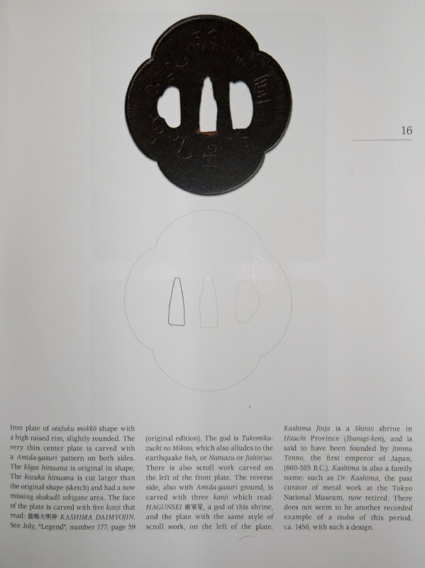

docliss Posted September 28, 2012 Report Posted September 28, 2012 I am re-reading Robert Haynes’ Study Collection of Japanese Sword Fittings, and I am once again intrigued by the drawings of #s 16 and 44, which show an original triangular shape to the hitsu-ana. Has any member, I wonder, ever seen a tsuba, – or an illustration of a tsuba – that demonstrates this feature? Not that I am questioning Haynes’ expertise in this matter…. John L. 1 Quote

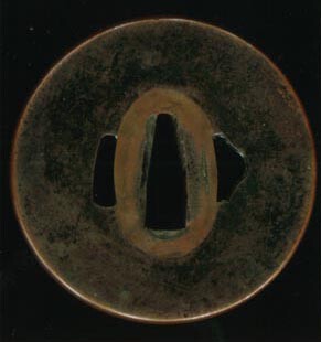

Thierry BERNARD Posted September 29, 2012 Report Posted September 29, 2012 here pictures of these tsuba! 1 Quote

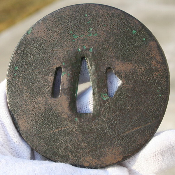

Marius Posted September 29, 2012 Report Posted September 29, 2012 Here is another tsuba with a similar hitsu ana. It is said to be a very early (Kamakura/Nambokucho) yamagane tsuba. Very narrow opening, though still not identical to the one Mr. Haynes has suggested... 1 Quote
Brian Posted September 29, 2012 Report Posted September 29, 2012 All of these are very interesting, but none of them are close to the shape that Haynes mentions in his writings. His "assumed" shape is almost like the nakago ana shape. I can't see where he would have gotten that belief from, you certainly cannot get that from the current altered shape. Brian Quote
Marius Posted September 29, 2012 Report Posted September 29, 2012 Brian, I think my tsuba has a kozuka-ana not very dissimilar to that Mr. Haynes has drawn. Granted, his is a bit more pointed, but otherwise.. Quote
