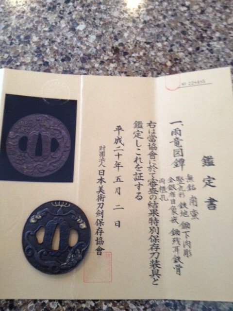

Fred Geyer Posted January 1, 2014 Report Posted January 1, 2014 Dave, You just need to keep looking as I have seen at least 7 Namban tsuba with Tokubetsu papers, will post a few for you today. Fred Geyer Quote

Fred Geyer Posted January 2, 2014 Report Posted January 2, 2014 This one has tokubetsu papers 2 1 Quote
Peter Bleed Posted January 2, 2014 Report Posted January 2, 2014 This thread just keeps getting better. I think there must have been international trade in Chinese sword fittings and related metal objects. But I bet that the makers of those things didn't care if their produce ended up in Japan or Tibet. In Japan, the imports had to be adjusted with ryo-hitsu etc which made them "Nanban." David's Hozon guard is one of those imports. I respect John's assessment of the age of that guard, but I would still like some hard evidence. But what about the difference between David Hozon tsuba and Fred's Tokubetsu Hozon pieces. Fred's guards are nice and the VOC auriculate guard is a classic. I believe, however, that both of Fred tsubas were made in Japan in a style that Edo period Japanese saw as "foreign". And I just suspect that is why they were considered "Special". Making an imported piece TBH might be difficult for a Shinsa team. Tampa will be great fun! Peter Quote
Soshin Posted January 2, 2014 Author Report Posted January 2, 2014 This thread just keeps getting better. David's Hozon guard is one of those imports. I respect John's assessment of the age of that guard, but I would still like some hard evidence. But what about the difference between David Hozon tsuba and Fred's Tokubetsu Hozon pieces. Fred's guards are nice and the VOC auriculate guard is a classic. I believe, however, that both of Fred tsubas were made in Japan in a style that Edo period Japanese saw as "foreign". And I just suspect that is why they were considered "Special". Making an imported piece TBH might be difficult for a Shinsa team. Hi Peter B., I agree with your observations that both of Fred's very nice tsuba where Edo Period products made by Japanese artisans in a "foreign" style. The first example likely dating from the time period the VOC was still trading in Japan between 1639 (founding of Dejima) to 1799 (bankruptcy of the VOC). The thinness of the ji(地) and the degree of change in thickness between the plate and rim edge is also not something commonly found in Edo Period tsuba. I began this topic by thinking my tsuba was a imported early Namban tsuba possibility from China or some where else along the Silk Road from the Muromachi Period when there was more direct trade between the Ming Dynasty of China and the Ashikaga Shogun of Japan. I have since came across a nice reference discussing the sword trade between Japan and China during this historical period: http://markussesko.wordpress.com/2013/11/01/Japanese-sword-trade-with-ming-china/. The similarities of design elements on my tsuba out side of the karakusa pattern to that of a Latin Cross used by Portuguese and Spanish traders and missionaries explains Skip's original notes about the design. Well right now I have more questions then answers and I am sure more will be raised when I get the hozon papers. :lol: Quote
