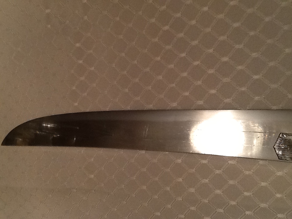

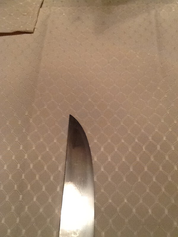

Prepeleac Posted September 23, 2012 Author Report Posted September 23, 2012 More pics...Sorry - this is the quality of the copy of the docs i received. However the tanto is superb.., Quote

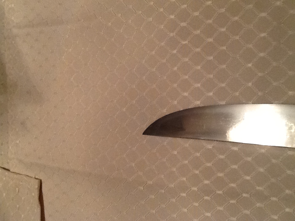

Prepeleac Posted September 23, 2012 Author Report Posted September 23, 2012 More pics... Chip C Quote
Prepeleac Posted September 23, 2012 Author Report Posted September 23, 2012 More... Chip C PS - Pics get rotated when posted... Quote
