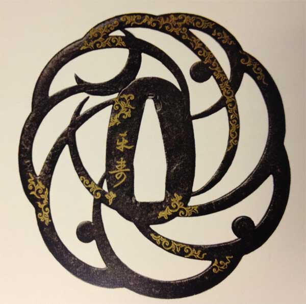

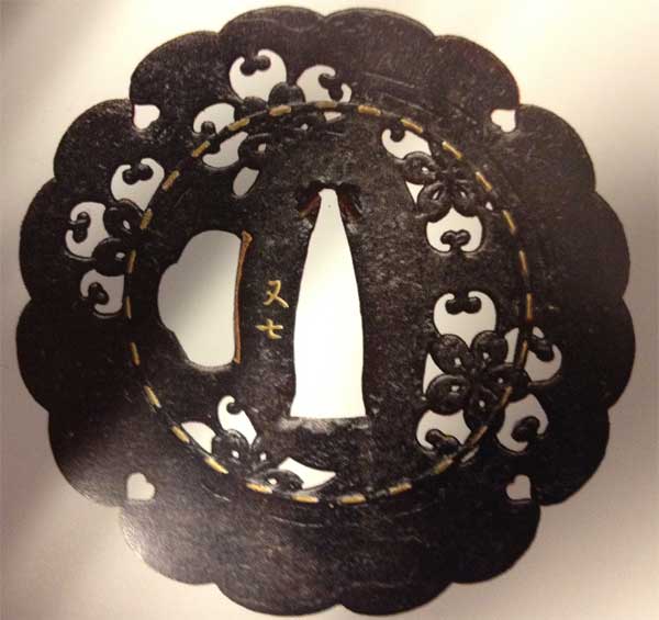

raiden Posted September 10, 2012 Report Posted September 10, 2012 I have recently seen a tsuba up for sale that screams to me work of a Nishigaki school artisan. I owned a near identical one years ago, papered to "Nishigaki" The one up for sale is unpapered. It has a kin zogan signature that I interpret to be an attribution. But the "signature" is to a Jingo artist. Does the NBTHK kill this one as gimei? ____Please, no debate about whether the mei is right or wrong____ To simplify the question: How does the NBTHK regard incorrect kin zogan attributions on tsuba ? ________Mr Curran wrote the above:_________ Unfortunately without seeing the tsuba in a clear fashion, it is difficult to see if there is an actual kinzogan mei or an attribution put there properly (not trying to be a fake signature). As far as Higo tsuba go, those that are serious students know tha there are examples seen by Matashichi and Rakuju with kinzogan signatures that are have been deemed genuine. However, in my experience, I have not seen any examples of Jingo, Nishigaki, Hirata, Suwa, Kumagai or Toyama.... that have kinzogan mei that have been deemed genuine by the NBTHK. But in my experience, usually the NBTHK will A). Paper the tsuba if they deem the kinzogan mei correct such as in the case of Hayashi Matashichi or Kamiyoshi Rakuju. B). Fail the piece if they feel it is not an appropriate signature or attribution not deemed genuine not from a recognized appraiser (such as in the case of swords - the Honnami family or in the case of soft metal, attributions from the Goto family) C). Declare the piece as a "Horyu" meaning they are not sure at the moment and the piece requires more further study before determining either way.( There is no charge if a "Horyu is issued) or in a rare case issue a verdict on the piece regardless of the gold inlayed signature, but adding the fact that this item has a type of gold signature on it but not verified by the NBTHK. ex: nishigaki -but, blah blah blah kinzogan mei ga aru. But my feeling is that IF this tsuba is a nishigaki piece, but has a Jingo Kin in mei, most likely it will not achieve Hozon, but without seeeing the piece, my opinion at this point is moot point. But the 2 schools worked very close to each other in both style and technique. Quote
raiden Posted September 10, 2012 Report Posted September 10, 2012 here are some famous examples that have been deemed genuine for many years. Quote

Curran Posted September 11, 2012 Author Report Posted September 11, 2012 Kinzogan to: Yatsuhiro ju Jingo + Kao or appraisor's mark. (Jingo: using the 五 character, sans "box" underneath) Signature or attribution? _______________________________________________________ "Mr. Mike", what's with the "Mr. Curran" ? We've dealt, or not dealt, with each other for at least ten years. At least since the front of the room Kariganeya Hikobei rant in San Fran. You're knowledge is appreciated in this matter. Yes, the kinzogan Hayashi where the mei matches the work is a classic. Rakuju seems to have been fond of the kinzogan mei. Several others about too. Have any kinzogan Shimizu-Jingo ones? I don't recall any off hand. Quote
raiden Posted September 11, 2012 Report Posted September 11, 2012 Curran, I am just teasing, as you did not say Hi to me at the last Tampa show! I have a question, is the kin mei on both sides of the seppa dai? remember we are flying blind here..... or is the attribution on the left with the kao on the rightside? Mike Quote
raiden Posted September 11, 2012 Report Posted September 11, 2012 oh, and as far as I have seen, there have been no kinzogan mei for Jingo, Kanshiro or Hikozo. This seems to be reserved for the top tier of the Hayashi or Kamiyoshi schools. Quote

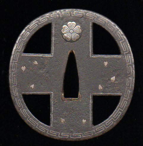

Curran Posted September 11, 2012 Author Report Posted September 11, 2012 The smartest Higo collector I know (only know Ito-san through proxy, and never seem to agree with Jim G opinions anymore) says the kinzogan Jingo isn't correct and isn't interested in buying it. I'm not buying diddly until I get out from under a wave of house expenses & my buying of Higo pieces is sideline, being more interested in other schools. So here have a go: http://page13.auctions.yahoo.co.jp/jp/auction/r93523018 Satsuma mon. This tsuba has probably had more discussion than it is worth, in my understanding of it. Opinions welcome as to whether or not this one would paper at shinsa. Quote
raiden Posted September 11, 2012 Report Posted September 11, 2012 definitely no pass in my opinion. Quote
Soshin Posted September 12, 2012 Report Posted September 12, 2012 Hi Curran, After viewing the tsuba in question I would agree this tsuba don't deserve this much discussion. I am also of the opinion that I wouldn't even bother with submitting it to NBTHK shinsa IF it was in my collection because someone gave it to me as a gift. Yours truly, David Stiles Quote
Curran Posted September 12, 2012 Author Report Posted September 12, 2012 David, Ouch. Harsh. You're definitely not a Higo lover. It is a decent piece that I would say falls to the Nishigaki if it didn't have that signature/attribution to Jingo on it. Quote
Soshin Posted September 12, 2012 Report Posted September 12, 2012 Hi Curran, I agree I wouldn't consider myself a lover of the Higo schools in my eyes a bit over rated with so many copies and fakes. As a matter of fact I have a modern Higo copy on my website for sale http://dastiles1.wix.com/reflections-#!sales/c6jy. In regards to the not submitting a tsuba for shinsa there are a few tsuba in my collection that I will not bother submitting to NBTHK shinsa and I really like them. Some examples include those tsuba that already have NBTHK or NTHK papers, tsuba that have already failed shinsa or would fail (AKA all of my Yamakichibei tsuba), went through a fire or have other major condition issues. Yours truly, David Stiles Quote
Henry Wilson Posted September 12, 2012 Report Posted September 12, 2012 David,It is a decent piece that I would say falls to the Nishigaki if it didn't have that signature/attribution to Jingo on it. I agree with Curran. To me, the metal looks Nishigaki not Jingo. Quote
Lorenzo Posted September 12, 2012 Report Posted September 12, 2012 Curran, I believe I mentioned before on this forum, but last time I went to Japan I had an interesting discussion with a connoisseur who fooled me with a couple of higoesque tsuba which in truth was from Satsuma. See the map, the provinces was confining. He said the fashion was contagious and some works was copied / "made in the style of". The Jingo shape but without a Jingo tetsu, and the Satsuma mon... says it all for me. I wanted to see the enlarged pictures but I can't and I don't know why, so I have to trust you about the steel surface. To me, defiantly no pass. I would say Satsuma tsuba. Lorenzo Quote
raiden Posted September 12, 2012 Report Posted September 12, 2012 Nishigaki school made several versions of this tsuba style, originally from the first kanshiro. However, without seeing the tsuba in hand, i have some reservations as to it possibly being later due to the apparant thick rim with the nakane style mimi zogan. And because i am an avid higo fan, i must say shame on those that do not like higo! I wonder how thick that rim was...... Quote
Lorenzo Posted September 12, 2012 Report Posted September 12, 2012 Higo schools in my eyes a bit over rated with so many copies and fakes Sorry David but the problem is exactly there, you lack the eyes to judge Higo work. Quote

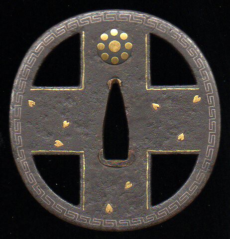

raiden Posted September 12, 2012 Report Posted September 12, 2012 heres something I bought a while back that fits this discussion Quote
