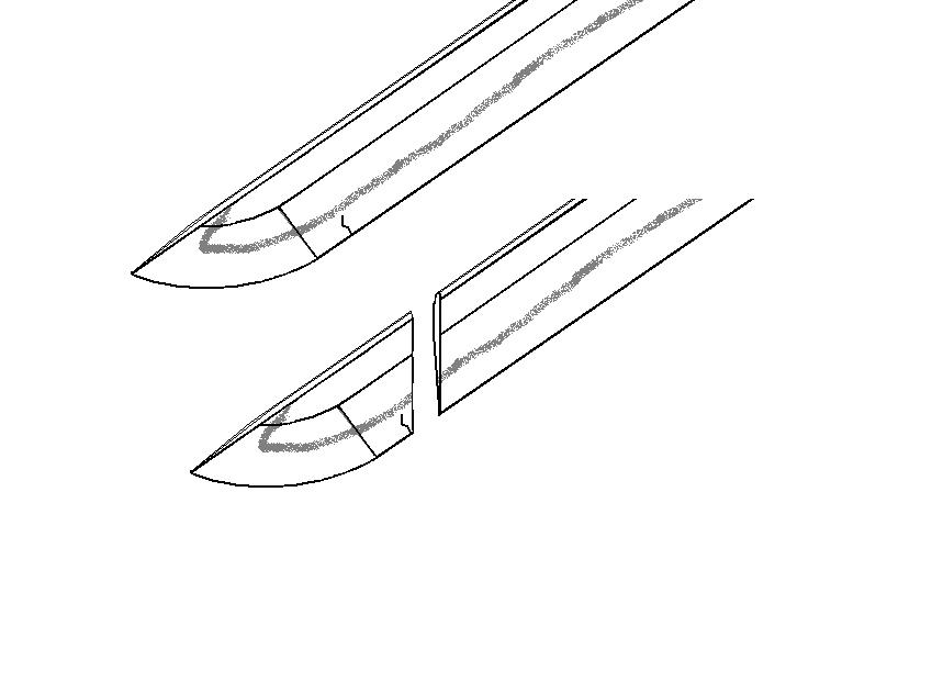

Chonmage Posted September 1, 2012 Report Posted September 1, 2012 I saw this today when I went to a flea market. Sadly I only had the iphone so the pictures are what they are. The reason I wanted to post it here is the kissaki, or whatever I should call this. I've never seen this before, and I thought that maybe someone else here has. I drew it slowly and I was pretty pleased with what I saw considering the cost, but then the wakizashi left it's scabbard completely and I was bewildered, and slightly in chock. The owner told me it had been broken and fixed during edo so I could have it for a sweet price. However, it has never been broken as far as I can tell. To me it seems that the curve is a bit off (The curve takes of rather late only to start tipping forward). Other than that its a nice mid-low range blade (up until the kissaki). But what kind of blade is this? Everything about it suggests strongly that it was made to be in the state it currently is in. Some funky reverse kisakki-grind down. The disadvantages this would give the user in actual combat strongly hints that this was never intended for any conflict what so ever. Glorified magura cutter anyone? Anyway, I'm at my wits end. If anyone has seen something similar before please give me piece of mind. Thanks, -Anders Quote
Brian Posted September 1, 2012 Report Posted September 1, 2012 It's just a broken kissaki, badly repaired. Nothing more. Someone tried to keep as much hamon as possible, maybe even retempering the tip? Brian Quote
Chonmage Posted September 1, 2012 Author Report Posted September 1, 2012 Thanks for the input Brian. but I can't agree with it. This doesn't look like a retempered tip to me. Added to that both the ha and and the shinogi follows the curve: the curve that goes away from the mune. A badly broken tip would be filed reverse don't you agree? No one would file the kissaki to face the wrong way, if you know what I mean. - Anders Quote

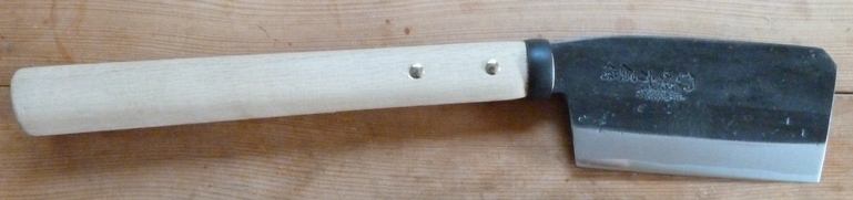

cabowen Posted September 1, 2012 Report Posted September 1, 2012 Who knows what it was made for, could be some kind of fish knife, thatch trimmer, etc.... I agree it is perhaps too long for a typical nata, but length aside, as I said, there are many types of nata, not all have a curved blade, or a cutting edge on the inside edge. Here is one I picked up last year when I was in Japan to split kindling..... Maybe we will never know for certain what the intended purpose is of this particular blade, but I feel comfortable assuming it is a tool of some sort....Perhaps one of our Japanese members has more information... Quote

Brian Posted September 2, 2012 Report Posted September 2, 2012 I still don't believe it is original like that. Not 100% sure how/why it was altered...but look at that shinogi line in the kissaki and the cutting edge at the tip. They are not straight, and have inconsistencies in the lines. No smith would finish a sword like that, so some alteration has definitely happened using a grinder or stones. I am also not convinced that turnback consists of nioi or nie...there is a line that continues through the kissaki. Whatever it is, you can be sure it wasn't originally made 100% like that. Brian Quote

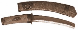

cabowen Posted September 2, 2012 Report Posted September 2, 2012 Eric H said: Kubikiri Equipment Keywords: Kubi Bukuro - Kubikiri - Kubi Oki pic from another thread Eric Can you now post a Japanese source? Quote
runagmc Posted September 2, 2012 Report Posted September 2, 2012 Brian, for what it's worth, I definitely see what you mean and think you may be right... I'm still not 100% sure. The shinogi could be ground down to make it curve downward at the tip like that... It's hard to say for sure from these pictures... The thing is, everything except the tip looks like a typical shinogi zukuri wakizashi... Quote
Eric H Posted September 2, 2012 Report Posted September 2, 2012 as I said „pic from another thread“ (on NMB) Fresh out of the woodwork nihonto ? a Japanese source about „Kubikiri Tanto“ ... your source http://www.samurai-weapons.net/samurai- ... s-of-tanto Eric Quote

cabowen Posted September 3, 2012 Report Posted September 3, 2012 I thought I was clear- that the notion these blades were used to remove heads seems to be a western invention. Eric posted a page from a Western source claiming these are made for taking heads. I asked him for a Japanese source. He gave a link from a source I used for the picture I posted and claimed it was a Japanese source. I posted the domain owner's name and address (USA) which makes it clear that this source is not Japanese. I again asked for a genuine Japanese source that pictures and calls this type of blade a head remover. If anyone can find a Japanese source, I assume it will be Eric....That about sums it up.... Quote
