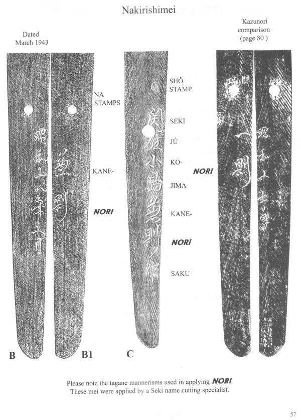

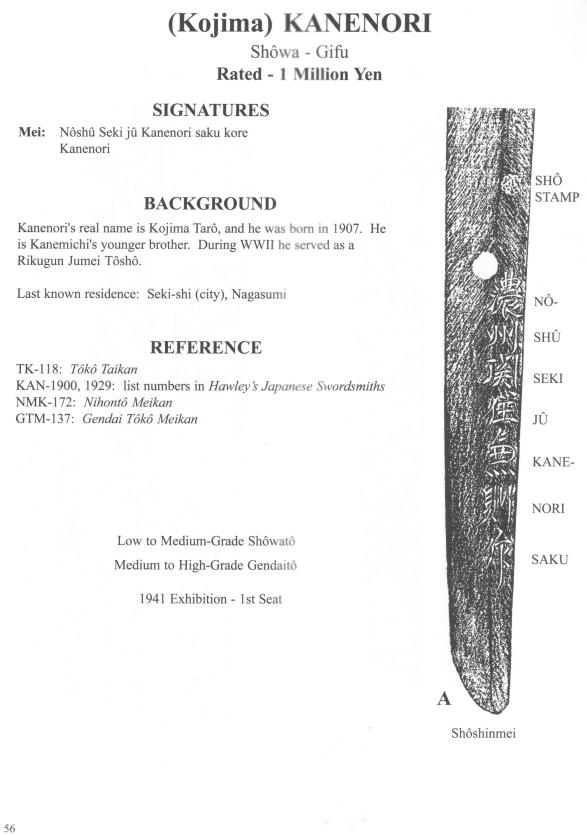

The other side if the name i need translated.

i do not see any arsenal stamps or indication of non-traditional making marks. Is it possible this one is a gendaito vs a Showato since Kaneniro made both? One could always hope......
