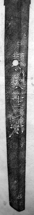

A friend in London was showing me a wakizashi with the Mei written in reverse image. (Kane-something.) I tried running a search here on the NMB but came up blank. The subject is not mentioned in my single work of reference here in London, John Yumoto's The Samurai Sword.
How common was this practice, and do the members have a) other examples, b) a more accurate word to describe it. In one book I found the expression hidari-kiki or left-handed, but was the signature written this way to indicate a rare left-handedness that had not been corrected in early age as per norm?
Odd, the oshigata example is not cut backwards ?
I had one of these several years ago. Here is a photo of the Nakago for reference.
Here's the mirror image of the oshigata. Could the pic Morita-san posted be a mirror image, and this be the way it really was? Just a thought... post-2413-14196841466311_thumb.jpg

This my oshigata was not drawing by Sekkaboku-black-wax.
This Oshigata was printed with painted black-ink to the Nakago(tang) directly, like a Hanga print.(Old technique of Oshigata). :D
Oops, guess if I had paid attention to the entire nakago on the oshigata I would have noticed that!
