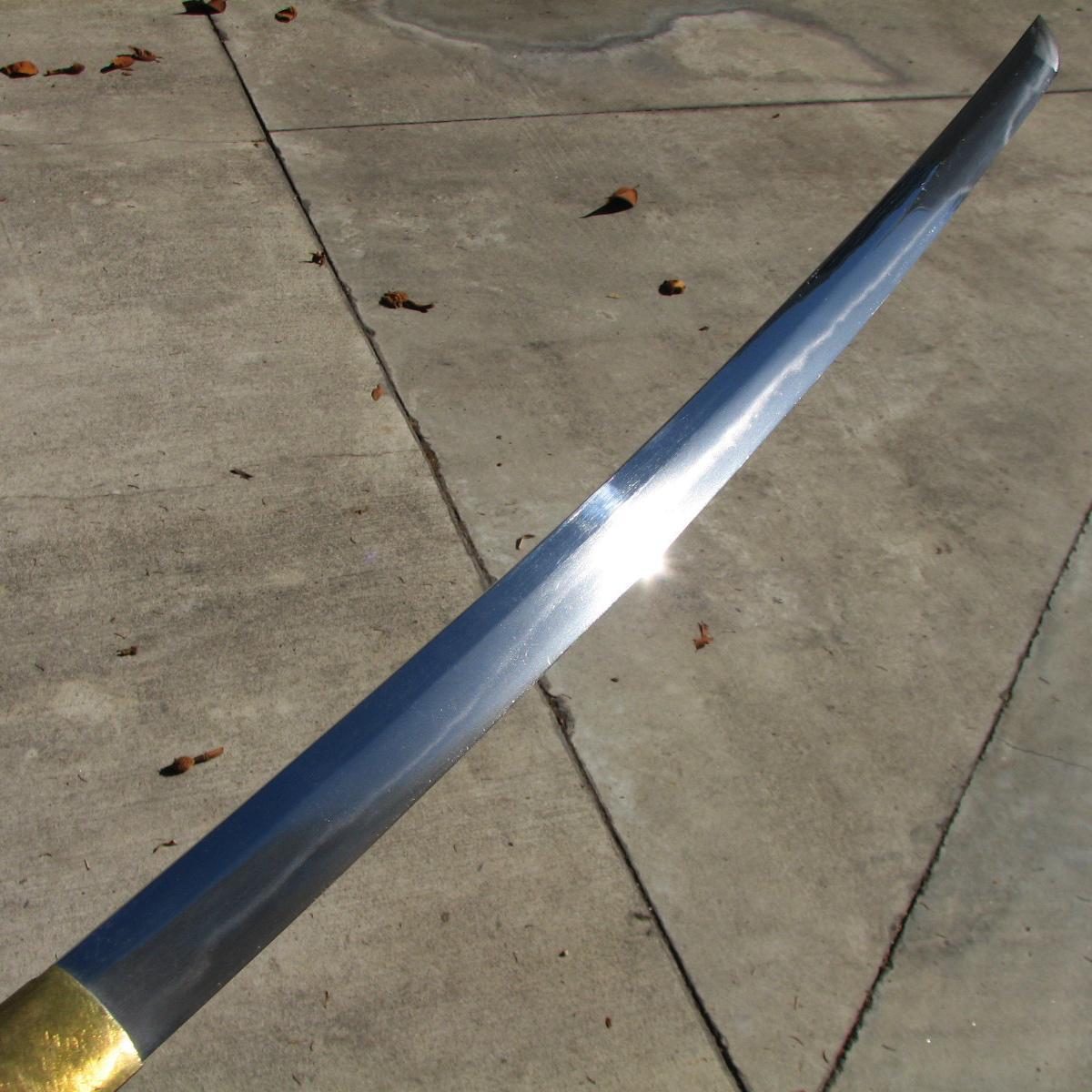

It seems there is a problem with the blade and that the hamon runs of the blade at the monouchi (15 cm before the tip of the blade) Is it the picture?

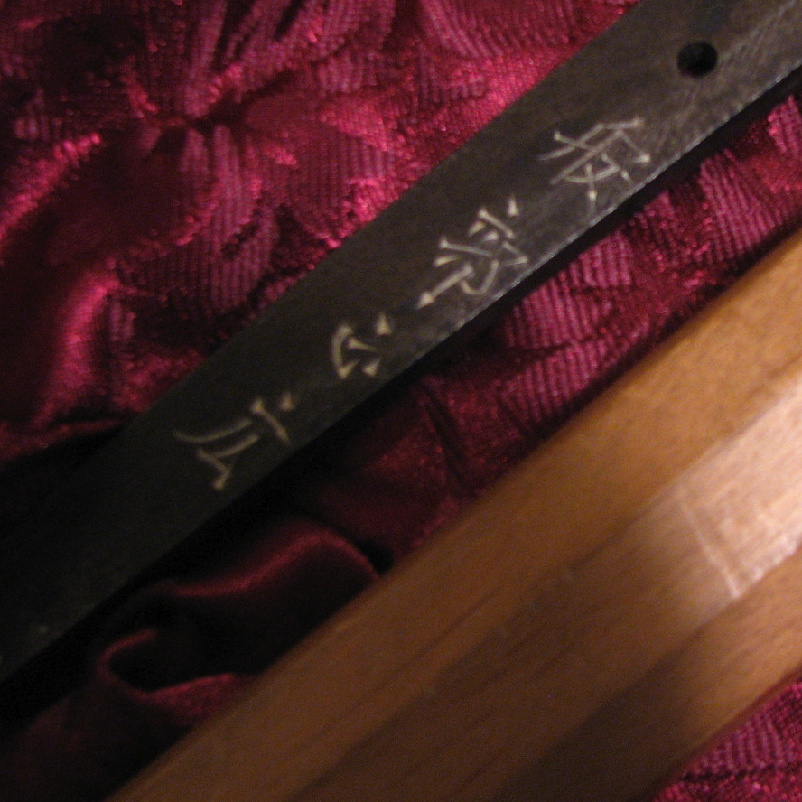

Hi, I think it reads Kunimasa. You paid quite a bit for this sword as I saw the auction for it. As others have mentioned with the hamon running off the blade this might be a learning experience as many of use have had. Regards, John

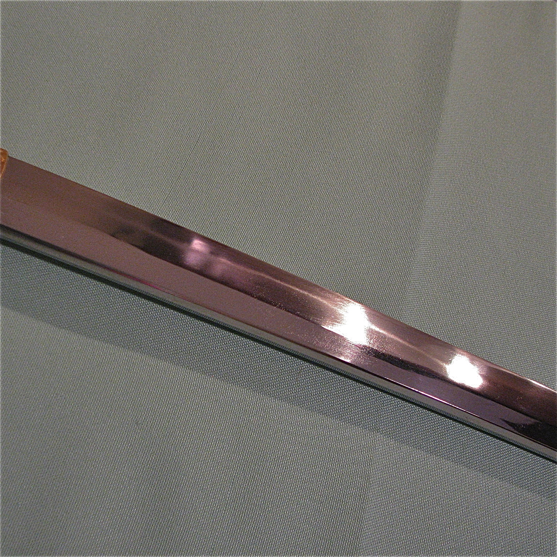

Can we see a picture of the other side of the blade where the hamon goes off the cutting edge?
No..this isn't a normal hamon for this smith, it is a mistake in forging and quenching. It is a WW2 blade.
