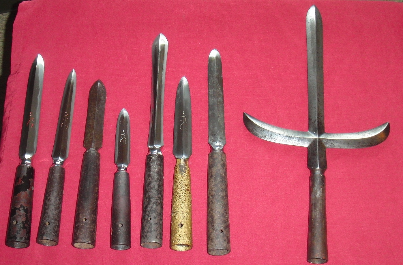

Hi all,
Brian, Hear are the Fukuro yari.
From L to R.
Nobukuni
Nobukuni
Choshu Morihide
Nobukuni
Nobukatsu. Nobukuni group Dated 1772.
Nobukuni
Jumonji. Unsigned.
Hope this is of interest
Regards. Chris.F.
Oh wow...awesome collection. I am jealous.
Chris, if you come across another one, condition not too important...please keep me in mind :)
Thanks for sharing.
Brian
