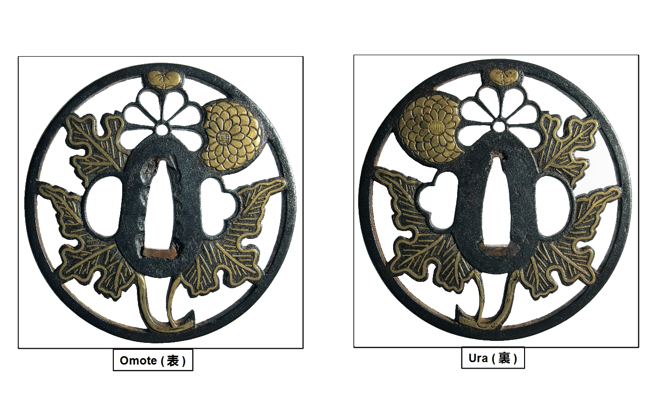

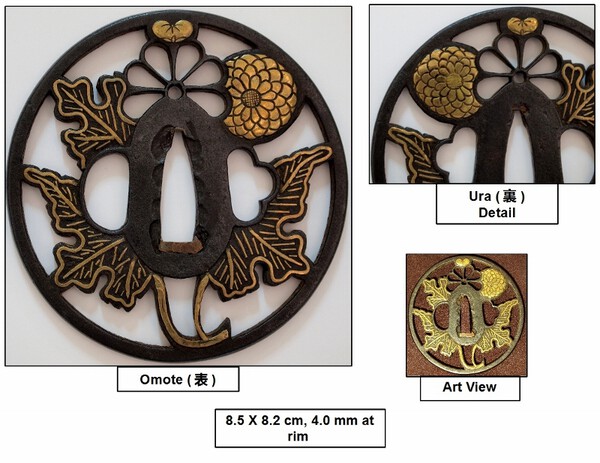

Soshin Posted August 18, 2012 Author Report Posted August 18, 2012 Hi Everyone, Here is the new tsuba to my now much smaller collection who the former own was thinking it was a work of the Goami (Kiami) school circa the early Edo Period. It is unsigned. Two of the photographs were photographed under different light conditions and angles. I don't have much experience with photographing tsuba with this much inlay work. The size of the tsuba is a large one at 8.5 X 8.2 cm with the thickness at the rim is 4.0 mm. I am thinking it could be Goami or possibly Kyo-Shoami work. Often you see this intermix of ji and kage sukashi is Shoami designs along with inlay work. The design is of the Japanese Chrysanthemum (Kiku) with leaves. Not sure what flower is pictured in the inlay at 12:00. It might be a flower bud but I am not sure. The overall feeling of fine craftsmanship of the tsuba and specifically the quality of flat brass inlays (shinchu hira-zogan) is wonderful. The very dark brownish black color of the iron contrast well with the finally patinated brass inlays. Please feel free to comment and questions are welcome. :D Yours truly, David Stiles Quote

Brian Posted August 21, 2012 Report Posted August 21, 2012 Very striking tsuba, I like it. Has the inlay been polished or just somehow avoided tarnishing? And is there any chance of some gold there..as I see a few different tones of colour there, or is it just my colour blindness? Anyways...very nice, and unusual. Brian Quote
docliss Posted August 21, 2012 Report Posted August 21, 2012 How, then, are we to label David’s striking new acquisition? Lion Gate have labelled it as Kō-Hagi circa 1600, and this can clearly be immediately discounted. Apart from the incorporation of positive and negative silhouette on a design of chrysanthemum leaves and blossoms, this bears no relation to the work of the Kyō-sukashi school, from whence Kō-Hagi work originates. Surface line carving is acceptable in the work of this school, but not soft-metal decoration. And ‘circa 1600’ – surely not. Holbrook labelled it as “Brass inlay, Kiami School, kiku, early Edo”, and how realistic is this? Goami work, produced in the late C17 to the early C18, is described as being in the Shōami style and extremely simplistic. The profuse zōgan on a ji-zukashi plate is acceptable, as is the kaku mimi, but a mikaki-ji surface would be more ususal. The overlap between the Shōami and Goami schools is a very strong one, but the very high quality of the zōgan, and the rather broad ryō-hitsu make me rather favour a C18, Awa-Shōami provenance rather than a Goami one. This former group was renowned for its elaborate use of nunome, which reached a peak in their Kenjo, or presentation, pieces. John L. Quote
Soshin Posted August 22, 2012 Author Report Posted August 22, 2012 Very striking tsuba, I like it. Has the inlay been polished or just somehow avoided tarnishing? And is there any chance of some gold there..as I see a few different tones of colour there, or is it just my colour blindness? Anyways...very nice, and unusual. Brian Hi Brian, Glad you like the tusba always good to keep the administrator happy. This tsuba was the replacement from Grey Doffin for this tsuba discussed on the NMB: http://www.militaria.co.za/nmb/viewtopic.php?f=2&t=13376. The tsuba while showing some evidence on the seppa-dai of being mounted on a Nihonto for a while at some point displays all of the characteristics of a tsuba that has been very well taken care of by all of its former owners and have avoided excessive tarnishing of the brass and rust pitting of the iron. I am always happy to see this on a tsuba. :D In regards to your second question to the best of my knowledge the inlays are brass and not gold but I can do more research on this. Does anyone know what low alloy gold look like mixed with brass? Hi John L., Thanks for the reply I agree with you analysis of the similar tsuba listed on the Lion's Gate website. Looking at my tsuba I also would agree with the middle Edo Period age as the iron looks very well forged but homogeneous in character and lacks any tsuchimei-ji or tekkotsu on the surface or along the rim typical of Shoami tsuba from the early Edo Period. One quick question about the Awa-Shōami school did they also use brass flat inlays (shinchu hira-zogan) techniques with their inlays in addition to the normal kin nunome zogan type often seen on Kenjo tsuba? Thank again for taking the time to answer my question. P.S. Attached is another photograph I did with my iPhone under different indoor lighting. Enjoy. Yours truly, David Stiles Quote

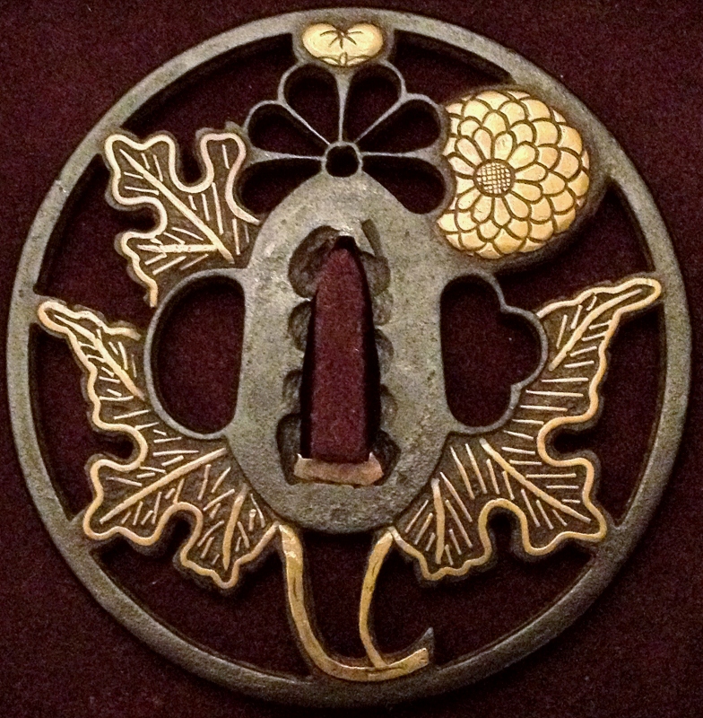

Soshin Posted October 6, 2012 Author Report Posted October 6, 2012 Hi Everyone, I just want to updated this topic. Here are some new photos I did of this tsuba using better lighting and focus. They are of higher resolution so you will need to click the link below. This helps with seeing some more of the details of the brass inlays. The photos came out really nice. :D Please enjoy feel free to comment. Questions about the the Hirata family in Awa Province. Did they have any connection with the famous Hirata family located in Higo during the Edo Period? I just noticed that the reading (ひらた) and the Kanji characters themselves are the same (平田). I know that the Hirata family was directly employed by the Daimyo of Awa Province much like the Hirata family in Higo were directly employed by Daimyo of Higo Province. Yours truly, David Stiles Quote
Soshin Posted October 7, 2012 Author Report Posted October 7, 2012 Hi Everyone, Did my homework this weekend and determined that Higo and Awa Hirata schools are just different branches of the same Hirata family that originated in Kyoto and worked in a Kyo-Shoami style. The branch of the family that worked first in Tango and later Higo provinces was the Tadaoki line and the branch of the family that worked in Awa was the Fujitaka line. Both schools work exclusively for their respective Daimyo families. The sources of the information is Tsuba An Aesthetic Study by K. Torigoye and R. E. Haynes and Tsuba by G. D. Murtha. Yours truly, David Stiles Quote
