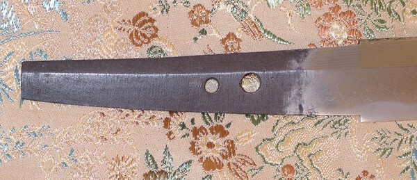

bmoore1322 Posted August 7, 2012 Author Report Posted August 7, 2012 @ Franco There is no yokote line, here are the pics, I have been talking with the seller on this, we have pretty much came to an agreement on the price, I just wanted to get everyone's opinion on it. I like the way it looks, as it does have hada present, and the hamon looks like notare midare to me. Habaki is Gin-gise, or silver covering copper base. The cutting edge is 40.5cm(16 inches), and the Nakago is 13.8cm(5.3 inches) which has beautiful file marks with two holes, The blade is very thick (8mm on the center Mune line) and wide (3.5cm). Brian
bmoore1322 Posted August 7, 2012 Author Report Posted August 7, 2012 More pics. Everything is old to the sword except new Tsukamaki rapping. The blade is early Shinto but could be Koto, overall it is very healthy and has no nicks, no openings, but one very tiny dark spot on the Jihada. Brian
Jacques Posted August 7, 2012 Report Posted August 7, 2012 Hi, But how often would an Naginata be reshaped into an Wakizashi, That one is not a naginata/nagamaki naoshi, it's a shobu zukuri wakazashi.

NihontoEurope Posted August 7, 2012 Report Posted August 7, 2012 That one is not a naginata/nagamaki naoshi, it's a shobu zukuri wakazashi. I have seen such blades being claimed to be shortened/ cut down Naginata before. Are you 100% sure Jacques? /Martin
Kam Posted August 7, 2012 Report Posted August 7, 2012 It is defined as an Unokubi zukuri and was most likely forged as such. I have one almost identical. Will get some pics. As for Nagamaki, Naginata debate I think while the NBTHK might find it easier to classify as the same just diff mounts, I would be more inclined to follow the basic rule stated earlier. Gordon Robson (NTHK) made a point of this as I had pointed out. Either way red and green apples. Kam

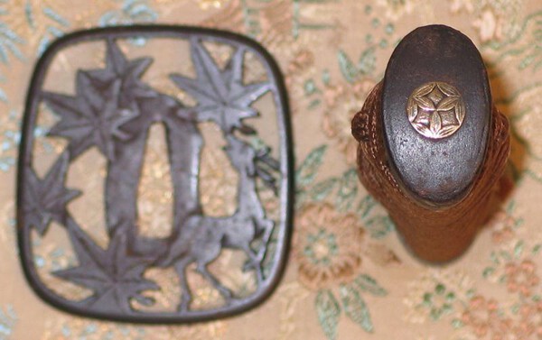

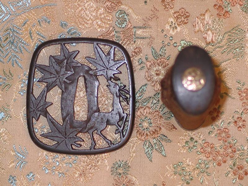

bmoore1322 Posted August 7, 2012 Author Report Posted August 7, 2012 Would anyone know anything about the Kamon, or silver family crest of leaves on both Fuchi and Kashira, what family these would have belonged to, and their importance , if any. Brian
Jacques Posted August 7, 2012 Report Posted August 7, 2012 Hi, Are you 100% sure Jacques? Yes, there is a kaeri on the boshi.

bmoore1322 Posted August 7, 2012 Author Report Posted August 7, 2012 @ Ian The hamon is prefect the whole way down, not cut off, or narrowing at any point along the habuchi, the Ha, and the Ha-saki are in perfect condition as well. Brian
bmoore1322 Posted August 7, 2012 Author Report Posted August 7, 2012 I'm beginning to think it is an shobu zukuri wakazashi, as one member already said. Brian

Brian Posted August 7, 2012 Report Posted August 7, 2012 Is it just me, or is that tsuba theme one of the most un-Japanese themes I have ever seen? :? Dunno...it just looks like someone's Western idea of a Christmas ornament to me. No Japanese feeling coming from it at all. Am I crazy? The kogatana looks modern too. Sword looks ok though. Brian
Thierry BERNARD Posted August 7, 2012 Report Posted August 7, 2012 Is it just me, or is that tsuba theme one of the most un-Japanese themes I have ever seen? :? deer and maple leaf is a very common Japanese theme!! http://zincavage.org/DeerandMaple.html
nagamaki - Franco Posted August 7, 2012 Report Posted August 7, 2012 Dunno...it just looks like someone's Western idea of a Christmas ornament to me funny you say that, made me do a double take, as it reminded me of some of my wife's x-mas cookie cutter patterns. On the other hand it also brings to mind the deer browsing on newly sprouted Japanese maple leaves every spring in the yard.
NihontoEurope Posted August 7, 2012 Report Posted August 7, 2012 Nagamaki have no Bohi Kam Kam, I have a Nagamaki with Bo Hi carvings (original). /Martin
Brian Posted August 7, 2012 Report Posted August 7, 2012 Think I phrased it wrong. It is not the theme itself that is odd...but the way it is depicted/executed that looks very untraditional to me. The deer looks too comical, like it needs a red nose, and the lines are all just odd. Overall feeling is all... Ah well...not serious Brian
