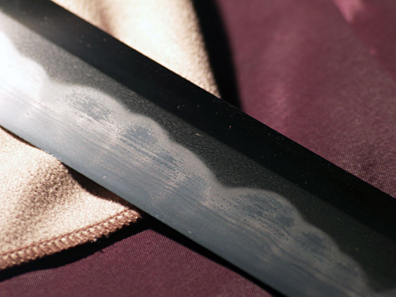

Lindus Posted August 5, 2012 Report Posted August 5, 2012 So, we have a brand new blade but looks spectacular,not an art object but many would be happy with....what is its monetary worth?....also in a decade what would it be seen as a financial investment??? Then as with many other smiths being re-evaluated,how would this be seen in a decade I wonder. I had a sword by the 1st generation Shigetaka,when viewed many years ago by a "Major" polisher in the UK at that time, he said that at this time it was not of any real interest but this and others were being re-evaluated.......... I go back time and time again to the old rule of thumb... Can you afford it? Do you really like i?? Buy it Quote
Danocon Posted August 6, 2012 Report Posted August 6, 2012 "Yoshifusa" is the 2 character mei on the tachi-omote (in the hammered looking area), and the cutting test is the long inscription on the other side... Sometimes new mekugi-ana are done purely for a new set of mounts, even when the nakago remains unshortened. Really!!!! Shows you what I know about kanji. Pardon the newbie questions but I find this blade very interesting. Both for the beauty of what it is and whatever has been done to it to pass it off as something else. So only the area of the signature on the nakago has been hammer peened. The signature that is there now had to have been done after it was hammered. Tell me why this would not immediately set off all kinds of red flags Quote
Tcat Posted August 6, 2012 Report Posted August 6, 2012 So, we have a brand new blade but looks spectacular,not an art object Not Koto...but not an art object? This looks like one of those Kiyomaro copies you occasionally see on e-bay. I quite like the sword but it certainly isn't what it says on the tin. Quote
Kam Posted August 6, 2012 Report Posted August 6, 2012 Mmmmm, lets see nice sugata, neat tight hada, well done hamon from what I can see (a little masked by the hadori). Still an art object. . . regardless. . . . and lets face it some forgeries are art in themselves, a lot of skill goes in to making a good forgery. So yes it really is a nice peice of art. . . just not as described. Kam Quote
drjoe Posted August 6, 2012 Report Posted August 6, 2012 I doubt the smith who made the blade did it.... It was done for profit, plain and simple. Sometimes a smith will make a copy, down to the patination, etc., but I believe they must sign their name to the blade by law. It is easy for someone else to have the name removed and a spurious mei added. It has been part and parcel of Japanese swords for 1000 years. One might even say it it tradition... If nothing else, the 7 body test is a tip off....That is sheer nonsense... yes, for money of course... but it does seem unlikely that a modern smith making something of this quality would forge a signature. i've never seen even a shinsakuto utsushi with a nakago made to intentionally look old -- do you have examples of this? and where is the profit coming from? assuming this is a kimura blade, we're talking about ballpark $10K for a new comission of a blade like this, right? so then it falls into someone's hands, and they go to the trouble of erasing the mei, patinating the nakago and carving a new fake mei, and selling it for about the same price? i realize lots of people who have that kind of money might be fooled by this, but it's not like its being sold for what a fukuoka ichimonji would cost. so i still don't really see the point. i just came back from sf token kai, and i do now remember speaking with a gentleman there with a new flashy soft-cover catalog-type book (in Japanese) called something like "encyclopedia of Japanese swords." there was a very similar oshigata it in of an enormous o-kissaki blade with a mei that included test cutting results (the blade was featured in an article about test cutting on bodies). anyone know the book? Quote
Jean Posted August 6, 2012 Author Report Posted August 6, 2012 Alex, It is Bizen Utsushi and has nothing to do with Kiyomaro Utsushi, lack of sunagashi and above all lack of nie for which Kiyomaro is famous. Joe, That is the reason why I asked the usual measurement of such blades. I see perhaps one explanation, far fetched. This sword has suffered from a big accident thus has been shortened and faked into a Nambokucho blade by adding cutting test and gimei. BTW, how many blades has one seen with a seven body test cut (even in books)? Quote
Jacques Posted August 6, 2012 Report Posted August 6, 2012 Hi, This sword has suffered from a big accident thus has been shortened and faked into a Nambokucho blade by adding cutting test and gimei. As there are no Yoshifusa in Nanbokucho era, i think it's more an error from the seller than something else. All the rest is speculation Quote
Jean Posted August 6, 2012 Author Report Posted August 6, 2012 As there are no Yoshifusa in Nanbokucho era, i think it's more an error from the seller than something else. That's what I call speculation Quote
Tcat Posted August 6, 2012 Report Posted August 6, 2012 Alex,It is Bizen Utsushi and has nothing to do with Kiyomaro Utsushi, lack of sunagashi and above all lack of nie for which Kiyomaro is famous. Sorry Jean, perhaps that was stretching it a bit. What I meant to say was that this reminds me of some of the the moderately priced rather flash utsushi occasionally seen offered on ebay. They looked a lot like this blade and the Kimura blades that Chris posted examples of earlier. I dont remember nie or sunagashi visible in these copies...although having said that, I do not think that all fake kiyomaro's have all the features which knowledgeable collectors would be looking for...rather just an approximation of sugata, a flash hamon and okissaki. Quote
