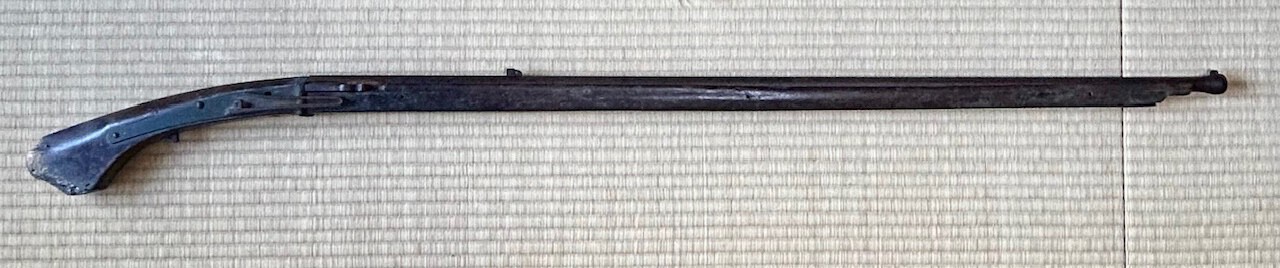

I have one more long gun with a blocked 'himichi' vent that I may ask him to help with. I've tried just about everything I can think of, but every thickness and strength of wire gives up and bends eventually. If I could introduce an angled awl into the breech chamber... and attack the barrel rust in the vent passage from within, that could be a new angle of attack, though.
One thing I have tried before successfully is to put a very short section of cable, such as bicycle brake cable, into a drill, and go slowly. The multiple wires in the front act as a flexible "drill" but take it very easy and use oil.

Brian, for some reason I missed your inspirational answer here. I can 'see' in my mind exactly what you are saying; that will be a really great tip for next time.
Although I had booked a slot at my friend's house for this coming Saturday, I actually managed the break-through yesterday morning. The wife was out so I had the house to myself, and I decided this thing was not going to defeat me. Altogether, including previous sessions, the whole effort took about six hours, but using Kure 5-56 spray, a tough wire and various pipe cleaners, from outside through the pan vent entrance, and from inside the barrel (angled sunlight showed the inner end of the channel), I started to get a blacker colour of gunge on the wire tip. It was a question of belief, as I could not be 100% sure that it had not been deliberately deactivated. Gradually I began to be able to 'see' what the tip of the wire was doing (the passageway is only one strand wide), as it scratched endlessly and then slowly began to engage; minuscule changes in the colour of what I was wiping off it became my only source of courage.
But what a relief! I was dead pleased yesterday, and this morning the same feeling of relief is still with me. This matchlock (the Inatomi-Ryu long gun I was discussing in the translation section) was no more than an interesting decoration when I bought it, but it is now back to full working order. :clap:
Lesson learned. Always check everything, including the vent channel; assume nothing.
