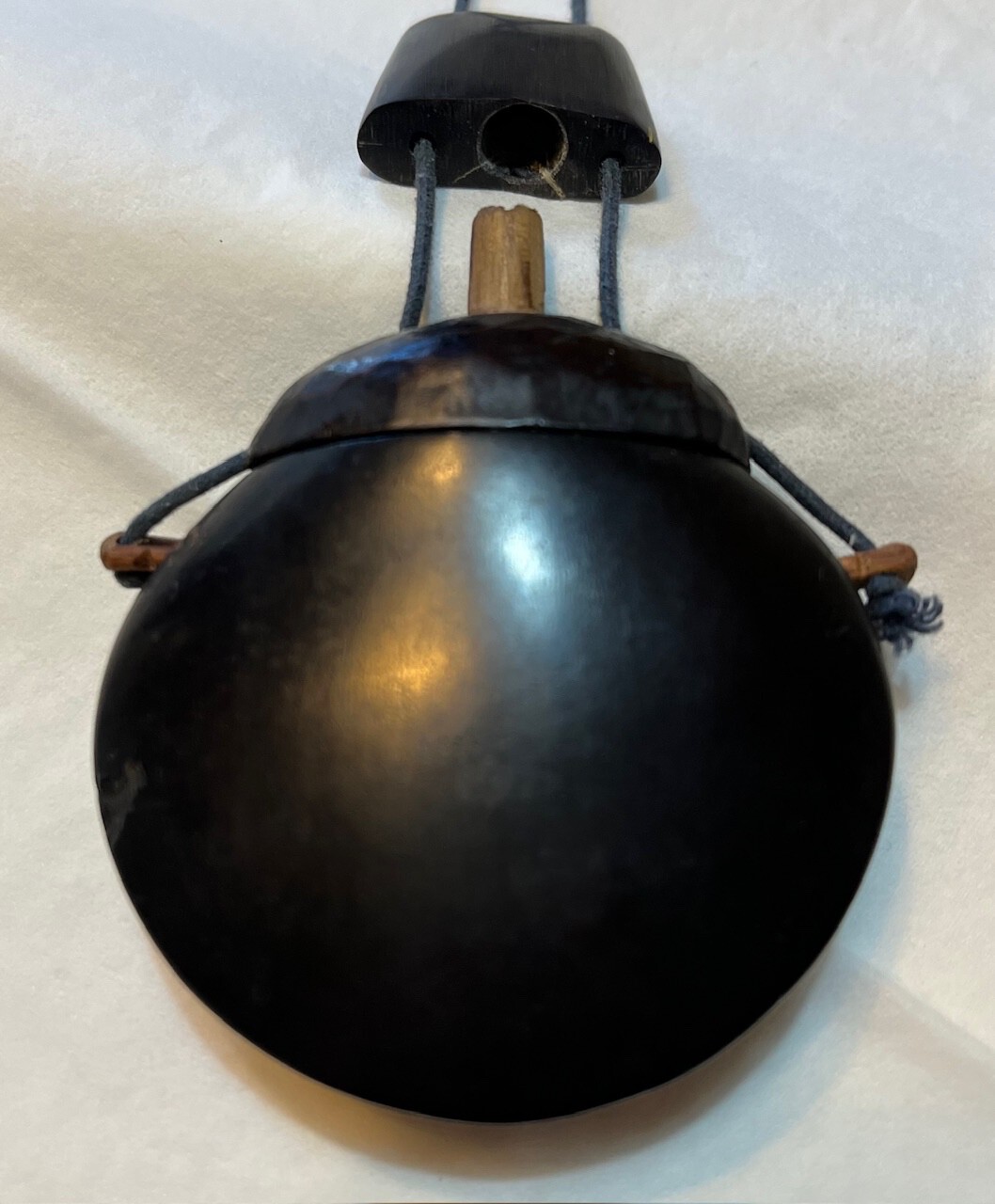

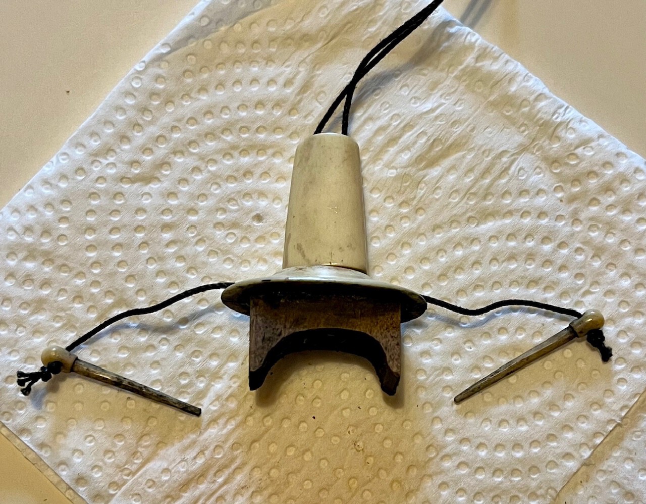

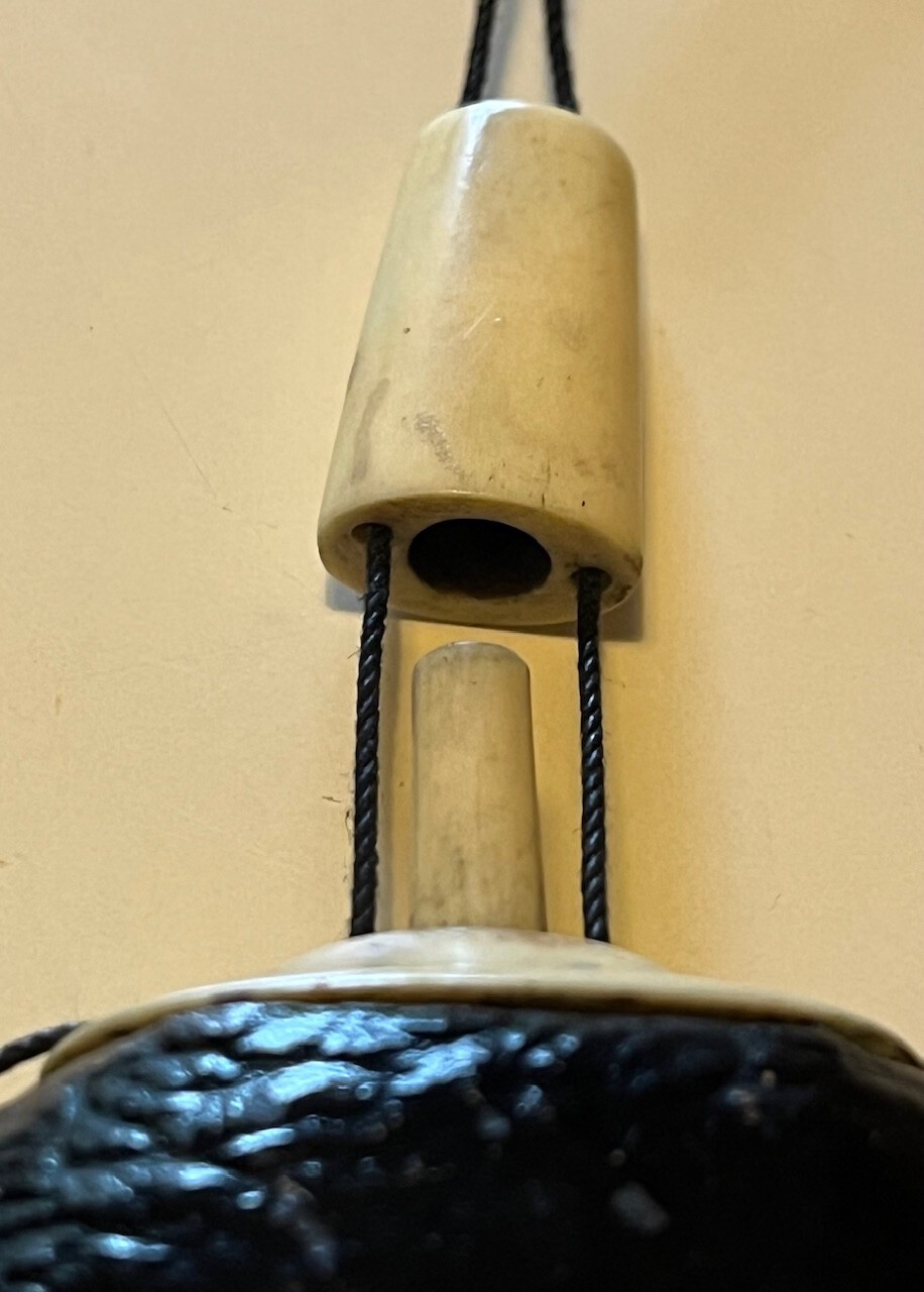

Bugyotsuji Posted December 19, 2023 Report Posted December 19, 2023 To illustrate the above. The flask will hang from a ring on your breastplate, etc. (Using a complete original example here, made with stag antler. Watanabe kamon.) As it hangs, note the pins fixing the internal bridge to the body. Above the bridge is the collar; the spout passes up through both bridge and collar. The cap runs on the strings, now in place over the spout. You can see what I am calling the ‘bridge’ when you open the thing to fill it with fine gunpowder. And to see how the cap works inside. The spout chamber remains dry even if water drips down the strings. Imagine drilling these channels by eye and experience! 2 2 Quote

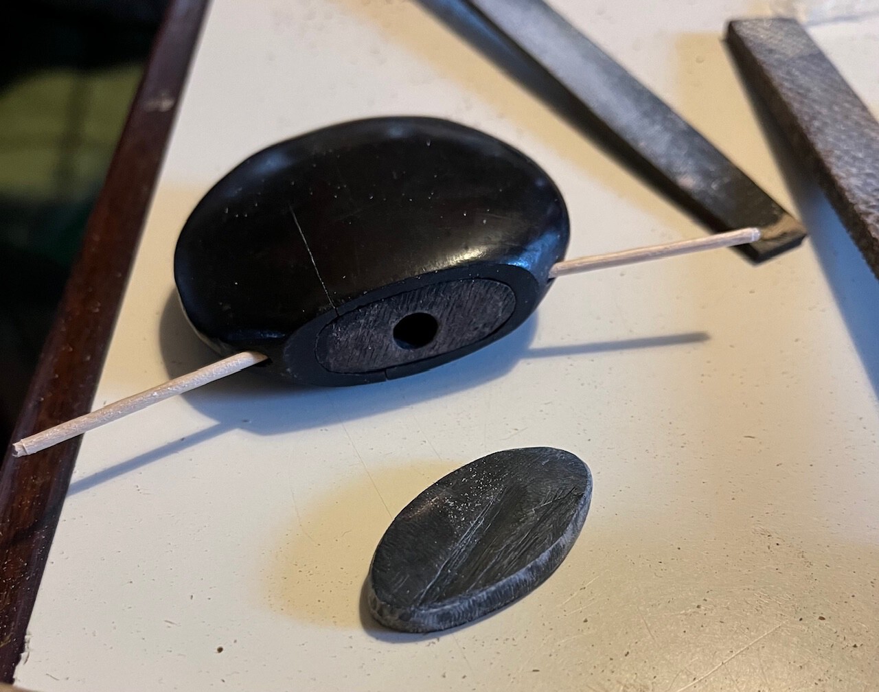

Bugyotsuji Posted December 19, 2023 Report Posted December 19, 2023 Now for me perhaps the most difficult drilling job. The collar should also take water from the strings but disperse it externally. You drill the collar inwards and upwards from the outer edges. Then you drill downwards from either side of the spout, and hope to create a connecting string passage. Also, hope the collar holes line up with the string holes in the cap! In this example the collar passage must have been relatively easier than the one I am now in process of making. So the cap takes three drilling operations. The bridge and collar take one main hole for the spout and four drills into the shoulders. Ideally you would also drill a ninth and tenth hole, into the pin heads. Yesterday I broke a pin after hours of work… grrrr… With this fully-evolved stringing mechanism, each workshop would have had a slightly different method and style, but all of these were made by hand. 7 Quote

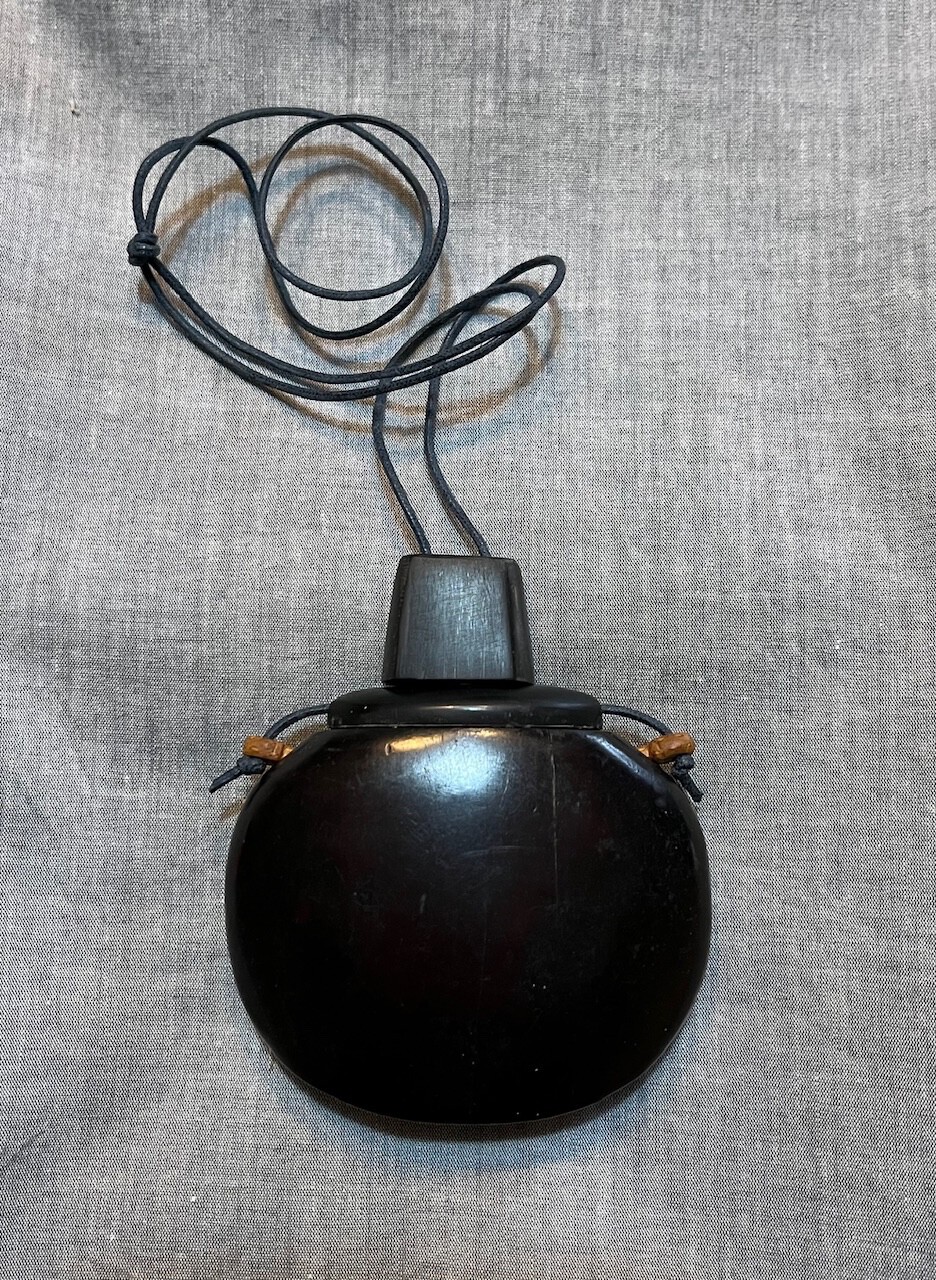

Bugyotsuji Posted December 19, 2023 Report Posted December 19, 2023 Yes, it’s a nice example, I agree. And here is the one I was asked to make up, before and after. Less of a Daimyo artefact, more standard gunnery equipment, but now fully functional. Perhaps five days' work, on and off. Before After 2 Quote

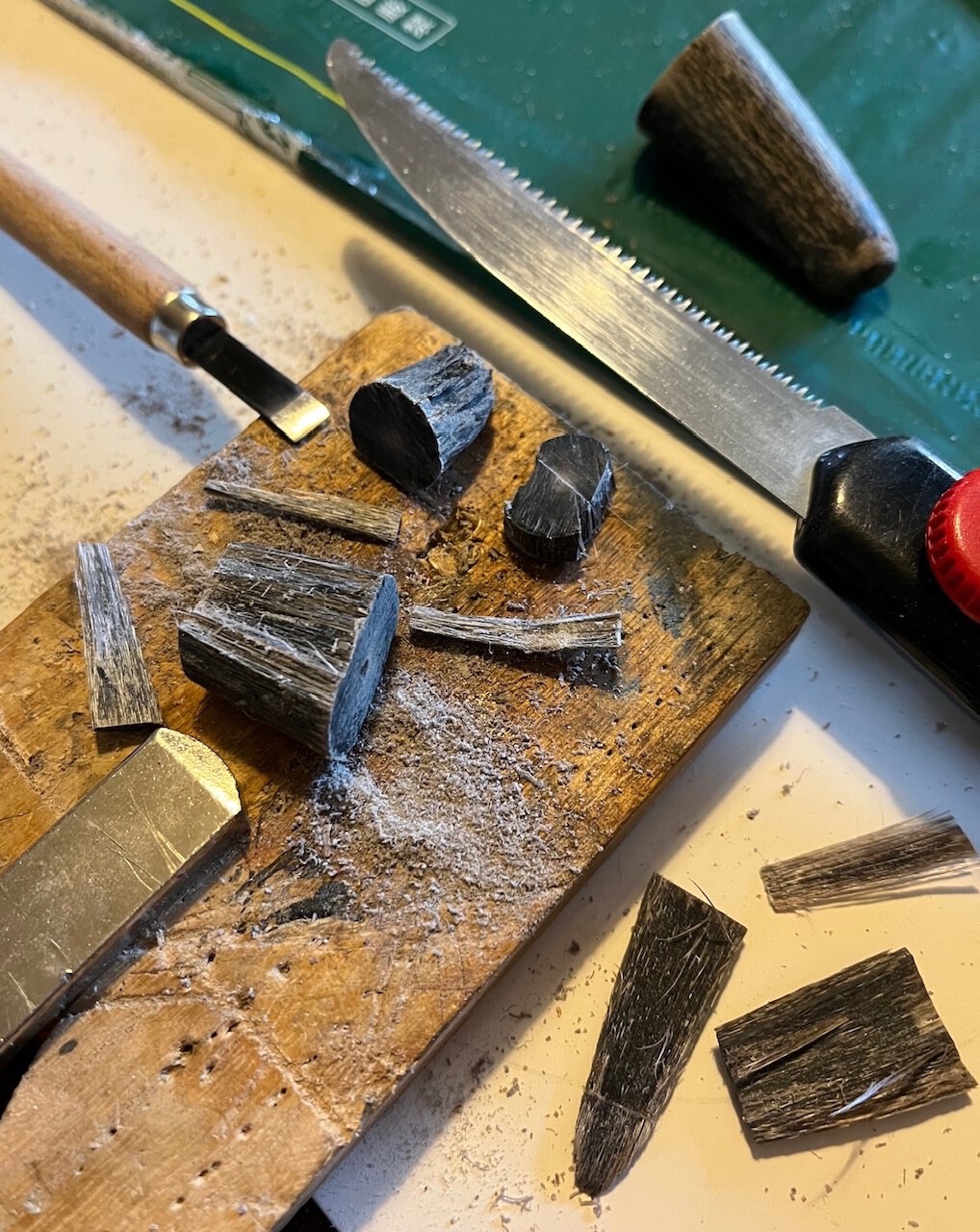

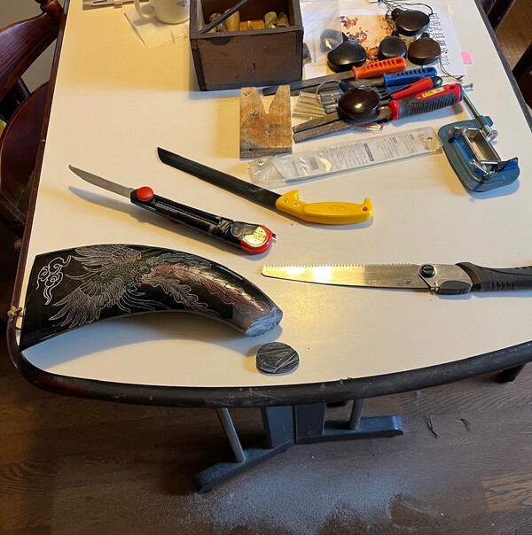

Bugyotsuji Posted December 19, 2023 Report Posted December 19, 2023 Eventually settled for susudaké for the pins. For the collar I took a slice off this. (Solid down to here. Hollow coming up?) And for the cap I used the tip of another horn. 3 Quote

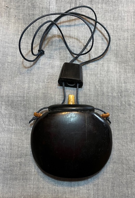

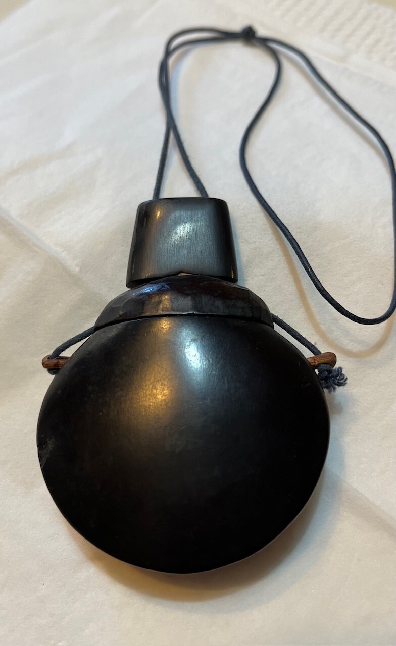

Bugyotsuji Posted December 21, 2023 Report Posted December 21, 2023 And this is the latest one I have been reluctantly repairing since yesterday. It was in seriously filthy condition, totally gummed up, so I did not think to take ‘before’ photos. Note the (original) collar is ‘Ittōbori’ carving in wood, which was then heavily lacquered. The cord channels were blocked with remnants of original string. I used a long-rejected horn cap into which I have bored new guide channels, made two pins from smoked bamboo, then finally restringing the whole thing. Now working again. After repeated cleaning of centuries of gunge it actually begins to look good, another piece of history saved from being junked!?!? 2 1 Quote

Bugyotsuji Posted December 21, 2023 Report Posted December 21, 2023 Although I do have some waxed black twine which would probably have been ideal here, and which I use on my regular trusty primer flask for demonstrations, this is a rather useful smooth blue cord which I bought about 10 years ago, also in black and dark green. It does give the appearance of being waxed, I agree. (I have a bag of strings and cords both new and old… or rescued!?!?) It looks better than the more functional waxed twine, although it might not be as resilient to wear and the weather. Please do present your examples anytime, BaZZa! Quote

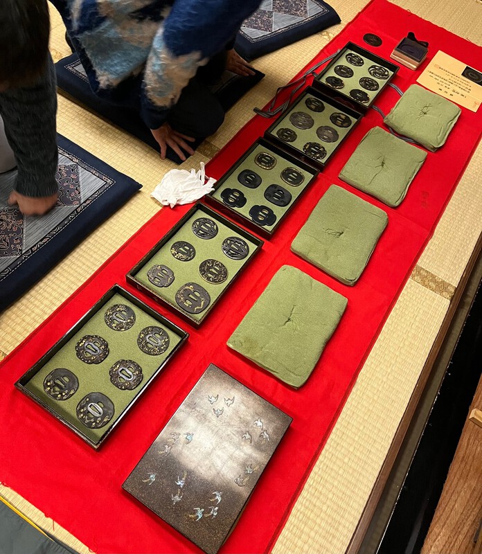

Bugyotsuji Posted February 11, 2024 Report Posted February 11, 2024 (Strangely, the guy who received this powder flask kept asking me where I got the dark blue string from. Well, I couldn't remember, could I? So I gave him what I had left and he looked happy.) Last night we had the local NBTHK sword meeting, and among the extra goodies laid out (a selection of Dai/Sho tsuba pairs), was a single tanto koshirae. The saya was kind of bulky and gaudy, causing the sword Sensei to remark, "This would never have been worn by a samurai! More suitable for a rich merchant." Well, I could not resist taking a few shots of it. "No kozuka, though?" someone remarked. "No, the slot is signed inside by the lacquer artist", was the reply. Sure enough, there it was, something I have never seen before in such a place. Tiny writing, so I took a photo and blew it up. I was doubly surprised to discover that it was the same signature I had seen on a black lacquer inro some years ago. 洋遊齊 (Hara) Yoyusai, 1769-1846. Photos follow shortly. The tsuba collection. 1 Quote

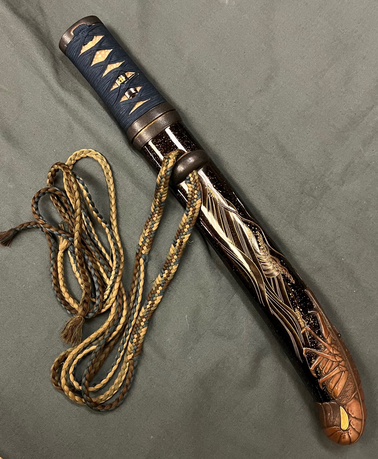

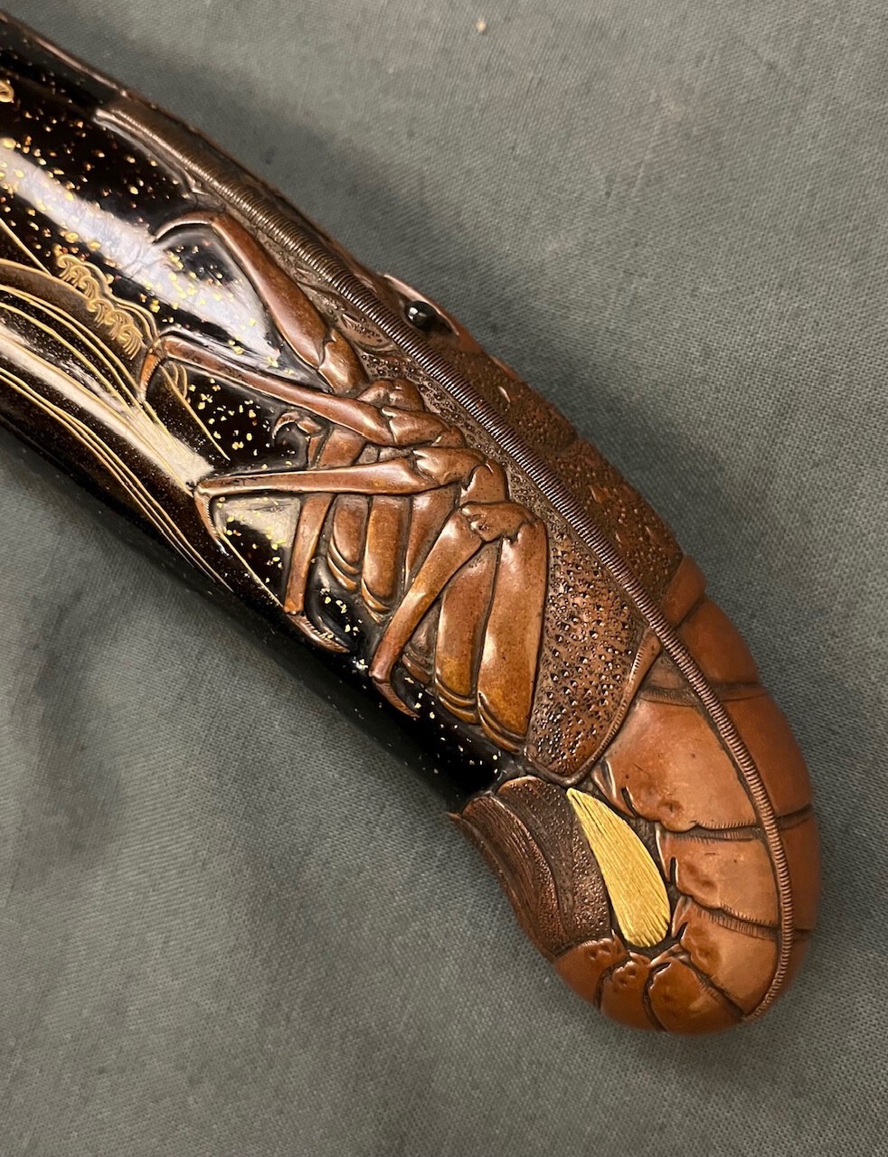

Bugyotsuji Posted February 11, 2024 Report Posted February 11, 2024 This is the Tantō Koshiraé in question. 1 3 1 Quote

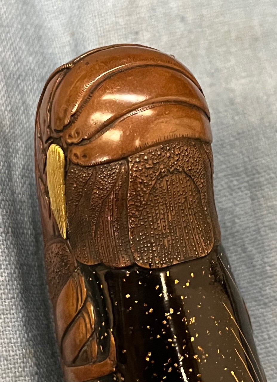

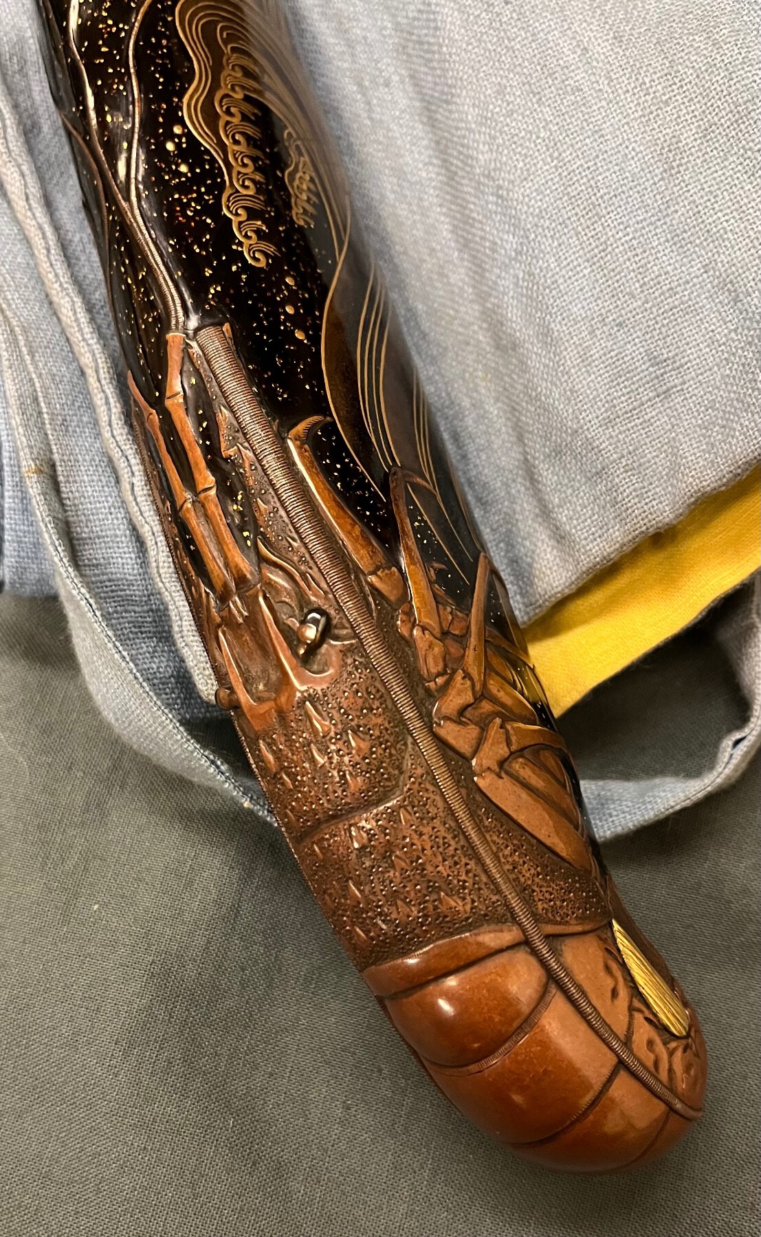

Bugyotsuji Posted February 11, 2024 Report Posted February 11, 2024 From the top, but notice also the attention to tail detail in an unseen position underneath! Top Underneath The Kozuka slot lacquer artist Mei 3 3 1 1 Quote
