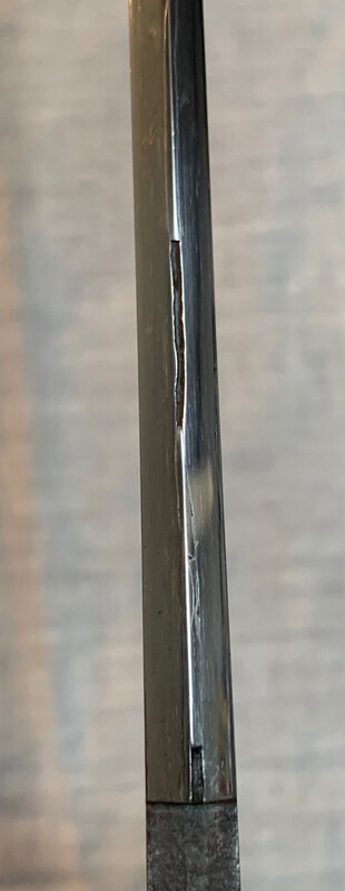

Bugyotsuji Posted October 18, 2023 Report Posted October 18, 2023 The missing sections along the mune. 2 Quote
ROKUJURO Posted October 18, 2023 Report Posted October 18, 2023 On 10/18/2023 at 7:43 AM, Bugyotsuji said: The missing sections along the mune..... Expand This is probably caused by the blade's construction. The KOBUSE or HONSANMAI build-up sometimes reveal an incomplete weld in the back side (= MUNE) which may show as a simple folding line or crack (it isn't a crack in fact). If the TOGISHI decides that the flaw is too deep, he may just leave it this way. The other solution would be to reduce the MIHABA considerably in an attempt to make it disappear. 3 Quote
PNSSHOGUN Posted October 18, 2023 Report Posted October 18, 2023 Very interesting Piers, it looks uniform enough to suggest Umegane were there before? 2 Quote

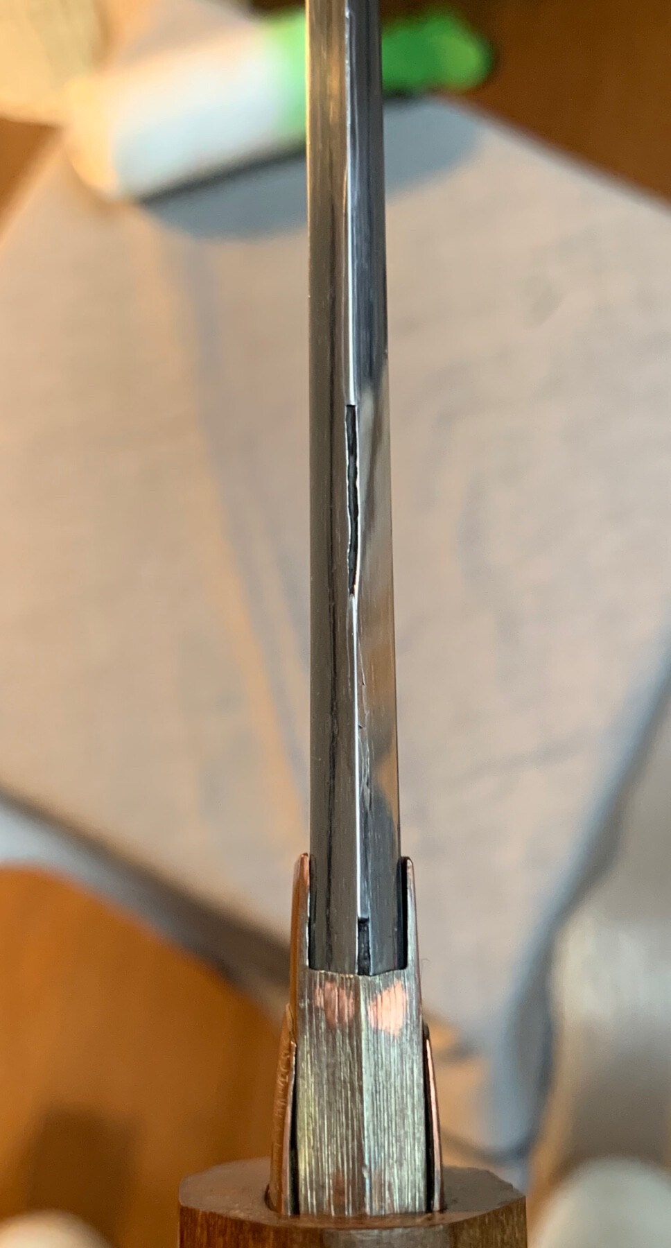

Bugyotsuji Posted October 18, 2023 Report Posted October 18, 2023 Thanks for the replies and thoughts. I tend to agree with both. I have had the 'trenches' back-filled, and now plan to contact a willing Togi-Shi. Left facet of new mune, (habaki pulled back) in rough state Right facet, pre togi 4 Quote
Bugyotsuji Posted October 18, 2023 Report Posted October 18, 2023 Interestingly, following Jean’s post above, I found a faint line right along the top of the Nakago! (Luckily the sheep stayed still long enough to enable the shots.) 4 Quote

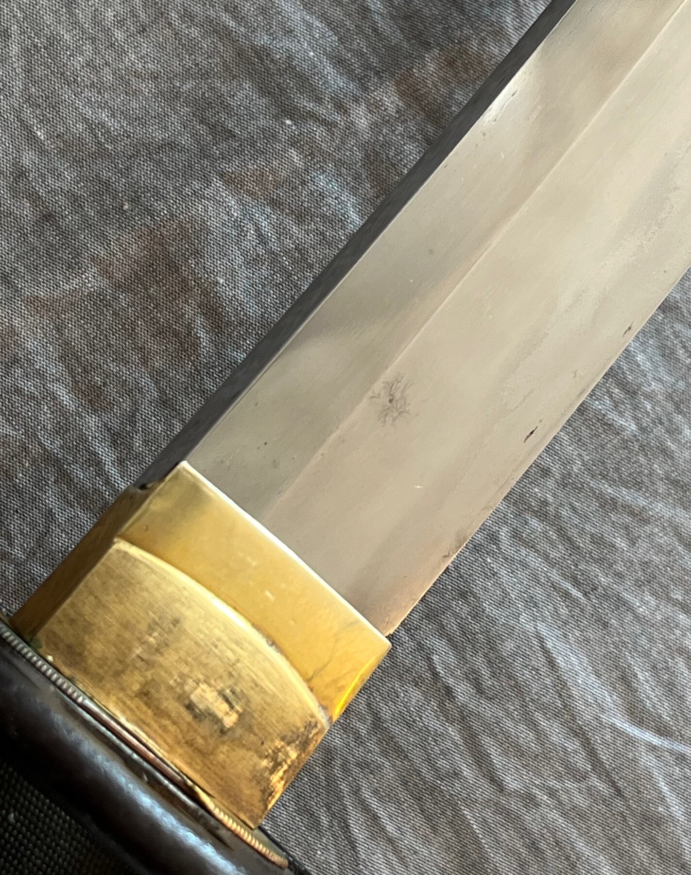

Bugyotsuji Posted October 29, 2023 Report Posted October 29, 2023 Today we had an interesting meet to see some of the Hōnō blades in a large shrine nearby. The Kan-nushi explained that these blades had all been offered to the gods at various times and that we should enter into the same spirit when viewing them. My feeling was that those smiths who gave their blades must have been quite satisfied and confident in their work. During the meet, I had the polisher look at the umégané job above on the Sukesada blade, and he has agreed to polish the recently filled section. (Something to look forward to.) As to the other mumei wakizashi in mounts, he said that the polish is not an immediate concern. Despite some discolourings and one ‘spiderweb’ rust(?) nest, he and a smith who was watching both agreed that it will clean up with other methods, short of Togi work. Use oil and alcohol (ethanol?) alternatively to lift and shift it, and clean it off with uchiko they said. “But the hiké cannot be helped…” The blade itself has been a mystery to me but today there was a suggestion to look at Shintō 因州 In-Shū 兼先 Kanesaki and narrow it from there. 1 1 Quote
Bruce Pennington Posted October 29, 2023 Report Posted October 29, 2023 On 10/29/2023 at 11:57 AM, Bugyotsuji said: Use oil and alcohol (ethanol?) alternatively to lift and shift it, and clean it off with uchiko they said. Expand Any idea how to do this? What is the process? 1 Quote
Bugyotsuji Posted October 29, 2023 Report Posted October 29, 2023 On 10/29/2023 at 3:14 PM, Bruce Pennington said: Any idea how to do this? What is the process? Expand Well, yes, absolutely. I was given so much advice yesterday that I could not absorb or visualize it all. Standing in a large tatamai mat room with not a bottle, cloth nor tool in sight. When the togishi gives back the first blade, possibly at our first sword appreciation meet next month, we have already agreed to discuss the second blade after any intervening further thoughts, and thus what to do or how to take it further. His feeling was that it did not need any intervention with stones., that the polish was/is good enough as it is. I will make sure to ask him again, Bruce, exactly what they were trying to describe. In an ideal world I would love to watch them working on it with these substances before trying it out myself. I even got a sense that the kaji was describing localized spot treatment with oil to 'lift' the little verruca spiderweb marking (rust? mold/mould?), and then to hit the oil with, what did he say, the opposite, (acetone, ethanol?). I do not have either of the latter, so I cannot go wrong. Watch this space. In the meantime last night I oiled this blade for the first time since I've had it. I removed the oil normally with soft tissues, then gave it a light uchiko course, and finally oiled it lovingly once more. Most but not all of the second oil I again removed before resheathing it. He did say something about soaking, I recall now, making sure the oil worked its way into the steel, which gave me a momentary 'spongy' image! 1 Quote
Bruce Pennington Posted October 30, 2023 Report Posted October 30, 2023 On 10/29/2023 at 11:27 PM, Bugyotsuji said: Bruce, exactly what they were trying to describe. In an ideal world I would love to watch them working on it with these substances before trying it out myself. I even got a sense that the kaji was describing localized spot treatment with oil to 'lift' the little verruca spiderweb marking (rust? mold/mould?), and then to hit the oil with, what did he say, the opposite, (acetone, ethanol?). I do not have either of the latter, so I cannot go wrong. Expand I have heard, ever so briefly, that using alcohol can help remove stains. Now, reading your post, I see that there is an oil/alcohol technique for removing spider-webs. I have never read/heard what the process is, and was hoping you knew. I have blades with spider-wegs and black stains, both either and both. Hoping to learn how to really use this process. 2 Quote
Brian Posted October 30, 2023 Report Posted October 30, 2023 Evaporust. Won't damage the steel, but will remove the rust. But it will remove any patina or chemically applied finishes, so keep it away from anything else. 2 Quote
Bugyotsuji Posted October 30, 2023 Report Posted October 30, 2023 Thanks Brian, I'll look into that. Quote
rematron Posted October 30, 2023 Report Posted October 30, 2023 On 10/30/2023 at 5:59 AM, Brian said: Evaporust. Won't damage the steel, but will remove the rust. But it will remove any patina or chemically applied finishes, so keep it away from anything else. Expand And this is okay to use on nihonto? Quote
Brian Posted October 31, 2023 Report Posted October 31, 2023 I am NEVER going to wholeheartedly recommend any non-traditional method of cleaning or rust removal. But for ONLY very out of polish blades with active rust (Keep it AWAY from the nakago) Evaporust will remove rust, yes. It will leave pitting showing though, and get down to bare metal. It will remove bluing and patina that was applied, so keep away from your blued firearms. Does nothing to the metal, and is harmless to skin. I think it's application (for me mainly) is old knives with rusted blades. Again, not an endorsement. But it's wonderful on old tools and machine parts. 1 1 Quote
Stephen Posted October 31, 2023 Report Posted October 31, 2023 On 10/30/2023 at 5:17 AM, Bruce Pennington said: technique for removing spider-webs. I have never read/heard what the process is, and was hoping you knew. I have blades with spider-wegs and black stains, Expand Not sure of what your talking about spider rust can't be wiped off with anything need to have a polish As are most black stains unless old oil Quote
Bruce Pennington Posted October 31, 2023 Report Posted October 31, 2023 On 10/31/2023 at 11:14 AM, Stephen said: Not sure of what your talking about spider rust can't be wiped off with anything need to have a polish As are most black stains unless old oil Expand I suspected as much, but I was refering to Pier's post, 8 posts up from yours - "As to the other mumei wakizashi in mounts, he said that the polish is not an immediate concern. Despite some discolourings and one ‘spiderweb’ rust(?) nest, he and a smith who was watching both agreed that it will clean up with other methods, short of Togi work. Use oil and alcohol (ethanol?) alternatively to lift and shift it, and clean it off with uchiko they said. “But the hiké cannot be helped…” But after re-reading, the "lift, and shift...and clean it off" must have been refering to some active rust and not the spider web. Right? Quote
Bugyotsuji Posted October 31, 2023 Report Posted October 31, 2023 No, there is no active rust that I can see except this one small circular wart-sized ‘web’ which could be mo(u)ld or anything. It looks fainter already after the simple double-oiling process above. Ideally, I’d take some photos, but the family are all here and demanding this and that and to be taken here and there… and I collapse into a heap each time they’ve finished with me. Let’s wait for further updates on this. 1 Quote

Bugyotsuji Posted November 6, 2023 Report Posted November 6, 2023 And sometimes you need a little advice, and then a little faith. The spider in the other wakizashi blade does indeed seem to be fading under repeated oilings and Uchiko. Now trying to get a focus on it with the camera, and it’s hardly possible to even see it! (Normally I would definitely not recommend liberal rubbings with Uchiko.) Before After (so far) 4 1 Quote
Bugyotsuji Posted November 8, 2023 Report Posted November 8, 2023 PS Re the above, when I used the words 'repeated rubbings', I did not mean 'localized' rubbing solely over the damned spot, (to quote W. Shakespeare). I have tried to distribute any uchiko rubbing equally overall: nothing frantic or overdone. Oh, and an added word of wisdom that I heard the other day when discussing the new tsuka-maki job and how much I admired the guy's work. Mr Akamatsu, a swordsmith who is active in both blade and koshirae work, and a fountain of anything historical, said to me, "People tend to worry about whether to keep the perished tsuka-maki or to have it restrung. Many do not realize that during the Edo Period it was part of the yearly cycle to renew the old stringing on the hilt every New Year." 4 Quote
