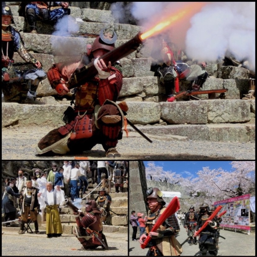

Bugyotsuji Posted April 7, 2022 Report Posted April 7, 2022 Photos from Sunday 3rd April 2022 at Tsuyama Castle Cherry Blossom Festival. Mr Koiké the NBTHK sword sensei in red, firing the 100 Monmé repatriated from Ireland. 26 kg. His armour came from the Tsuyama Castle armoury. https://teppoutai.com/t15.html 6 1 1 Quote
Shugyosha Posted April 7, 2022 Report Posted April 7, 2022 Hi Piers, That looks like a heck of a muzzle flash. I’m assuming the charge is reduced compared to that which would be used if it were loaded with a ball? How much powder is used? Sorry if I’m asking silly questions but I know next to nothing about firearms. 1 Quote
Bugyotsuji Posted April 7, 2022 Report Posted April 7, 2022 Well, I did not see exactly how much they gave him but it would have been a minimum of 80 grams of blackpowder. (I loaded my 50 Monmé with 50 grams and it very nearly knocked me over.) 2 1 Quote
John A Stuart Posted April 7, 2022 Report Posted April 7, 2022 80 grams? I measure my powder in grains. 80 grams is over 1200 grains of BP. Wow! John 1 Quote
Bugyotsuji Posted April 7, 2022 Report Posted April 7, 2022 Thanks for the clarification, John. They do not use the 'grains' measurement here, only grams today. You may have noticed that we strap our left hand to the barrel with the bigger 'hand cannons'. (You can also see some shots of my part in the link above.) I have heard that in battle these big guns were placed on rice bales, and restrained in various ways, and depending on the circumstances even allowed to fly backwards onto a pile of futon or into freshly dug earth or mud. At first it was only iron or lead ball that was used, until it was found (possibly around the seige of Osaka Castle) that a kind of iron-headed flaming bolt called a bohiya 棒火矢 was quite effective at smashing through a castle roof and setting the structure alight. 3 Quote

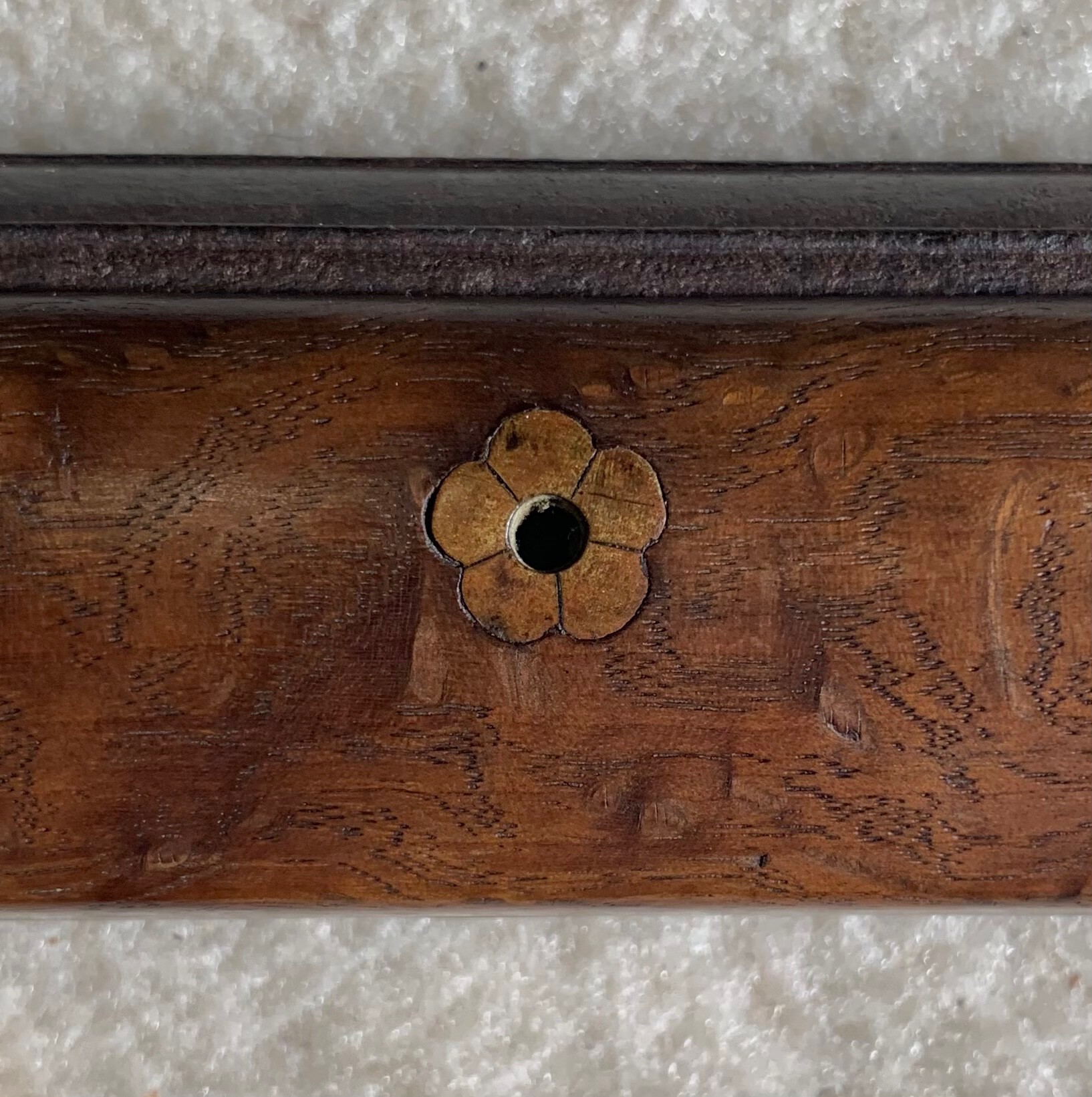

Bugyotsuji Posted November 10, 2022 Report Posted November 10, 2022 Out of boredom I decided to make a mekugi -za or seat/surround for a Teppō. There should have been 11 perfect ‘plum’ (Japanese apricot) flowers in copper, but 4 are missing. I wondered if each one could have been made by hand, but after 4+ hours trying to make just one, I realized that artisans doing the decorative inlay must have had drawers full of ready-made designs. Flowers and petals are perfect by nature; the original master design in metal must have been perfectly created only by trial and error. After four or more hours work at the kitchen table this is what I have made, just one. Not even worth using! (Toothpicks are for size comparison). Some teppo have no decorative inlay around the mekugi-ana, just plain holes in the stock wood. A much quicker and easier option. 2 Quote
Viper6924 Posted November 10, 2022 Report Posted November 10, 2022 You never know until you try it 🙂 I actually checked the matchlocks in my collection. Out of the 12, 6 had only plain holes for the mekugi. These 6 guns comes from all over Japan, so there’s no regional preference for one or the other. Jan 1 2 Quote
Bugyotsuji Posted November 11, 2022 Report Posted November 11, 2022 I’ll check mine when I get home, Jan, but I’m expecting roughly the same results. 7 hours later. Three of mine have no round or decorative metal lining washers of any kind for the mekugi holes. (I seem to recall a comment of Sawada suggesting that larger round washers/surrounds are indicative of older guns.) Quote

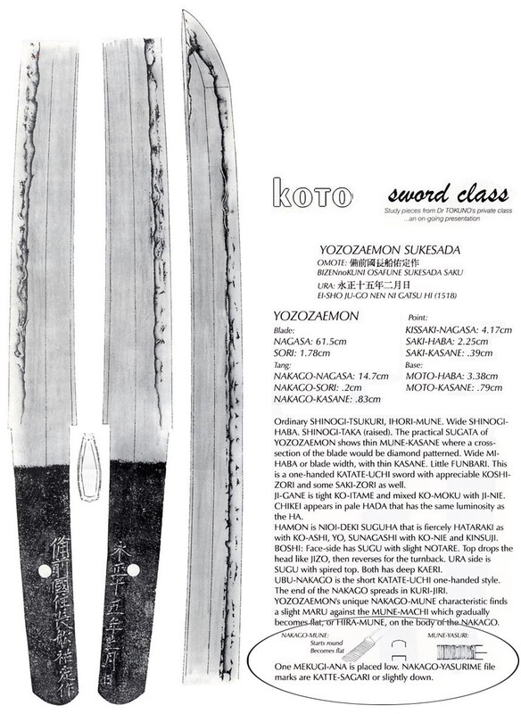

Bugyotsuji Posted January 19, 2023 Report Posted January 19, 2023 That's interesting, John. Could we say then that there were at least three visible threads with these late Muromachi Sukesada smiths, a) swords made on commission with a long date and signature, b) swords made with a date and a short Mei, e.g. Bishu 備州 Osafune Sukesda (no 備前 Bizen, 住 ju or 国 kuni/koku), and c) kazu-uchi mono, rush/mass produced for the battlefield? Could these be refined further? Also I am aware that there is some arcane rule about where 国 and 住 are placed in a 備前 Bizen signature, wrong order being an indication of gimei. 2 Quote
DoTanuki yokai Posted January 19, 2023 Report Posted January 19, 2023 I think in most cases the kazu uchi mono are around 63cm long and a date is always a good sign. http://world.seiyudo.com/product/ka-100122/ Bishu Osafune Sukesada Saku with Date Tensho 12 And only Bishu osafune Sukesada without a date. Not saying I have solved any questions about Kazuuchimono I also think the difference in photo setup don’t really allow to compare. 1 Quote
Bugyotsuji Posted January 19, 2023 Report Posted January 19, 2023 So kazu-uchi mono are only katana? Quote
DoTanuki yokai Posted January 19, 2023 Report Posted January 19, 2023 I’m not at home but from memory I think Nagayama wrote that they are signed “Bishu Osafune Sukesada” have a Gunome Hamon and are around 63cm long. From this i think they are most likely katateuchi. But my own impression is that the kazu uchimono has a big variation depending on the smith (Sukesada) who made it. The 3rd Sukesada I posted is only an ubu 46cm Wakizashi and I would say it is a kazuuchimono. Suguha based with some Bo utsuri but the Ashi are few and look randomly placed. Then there is small Kinsuji and some frayed nie but not really following a pattern. Nice to look at but miles away from the ordered works of Hikobei, Genbei or Yosozaemon. Now comes the romantic dreamer part. My Waki got the Nakagomune like it is described and the raised Hamon at the Yokote and bright Ha. So it could be a Kazuuchimono made by Yosozaemon Sukesada. But I’m not stupid (I think) and I’m sure the NBTHK does not paper them Yosozaemon if it is not on the Nakago. Also there is a kazuuchimono Meito Atakigiri 2 Quote

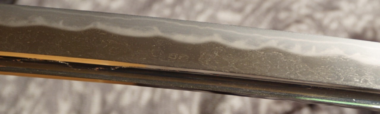

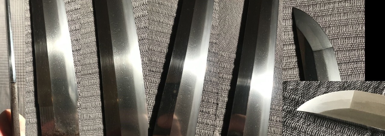

Bugyotsuji Posted January 19, 2023 Report Posted January 19, 2023 I just looked up Sukesada who signed short like that, and who produced known swords in early Tenbun, or in the preceding Taiei/Kyōroku (1521-1532). Maybe I should have included late Eishō. Found 12 smith entries and photographed them all! Here’s the first example. 2 Quote

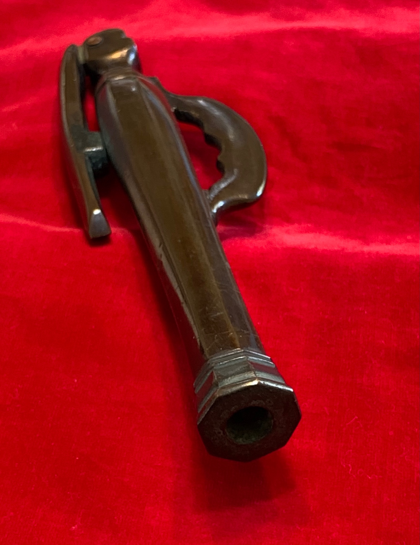

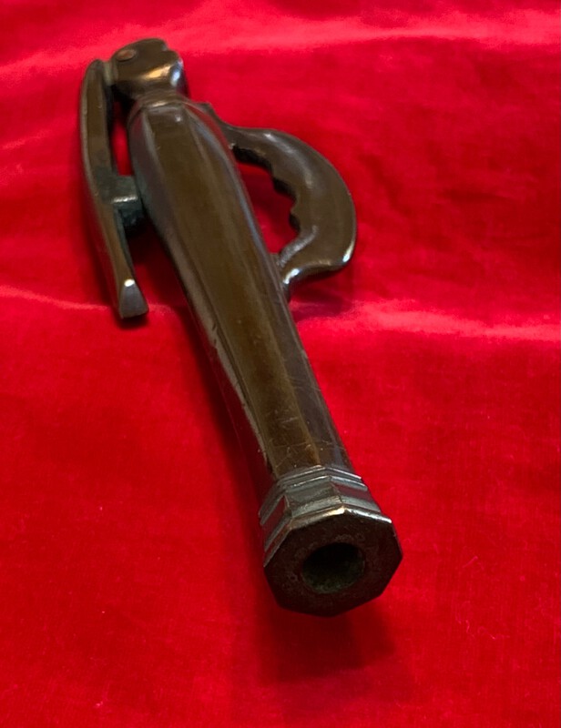

Bugyotsuji Posted January 21, 2023 Report Posted January 21, 2023 A funny thing happened yesterday. Rematron (Jeremy) gave me a like on page 22 of the original old Edo Period Corner thread. "Hey, that's pretty random!" I thought, a bolt from the blue, from way back before memory began. Then I read the next following post(s) there about Nigiri-deppo 握りでっぽう(芥砲銃 Kaiho-Ju, 掌中銃 Shochu Ju or 極密銃 Gokumitsu-Ju), and how rare they are. Ian B picked up on that and the conversation blossomed. They were a kind of pill-lock squeeze-lever gun that was revolutionary back before percussions caps, in a time of matchlocks, possibly a uniquely Japanese contraption. But, but! Yesterday I had just happened to buy one of these, several hours before seeing that old forgotten thread after so many years! Does anyone believe in serendipity? If not, you're missing out! (As always, if you are ever tempted to source one, beware of fakes. According to Sawada Taira, 'many' were made.) 4 Quote
Bugyotsuji Posted January 21, 2023 Report Posted January 21, 2023 These are from Sawada Taira’s green cover Koshiki Jū Nyūmon, 古式銃入門 pp20-23. He also does a good explanation in his b+w big blue Nihon no Furujū 日本の古銃. (For educational purposes.) The one he illustrates here has a safety device which prevents squeezing until the pin is removed. 1 Quote
Bugyotsuji Posted January 21, 2023 Report Posted January 21, 2023 And one clue to fakes is the internal shape of the touch hole 🕳️ wide enough for the pill to sit in, but stepped inwards again to allow crushing of the pill just above the main charge. 1 Quote
Bugyotsuji Posted January 21, 2023 Report Posted January 21, 2023 And the one I stumbled across: 1 Quote
