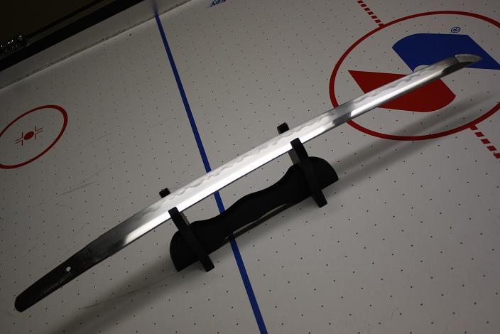

I had another look at the pics and as Paul said, it may be saya rubbing I am seeing along the edge.
It is hard to be sure from these pics, so that is why I raised the possibility of suguba, as a hoso-suguba conrinuing into the boshi seems to my limited experience to be about right for sue Mihara as well as earlier Mihara, more so than gonome-midare with yakidashi. I have not had enough experience with this school to be definite about gonome-midare and yakidashi at the 1550 period however, so I asked the question.
Again, to Brian, these are not criticisms , but (hopefully) helpful comments. From the pics it seems you have found a nice, healthy, signed, late koto sword in quite good polish, so this is a GOOD start for sure (my first sword was a gunto klunker that looked like chrome plating! haha).
So, the nihonto bug having bit...welcome to yeeaars of fun!

I appreciate the advice, and much appreciated.
Yes the sword does have Saya marks from the WW2 Saya it has been stored in, that will be taken care of as I plan on having a Shirasaya built for it, and a two piece silver Habaki built for it also.
Once I have it built, this one will be sent off for papers on it.
Brian

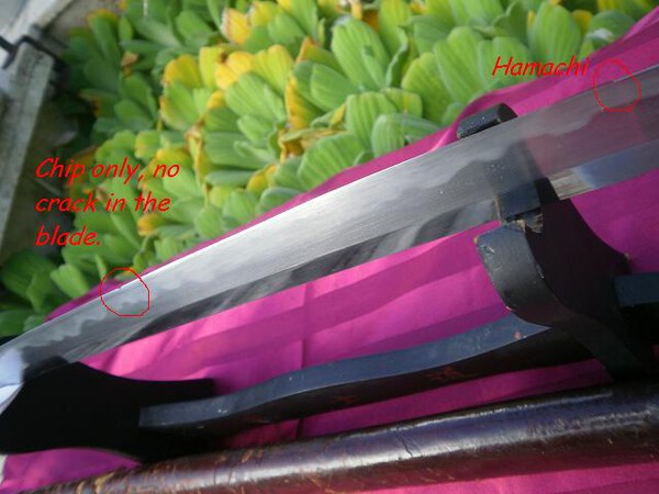

1) Kiri komi needs to be examined more carefully as; a) it does not look like a kirikomi b) this kiri komi - crack of some sort could become a problem when it comes to getting this sword papered.
2) if this is such a good polish where exactly is the hamachi? Which should have been well defined and appropriately placed when the sword was polished. Which in turn may be a problem when it comes to having a new habaki made.
There is no kiri komi, crack in the blade, and the hamachi where the blade begins where the habaki would rest is there, I have one pic of it, it is there, just did not post very good pics of it.
In the one pic, it does look like a crack, it is not you can a dark area just before it, that is the reflection of something, and not a crack, as there is no crack in the blade.
I hope this helps.
Brian
It is what is called currently as hako bore (chip) which can have been caused by anything.

Well Brian, I think it is a nice sword and you will be able to learn a lot by studying it. Even if the school does not rank very high the blade looks very nice and I am sure you will enjoy it.
All the best.
Yes, I will learn from it, and it is a very beautiful blade, and the school part I'm not concerned with at it is true Nihonto, and the best one I have in my collection right now.

But looking at the Kissaki it appears the following statement I copied from Markus Sesko might apply :"  "check the interplay of hamon and bôshi. Is the bôshi a continuation of the hamon or does the outline of the hardening change with the yokote? If so, chances are high that you are facing a shintô work as in kotô times it was more common to let the hamon run out “naturally” into the kissaki."
I know the original post is old. I'm just trying to learn more.
