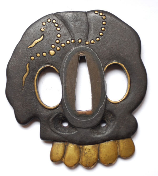

Seller stats its from meiji. I saw the gold issue ,but when its not edo its okay with me. I just love the theme.
Whats with the nakago-ana? Too high , a wide blade?

Have to say I love this theme too. I am guessing these are the sellers photos - do you have a shot of the ura. There are some valid points made above, closer examination will prove of interest. Once you've got it in hand do post some more detail photos.

I think we all agree that the gold is an addition that doesn't belong on this one.
However this style of tsuba is a real one and this skull theme was used, although more subtly. There are a lot of fake, enhanced or sub-par tsuba coming out of Japan nowdays..the flea markets are full of the Chinese fakes we see on eBay. It's not like the old days..if you saw it was from Japan, it had to be ok. Not so anymore. That is a general comment, and not directed at this tsuba.
However it may be that a real late Edo or Meiji tsuba was enhanced here, I am not convinced it is 100% fake. But that is a possibility. You need to have it checked out more. The sekigane are off too, and there appears to be a design issue from what Ford said.

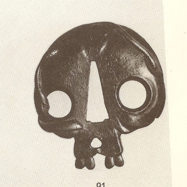

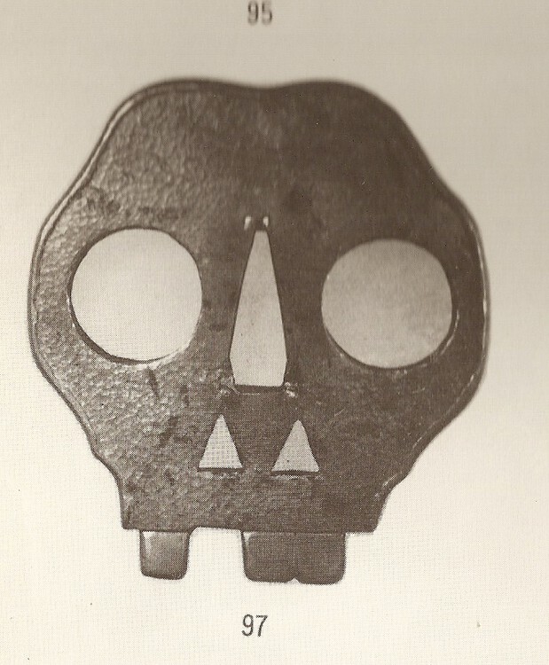

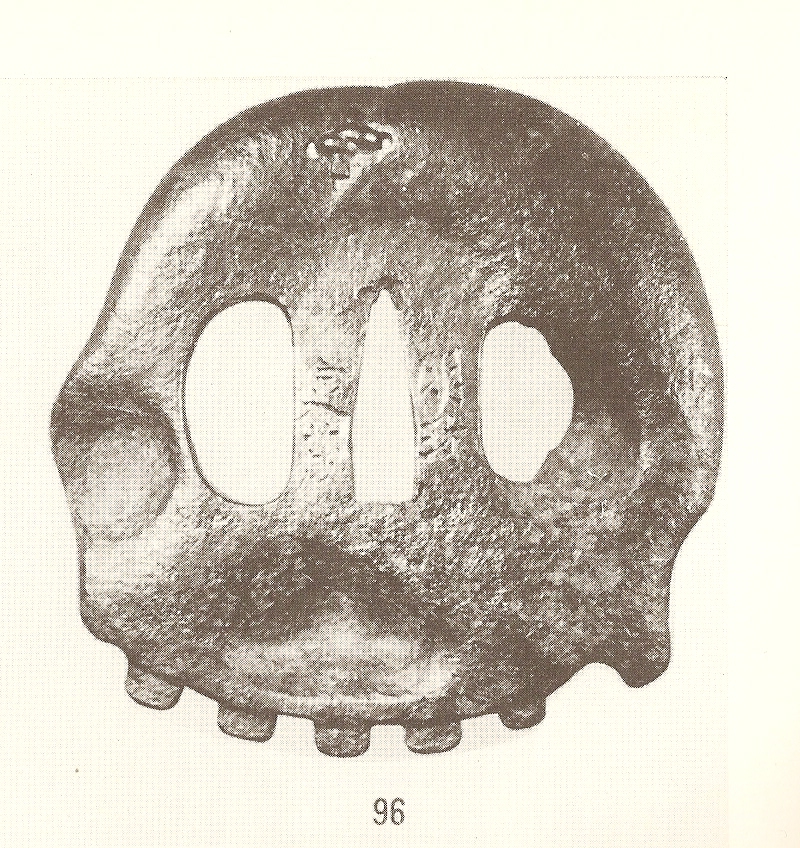

Interesting theme..perhaps someone has a pic of the earlier and higher quality examples for comparisson?

my feeling is that this wasn't made by an Edo period tsuba-ko. I say that because the position of the nakago-ana would place the tsuka off the seppa-dai area quite noticeably and place the tsuba very low when mounted on a blade.
I also find the shaping of the 'nasal passages', in particular, to be a bit similar to the way you can carve/scrape wax but not steel. Overall it just doesn't ring true to me.
It's difficult for us non-artists to picture the ratio between nakago anafuchi/tsuka/seppadai sometimes....
When looking at a tsuba, the ana sometimes seems to be in the right place. Until you take a pic of an average fuchi...size it exactly to match the tsuba nakago-ana, and overlay.
Then I see what Ford is talking about. Placement is way off.

the images you've uploaded lead me to an even more certain conclusion that this is a modern cast facsimile. Sorry to be the bearer of bad news but that my opinion, for what it's worth.
What I took for electroplated gilding is, as others have suggested, merely paint. Paint stripper will quickly prove that I suspect.

If I understand right ,theres no chance it was made meiji time.
Hi Thomas,
no, these sorts of steel castings are relatively recent. They've only really come to prominence with the advent of the internet and a large marketplace in which to pass off fakes on unsuspecting newcomers to the field of tsuba collecting. I think it fair to say that almost every field of collecting is similarly flooded with fakes intended to fool the novice.
