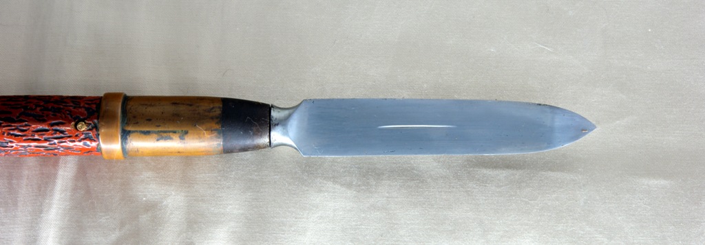

The Uchine reminds me a little of the Plumbata arrow in use by the late 2nd -4th century AD Roman army which was a vicious hand thrown weapon :
Also the lengths of the blades do not seem to be so different
Top is a spearhead, bottom plumbata head.
Note: in Cm.

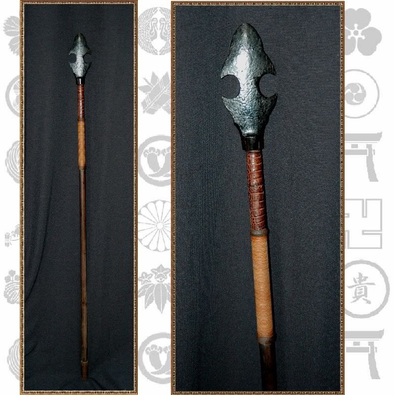

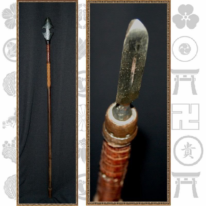

Never stated it was a genuine masterpiece. I stated it fit better the "palanquin yari" description.
Everything in that Yari looks new and the blade looks very poor in front of the mounting. The Hadome is a not functional, cathing-eyes addition.
However, *this* is how palanquin Yari should look like.

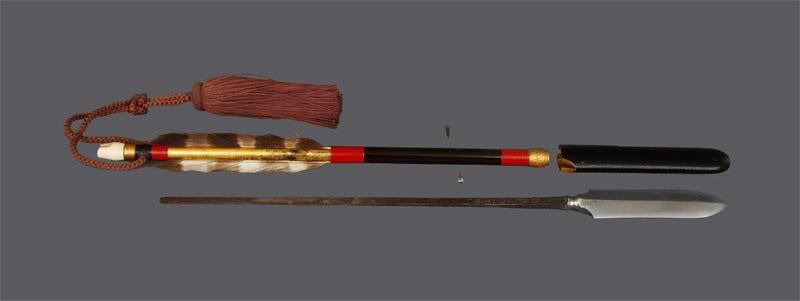

Heres a mounted yari that is only 46" long - blade is 4 1/2" so maybe it is one of the smaller kind for inside a palaquin
Hi Doctor. Seems we share the same pics database :) .
Guess I mixed up some pic as last one belongs to the yari you post . Sorry.
Not sure the "standard" Ishizuki in your pics belongs to Kago Yari mount. But it might be smaller than I suppose. :dunno:
That is around 4 ft or about 1.3 meters, still fairly long for a Palanquin spear I would think, just judging from the few Palaquin interiors I have seen. Here is another yari of the same size. An older blade refitted at some point in time. I have read that this size yari was used as a household weapon, and that the ones for use on a horse would have a loop attached to the pole at some point to secure the yari from dropping, any info on this?

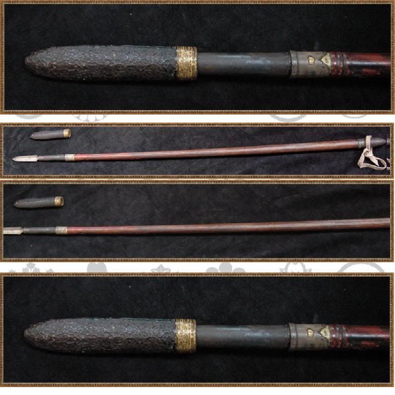

Two more yari, these are being labeled as "kago", any thoughts? http://s831.photobucket.com/albums/zz23 ... ?start=all
Superb antique kago yari with fukuro tip, signed Nobukuni. It has a very nice wooden pole with a nice patina and great iron ishizushi. It also has a saya protector for the blade and is in terriffic condition. size: cutting edge: 10cm total blade: 20cm mounted: 127cm
Size:135cm Theme:Kago Yari
Material:Iron wood snake skin
First one maybe........ looks 'Japanese' on the surface at least. Second one very suspicious......possibly Indonesian African or a straight up fake. The tip looks as if it could be anything but Japanese. I wouldnt really trust either of them to be honest, at least not without a lot more pictures of the stripped down weapon. The second one looks as if it has a fixed blade, and If it cant be stripped down to reveal the nakago then it aint Japanese is it?
Agreed with sanjuro's opinion above.
The first looks like it has been reassembled, cobbled together somehow. The E looks cut down. The Saya looks genuine. The Ishi-tsuki is hard to see, but it looks modern to my eye.
No idea what the second is supposed to be.
As with a Kago-zutsu, (Kago gun) any weapon carried in a proper Norimono (Kago) would tend to have been of beautiful quality and decoration, as befitted a Daimyo, etc. Eg lacquered haft, etc.
The Ishi-tsuki is hard to see, but it looks modern to my eyes
These are or were in Japan, just examples of what is being called "kago" yari. I have no idea about the second one either, looks like some hill people got a hold of it. The first one is hard to figure out, enough real parts to leave some doubt. The cord going through the ishi-tsuki is what I have seen being referred to as a yari meant for use on horse back, no idea if that has any truth, maybe someone else does.

Any more detailed pics of the first yari blade and nakago (or is it a hoko style)? I'm starting to believe this may just be a half decent Mid Edo horseman's yari. The ebu is sixteen faceted which is reasonably swish. The ishidzuki seems to be a plain edo period piece but good quality, as does the saya and the reinforcing mounts at the mouth of the ebu. Its possible this one might be OK.

Keith, you saw the faceted pole to, very interesting. I wish there were more pictures, I posted every picture that I saved on my photobucket, I did email the person who owns or owned it a few weeks ago to see if there was any more info or pictures of it, they had just returned to Japan right after the earthquake and were quite upset, they said they would let me know when things settled down, I will post any pictures that I do get in the future.
This shows why it is so hard sometimes to verify the authenticity of objects, with out really good photographs of the right parts it is almost impossible sometimes short of actually having it in hand to be certain that you are not being fooled.

I was wondering if there was a chance that the second yari pictured was maybe an Ainu item or something for hunting?
Piers.
I think they are the same. The full length picture has a bit of a stutter at the end of it where it was cropped and part of another picture has intruded on the image, if you blow up the picture and disregard the lousy cropping, it appears to be the same as the larger version that Eric posted.
Eric.
The second yari...... Was what we were shown originally a yari with its saya on and this latest picture has the saya removed? If so, then its an entirely different kettle of fish. The last pic looks like a real yari blade but in a very second rate mounting, possibly a cobbled together job.
Eric.
I dont know keith, it has a unusual look for sure but maybe made for a purpose? And it appears to have some age.

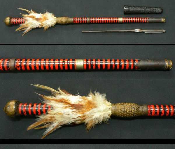

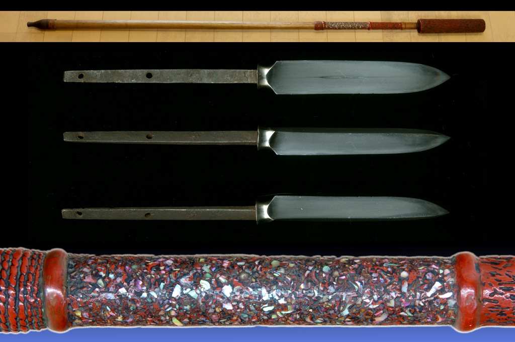

As for the one that Carlo thought was more like an uchine..on close inspection maybe not?

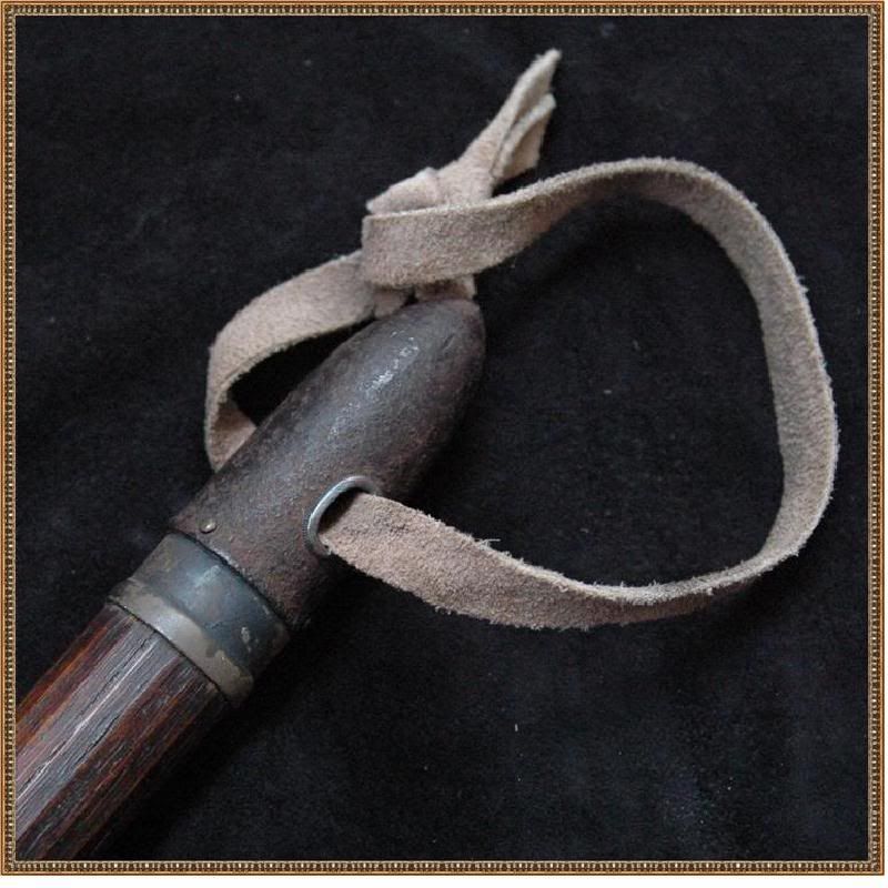

This picture looks like the end was made for thrusting.
Compare this to the uchine underneath it. Approximately 79.3cm long 拵全 lance body
Not a uchine.... at least not identifiably so, but Carlo has a point that it has the look of a javelin like weapon. But fluff and feathers do not alone make an uchine. The shaft length and the butt being grooved across to accomodate a cord would be expected on an uchine.
The grooved butt on this last photograph looks like it may have been intended to be inserted into something hollow. (rifle barrel????????) like a plug bayonet. The damn thing reminds of an Asagai. Cant really say for sure, mostly because it looks like some sort of hybrid weapon. Snake skin makes me think African. I dont recall having seen a snake skin covering on anything Japanese. Isnt there some sort of negative connotation concerning snakes in Japanese mythology? Whatever it is, I dont think its Japanese/Ainu/Emishi in origin. I cant really add much more than this in the way of enlightenment.
One thing puzzles me.... Are the last two photographs posted previously of the same weapon, one with saya on and one with saya off? Or, is that horrible thing with the circular cutouts in it, the blade itself.

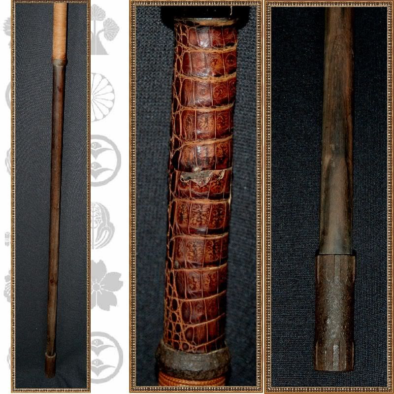

What I was saying about the small yari is that it is of a SIZE that would actually fit inside of a Palanquin. It is in Japan and is labeled as having something to do with Palaquins. I do not think that a 4 foot long yari would really work inside those rather confined quarters.
The object with the cut out areas is the saya. By the way, that may not be snake skin. I have had reptile skin items before and it looks like a type of Crocodilian skin not snake skin.
Ah! the mist clears...... So we have an apparently Japanese blade mounted in an unjapanese style.
Although I still doubt its ethnicity, it appears then to be a bit of an odd ball.
