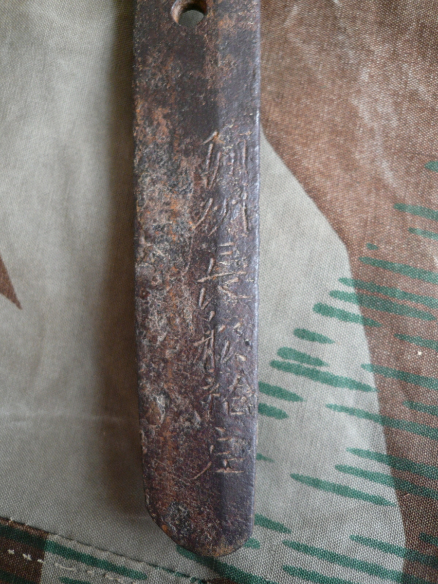

Arnaud, The characters on the reverse of your blade's tang is a date. It has to be Taiei (1521 -1528) something ? bit I cannot make out the numerals which indicate which year within that period. Since the signature itself is simply the address and the name, it doesn't really give many clues as to which of the many Sukesadas might have made the blade.

I think the question is far less about what Sukesada is this, but much more is this a genuine Bizen Osafune Sukesada blade? As I am sure you have found your Hawley's by now, you realize that will be a daunting task as there are dozens that signed that mei. Perhaps photos of your blade may help those more knowledgeable than me to eliminate some of the contenders (or potentially all of them).
Dear Arnaud
Date looks to be
大 Tai
永 ei
二 or 三 ni or san (2nd or 3rd)
年 nen (year)
二 ni (2nd)
月 gatsu (month)
日 hi (day)
As Ian stated Taiei is the period that started 1521.
So this sword might have a date of either 1522 or 1523
on one day in the 2nd month.
You can take this email and print then set the kanji next to the nakago and see
what you think.
Good luck and have fun
later
david mcdonald
Greetings,
From the way it's signed, there is a big chance that it is Kazu Uchi Mono. These swords being "mass produced," are usually not attributed to one particular Sukesada.
Agree, a shinsa would be able to determine if this mei was an acceptable "school signature", based upon the workmanship of the blade.
