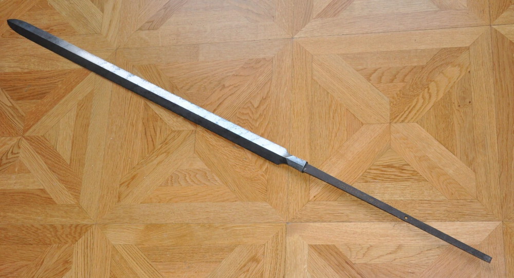

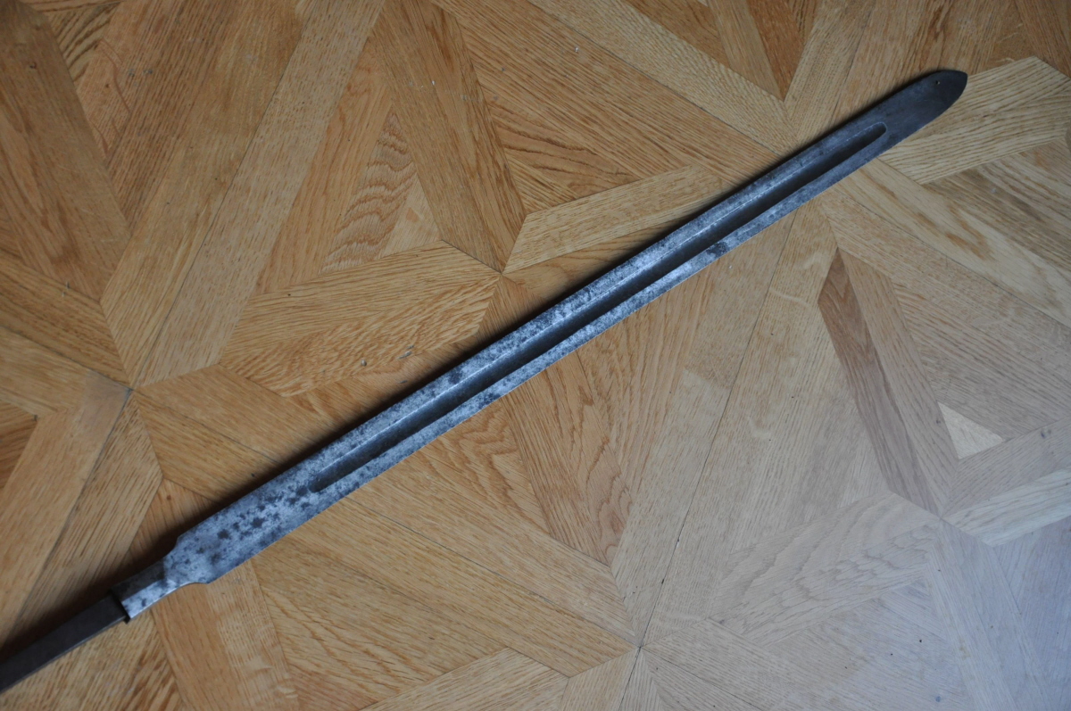

EricM Posted March 14, 2010 Report Posted March 14, 2010 Dear all, I came accross this nice omi-yari (80cm nagasa / 38 cm nakago - I guess the nakago as been cut a few centuries ago). As as I am not familiar with omi-yari, I did a few research on internet and you have 2 different schools, some say omi-yari were for high ranking samurais, other say it was for low ranking foot soldiers. What do you think? It is signed though I don't know if the signature is genuine and I would say beginning of 17th century. Would you say it is koto though? Do you think it is worth having it repolished or is it better keeping it like that? Due to its size, I guess repolishing + habaki + shirasaya will be in the $3000 range... Thx for your comments http://img693.imageshack.us/img693/7599/dsc0416mk.jpg http://img202.imageshack.us/img202/3706/dsc0413z.jpg http://img641.imageshack.us/img641/963/dsc0409a.jpg Quote
John A Stuart Posted March 14, 2010 Report Posted March 14, 2010 It seems to be Izu no Kami Daido Saku. 伊豆守大道作 I don't know a Daido that signed this way. John Quote
Toryu2020 Posted March 14, 2010 Report Posted March 14, 2010 Eric - I agree with John on the reading - however there are at least 20 artists that signed Daido and according to the Nihontoko Zenshu the Mino ni-dai and san-dai both used Izumi no kami. I have no references for Mino smiths so cannot help with examples for comparison. Whatever it is its a neat find... -t Quote
John A Stuart Posted March 14, 2010 Report Posted March 14, 2010 The Izumi no Kami Daido 和泉守大道 (Hawley's # DAI31) was a contemporary of Izu no Kami Daido 伊豆守大道 and both are of the Kanbun period, the Izu smith is Hawleys # DAI27, a 3rd generation smith from Mino. John Quote

EricM Posted March 14, 2010 Author Report Posted March 14, 2010 thx for your help on the translation any idea if it was for high ranking samurais? is it worth having it repaired due to the cost in your opinion? thx Quote
John A Stuart Posted March 14, 2010 Report Posted March 14, 2010 The yari was the king of non-projectile weapons on the battlefield carried by ashigaru and higher ranks of samurai. Even after the advent of teppo-ashigaru units there were units of ashigaru with polearms, slings, sekikyu (石弓) and yumi seconded to them. I don't think there was any rank distinction given the right circumstance. John Quote
