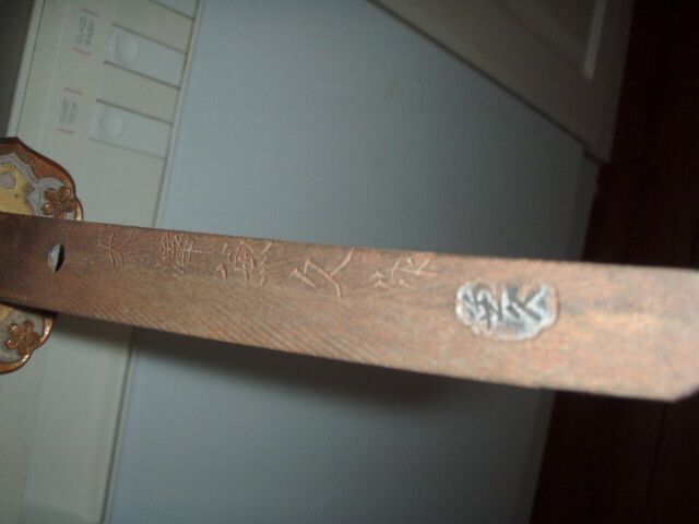

velma1982 Posted October 30, 2009 Report Posted October 30, 2009 Hi Can anyone help me understand the characters of this sword. Quote
John A Stuart Posted October 30, 2009 Report Posted October 30, 2009 Isn't that interesting? Another Kanehisa and with kokuin. John Quote

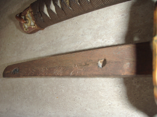

Grey Doffin Posted October 30, 2009 Report Posted October 30, 2009 "Ozawa Kanehisa Saku" with a Kokuin. Which means, made by Ozawa Kanehisa, and kokuin is a personal seal. Grey Quote
velma1982 Posted October 31, 2009 Author Report Posted October 31, 2009 Thanks The info was really helpful as i dont have any ref boks as yet as the sword has been passed down from my father only recently he got it from his father after the war. Any more info would be greatly appreciated like dates province etc. Quote
Nobody Posted October 31, 2009 Report Posted October 31, 2009 To be accurate, the name reads Ôsawa Kanehisa (大澤兼久). He was one of WWII smiths in Seki. Quote

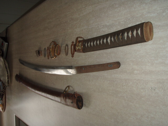

velma1982 Posted October 31, 2009 Author Report Posted October 31, 2009 Thanks for the reply, Can you tell me if it was a hand made blade and what it would be worth for insurance purposes also i have left the rust on the blade etc as i dont know if i should clean it or not i have heard it would take away the history of the blade? If the rust was left on would the characters and blade deteriorate and ruin the sword? Also should the blade be oiled and if so what type should i use and how should i apply it to the sword? Quote
Grey Doffin Posted October 31, 2009 Report Posted October 31, 2009 Hello, Do not try to remove any rust; never, ever. Don't try to fix anything that you think needs fixing; you're much more likely to do damage than good. Here is a link to a sword care and etiquette web page that should answer your questions: http://www.nbthk-ab.org/Etiquette.htm Grey Quote
cisco-san Posted October 31, 2009 Report Posted October 31, 2009 I think it is a not traditional made blade --> typical Showato. Quote
