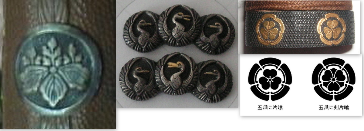

Hi all,
I have 3 kamon that i would like to identify but i was not able to find them.

-for the kamon on the left, I did not found any kamon with space between each leaf like that and with a circle around. The kamon I found with space between each leaf, have nothing inside the leaf.
The kamons that look like the more are the Shinagawa and Satake ones.
-for the kamon in the middle, the "seki" kamon looks a bit like it but I don't think it is the one
-for the kamon on the right, I found one kamon (on the last website) which looks to be the good one but I am not able to translate :(
Any help welcome to find these kamons !!

The first is Go-San Kirimon, a very common mon used early on by the Toyotomi and then adopted by many of the Matsudaira and Tokugawa families and their relatives, and their housemen. Post-1600 there was the Go-Shichi kirimon which featured a stalk of seven cebtral flowers and five on either side, yours is the earlier version with five (GO) and Three (SAN), possibly suggesting an earlier family. the space between the leaves may be a function of the material it is made from rather than a distinct version of this mon.
The second is Maru-ni-Tsuru and while there were historical mon featuring a crane in a circle I believe this example if more of a design motif as seen in tsuba and other places.
The third is a nice example and you are correct in thinking the version on the left matches your fuchi. It is read Go-Ka ni Katabami. Ka (瓜) or Uri is a melon leaf and 5 form the circle while the central flower is Katabami or wood sorrel.

The Katabami on the right of the right is "Ken Katabami", ie unlike yours it has sword blades between the petals.
The center design of the Katabami mon is not a flower but leaves of wood sorrel.

Essentially this three-hearts-leaved plant was loved by farming folk, but as it began to be used by Bushi it became popular to have the blades inserted. Ladies continued to prefer the non-bladed Mon version. It was used by powerful families who lost out to more powerful ones, so it had a sort of run of bad luck. Nagasogabe Shi (Chosogabe-shi?) of Tosa ruled the whole of Shikoku and used this Mon, but he was crushed and reduced back to Tosa by Toyotomi Hideyoshi. Later Tokugawa hammered him as he was subservient to Hideyoshi. General Ukita Hideie of Okayama in the Western army used it at the battle of Sekigahara, but he was banished and died on the island of Hachijojima. According to the author it retained a grass-roots popularity and was eventually perhaps the third most used Mon country-wide.

I feel that trying to tie a single mon from a single item to a single family with no other evidence is a fruitless exercise unless the mon is really unique. So many families adopted the mon of their lord and then adapted it in later generations it is almost impossible to trace one of these badges to a particular group.
The Go-ka (or is it Isutsu-ka?) ni katabami is rather unique - no actual example in my little references - there may in fact be a shorter list of families who used this than most. Still proving which one could be tough.

I certainly agree with this statement. I notice that one of these mon (lhs) is on the kabutogane of a shingunto and feel obliged to pass on some information I was given many years ago - true or not, I don't know. I have a shingunto koshirae with a nidai Hizen Tadahiro katana in it and one of the menuki has a mon on it. I searched such resources as I had at the time and couldn't find it so sent an image to Albert Yamanaka in Japan. He couldn't find it either and commented "Many WW2 officers who weren't of samurai descent "made up" mon to give the impression that were from a samurai line". Comments???

Don't take offense, these questions come up every now and again and we have to put that message out there as a kind of public service. Since you've a clear eye on the situation, I can say you've got a better chance at finding a short list of names for the third mon than the others. The otonomiya site that you linked says that katabami mon and its variations was most popular in the Northern parts of Japan. I see that it was also popular in Okayama. If you do a search in Japanese for
五瓜に片喰
You'll find lots of little avenues to wander down, possibly with info on families that used it. For the first Mon the names you mention or perhaps any of the Matsudaira families are certainly worthy...

Do you have any idea which family used the Go-Ka ni Katabami kamon ?

I have seen a very similar mon worn on the robe of Oda Nobunaga in a kuniyoshi woodblock print I had.
