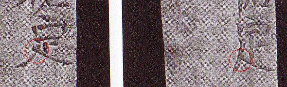

Perfect timing for yet another "which is Shôshin, which is Gimei?" exercise like Reinhard posted a short while ago. The examples I attached are from the same magazine ("Me no Me") Reinhard used, an article written by Mr. Tanobe of the NBTHK. One is genuine, the other is not.
First thoughts : I'm somewhat hesitant about these 2 kanji, for me the left one (so the one with red squares) is the shoshin one. The left mei is more squared and concise whereas the right one doesn't seem to portray the same attention to the mei. I'll check my books at home later to provide more support to my opinion.
Edit : I checked some books and for me the "blocklike" printing on the left one (kaishotai ?) seems to be the shoshin one. But seeing this is quite obvious, I'm probably wrong :lol: Also the butt of the nakago seems a bit off compared to shoshin examples.

Hi,
I think the left one is shoshin.

Dirk and Jacques are both right, die left Nakago is Shôshin. The key point is how "sada", the last Kanji, is written - more precisely, how the 7'th and 8'th stokes are arranged. the Forgerer used the "correct" form in which the last stroke starts at the line of the 7'th stroke, while Sukesada started the 8'th stroke a little earlier so it crosses the 7'th stroke. Talk about the devil being in the details ... ;)
Well I was going to take Reinhards advice & try & figure this out which probably would have led to at least another dumb ass post by yours truly..... Guido you saved me from being spanked again ! Regardless I picked up some more insight from this thread.
