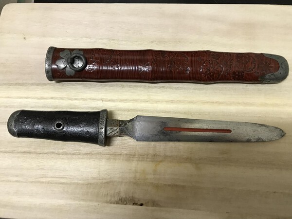

I recently got an interesting yari off ebay but it is mounted in a tanto koshirae. It has very impressive lacquer work but the lacquer is cracking, has flaked off in places and it looks like at one point someone used a sharpie to blacken some missing spots that have now grown. I would love to get the yari out and see if it's signed but I am not sure that will ever happen since there does not seem to be a mekugi, it could be glued in, I am not sure. It is so delicate in places I am scared every time I handle it, is there anyone who could correctly get this restored or just stabilized that forum members know of? Maybe this is not the kind of thing that should be messed with at all and just preserved as best it can be as is.
On a more general topic, has anyone seen yari mounted like this before? I remember reading somewhere that it was popular in the 1800's to repurpose mounts/mediocre blades to export. I would love opinions as to if this could this weird mounting style be a result of that or could it be a genuine mounting of something earlier? Thanks for your time and ideas.
-J.G.
In my opinion (for whatever that's worth...), this is very nice lacquer (not made for tourist trade).  A samurai woman would have carried this inside the lapel of her kimono for protecting herself and her "honor".  That explains the hardware (which is nice but worn) - it is sometimes called a kaiken.  The fine details of the lacquer have been worn away smooth in some places where it rubbed against the silk kimono from daily wearing.  As you may know, lacquer is sensitive to UV and will darken when exposed too much.  Fixing fine lacquer [properly] is almost always cost prohibitive and usually undertaken only on pieces in the five figure range (you may be able to find some craftsmen outside Japan to do it inexpensively, but I've never seen an inexpensive job that looked good...).  Some museums use glues to try to stabilize the broken lacquer (but it usually doesn't look very good either).  In about 50 years, I've seen about 10 of these mounted for this purpose (however, I've seen a lot more yari mounted as tanto for men).

I use a translation site, so your remark I may not understand exactly.
I think it's an extension because used the blade of a "打根”or "駕籠槍".
If the sheath of the front dagger is too short, it will be pushed out from between the obi and the kimono when  "正座".
It looks like someone has already tried to remove the blade and is breaking some. Please keep it safe.
打根

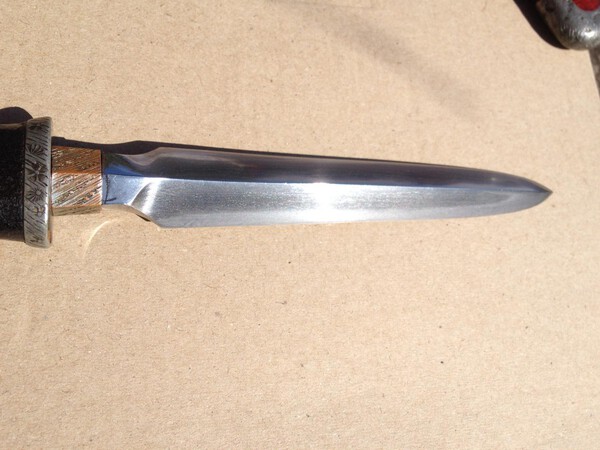

Here is a more conventional yari tanto.
The blade here.
All the best.
J.G. I also have a tanto mounted yari in my collection. It's signed Yamashiro (no) kami Kunishige (山城守国重). Both the tsuka and saya are hot-stamped with snowflakes and cherry blossoms. The photos are a bit older but show it when I got it and the blade after polish.
Given the strange wooden mount on yours, rather than a mekugi to hold it in place, I think yours may be a marriage. That is, I do not think the koshirae was made for the yari, but that the yari has been added to a pre-existing lacquered item.
