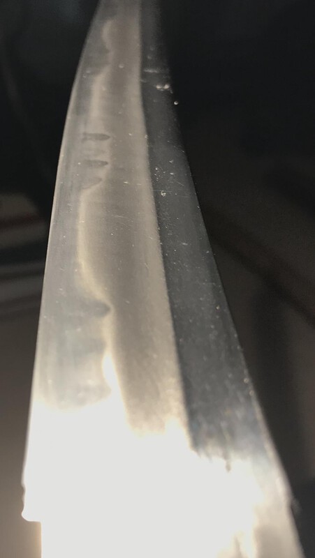

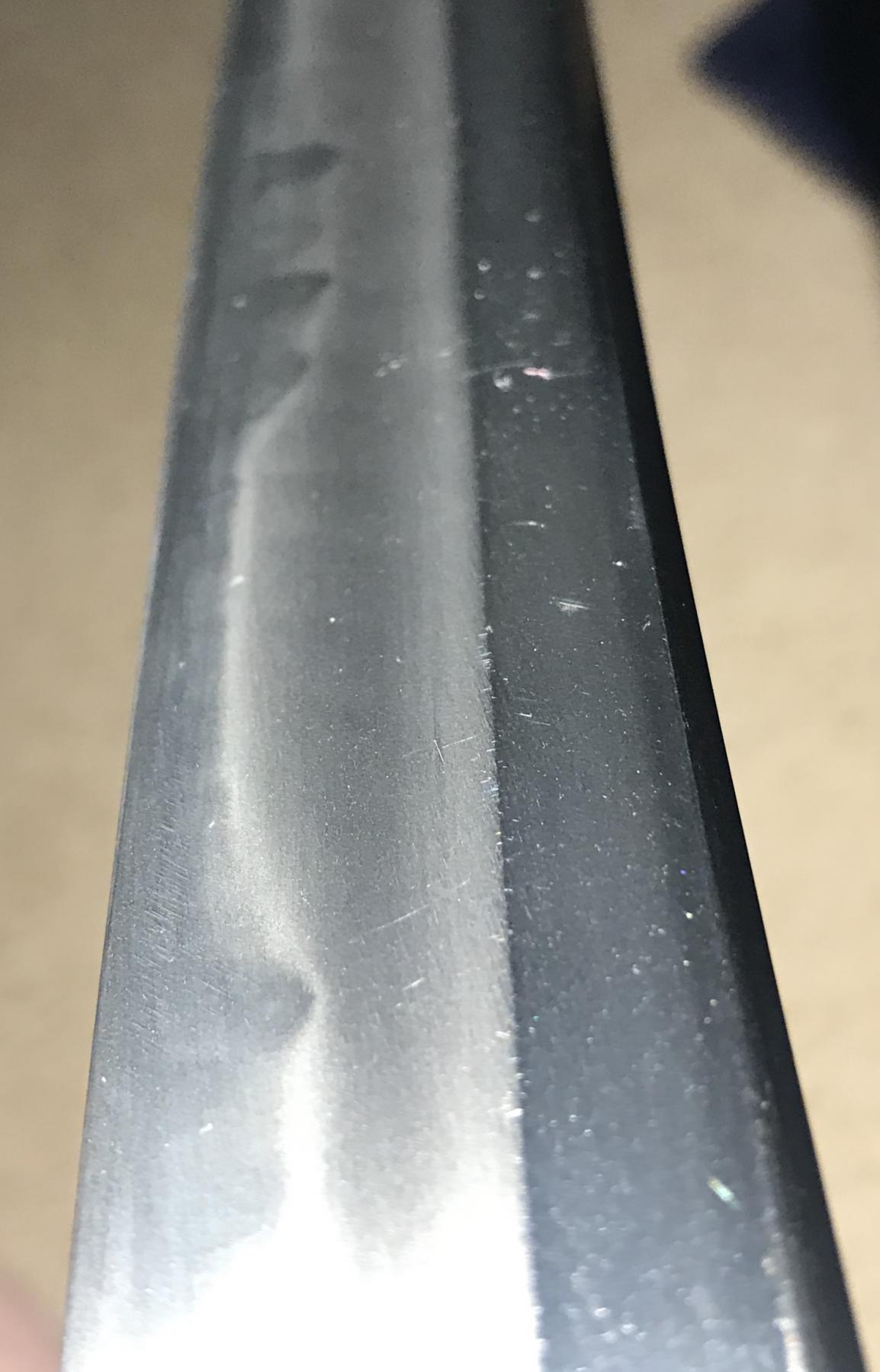

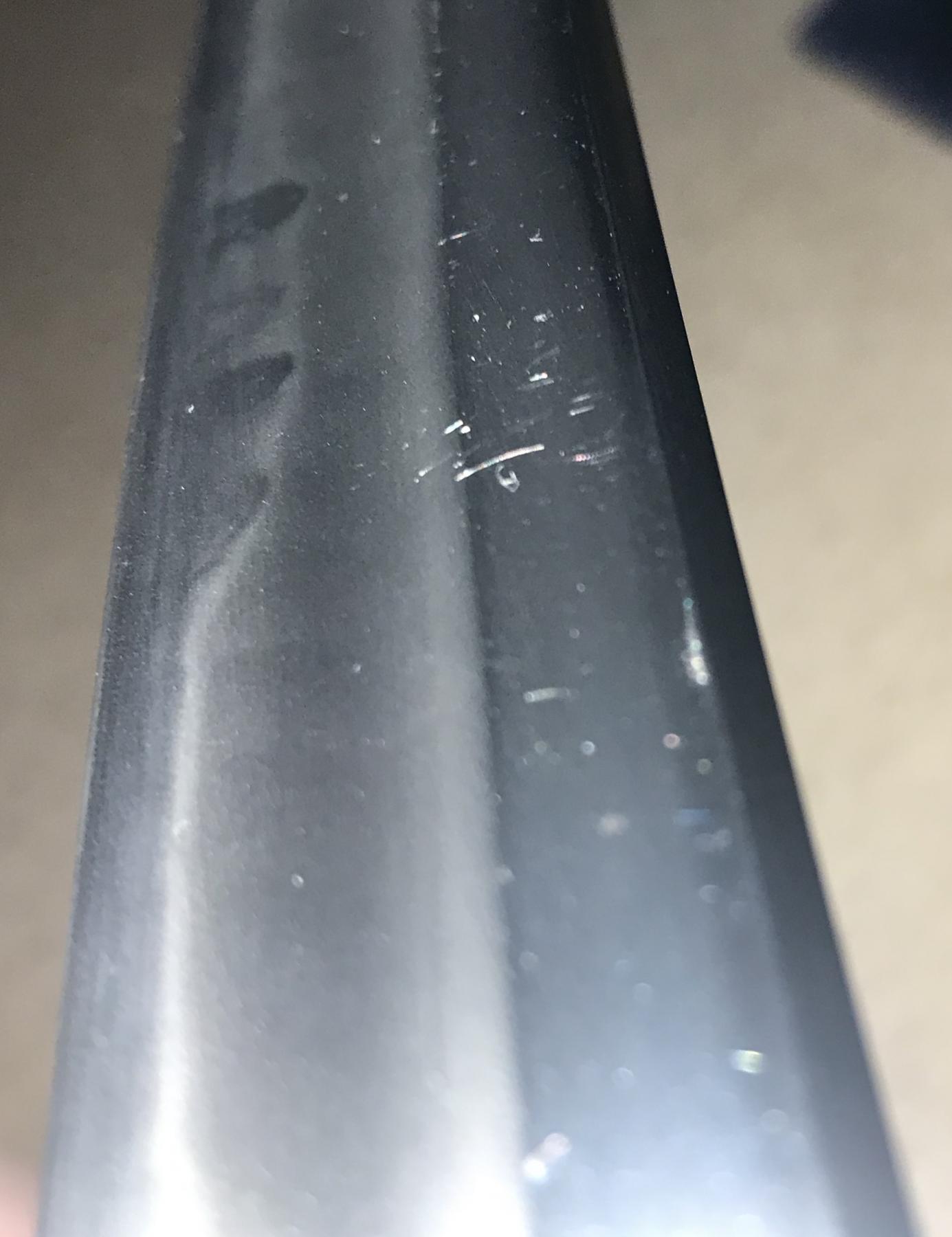

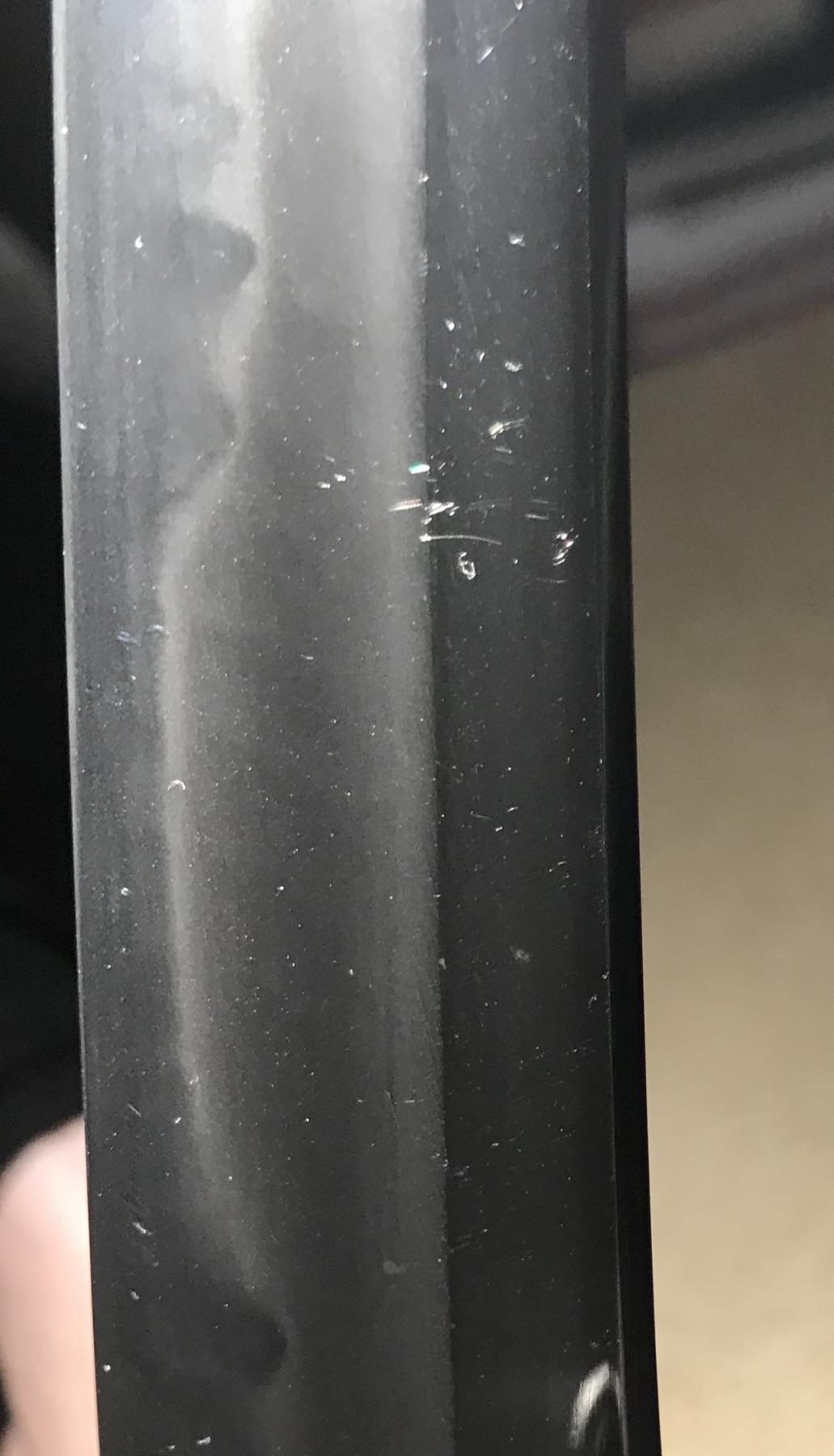

Mark S. Posted April 26, 2020 Report Posted April 26, 2020 Was looking closely at my WW2 Unjosai Katsunaga (undocumented smith) which has the appearance of an oil quenched blade and noticed a feature I never saw before. I’m not sure if it would be considered utsuri or another feature? Is utsuri even obtainable with oil quenching? Attached pics show light and dark striping perpendicular to the hamon that is very faint and I just happened to see them in the right light today. Does anyone have any thoughts? Thank you in advance, Mark S. Quote
Lance Posted April 26, 2020 Report Posted April 26, 2020 To me it looks like the ji (space between shinogi and hamon) wasn't darkened fully when it was polished, usually done with Nugui, an oil with (I believe) iron oxides in it. Wartime polishers, especially for Showa-to didn't spend the same amount of time with the finishing work, and/or weren't as skilled as traditionally trained togi so you sometimes end up with stuff that looks a little different polish wise. Regards, Lance Quote

Mark S. Posted April 26, 2020 Author Report Posted April 26, 2020 Thank you guys. The polishing answer seems like the logical answer. I just never noticed it before until I really looked and it hit the light just right... but once I saw it, it stood out and I couldn’t miss it. The more we stare at our blades, the more we see... 2 Quote
