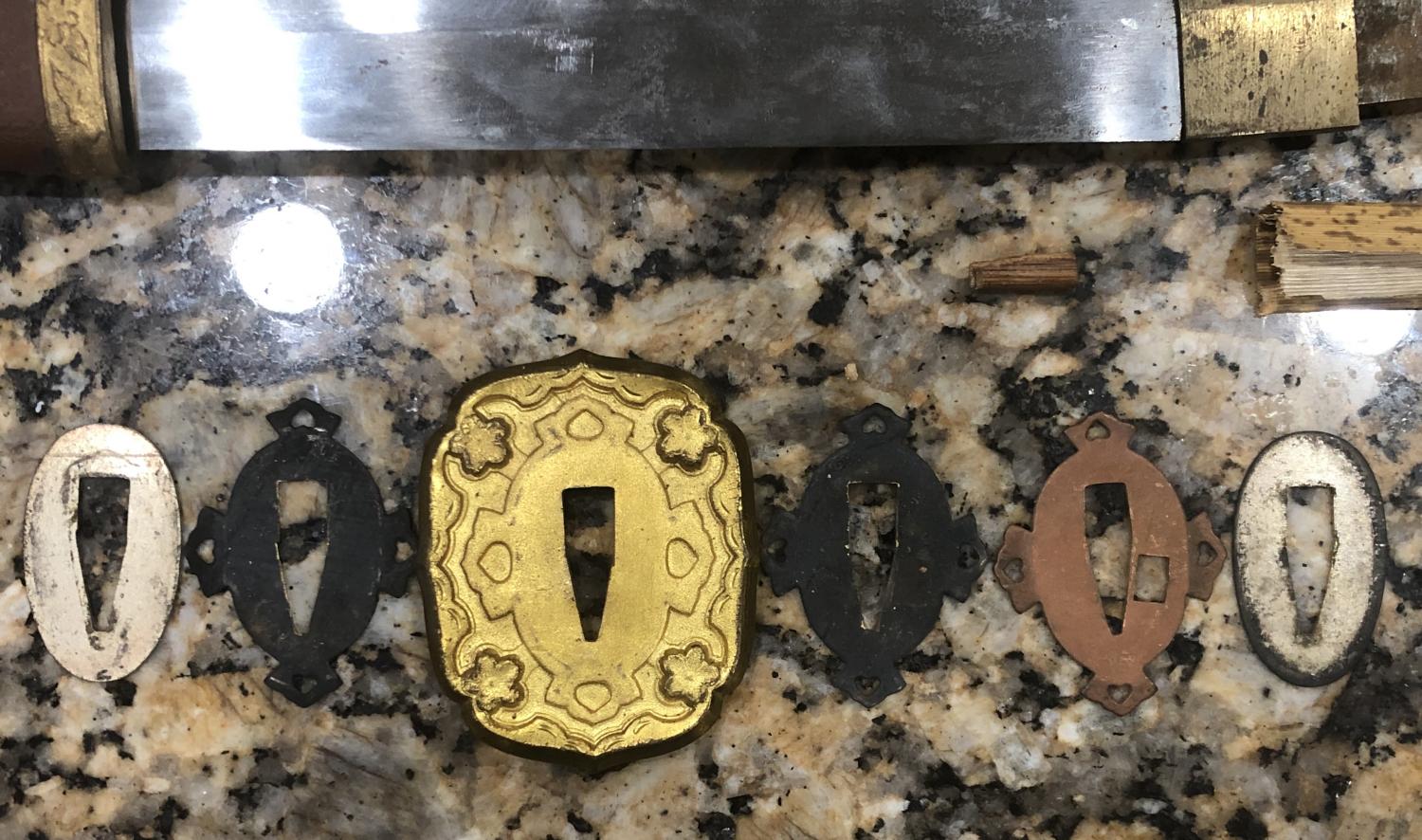

Hi all,
I recently picked up my first officer Type 98. What I didn't expect is that the Tsuba is very loose. There are 5 seppa - 2 in front and 3 behind the tsuba. Is it a matter of simply adding more seppa of the correct type and order to tighten up the fit? Thank you!  - Jeremy
How big is the gap? You can use a piece of leather cut out like a seppa. It's no guarantee that another one will be the correct thickness either.
Finding the correct Seppa for these are kind of a pain to find. I myself am still looking for some for mine.

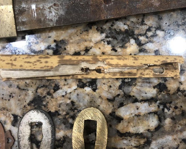

Ok, took it apart. There was a bamboo paper insert inside the grip that when I aligned better (?) - more forward inside the grip - it fits a little tighter and there is less play at the tsuba. Still noticeable bit not so loose as before. That being said I guess if I matched up the number (3 and 3) maybe that would be all it needs.
Except now after I put it back together the scabbard doesn't fit as tight when fully closed against the tsuba. I don't know what the relationship is with the seppa and tsuba that I removed and reinstalled but I can't see why the scabbard wouldn't fit as tight now.
Here's some photos and thanks for the ideas so far!
Well the fact you don't have a locking latch helps as you won't have to fit any seppa. Either make a leather one or buy a few from ebay/members. To be perfectly honest I'm not 100% certain you have an authentic Gunto on your hands but the late war ones can be pretty crude.

If you are keeping this, you can find batches of seppa for sale on fleaBay. I've bought a couple of groups myself, and fitted some to loose gunto of my own.

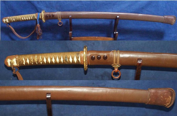

I remember this from a previous discussion . It always struck me as "too good, too new". The bottom of the  Saya, the most difficult to reproduce , looks like it is cut and glued from an older one . But hey, nothing is a surprise with gunto koshirae.
Yes the leather cover is new in my opinion, the Saya underneath is older with rattan wrap. My thoughts are new leather cover, added Ashi over the top and original bottom leather piece. Everything else seems original and of high quality. Lots of questions we will probably never answer.
 To me the sword at the top of the thread is a "bitser" possibly with an older blade. Shin Gunto mounts are normally finished with a copper plating, except for a gilded tsuba.... with the exception of our old friends the "mystery swords", which also had black same!

I will say I've seen a Mantetsu blade with a nakago far more eaten away and misshapen than this, yet it was a legit Mantetsu. So your blade could be legit. If so, like others have pointed out, this could be a "put-together" or as a minimum, the tsuka (handle) was redone in recent times. I would lean to the latter option as all the metal fittings seem to be made by the same manufacturer and not thrown together from various parts.

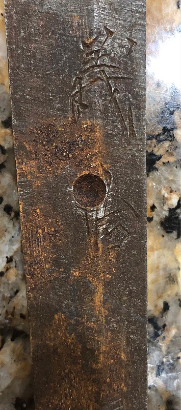

Yoshiharu, maybe?
義治
Steve, you're a good translator, what do you think of the mei? Does it appear original and legit Japanese?
John,
Your example looks legit and very good quality, even if both sets of koshirae were bittsers, the tsuba and seppa seem origninal. The implication is that there WERE gunto during the war using this. Original, pre-WWII samurai rigs didn't use retention clips or leather straps/snaps, they used friction from the habaki. So, it's possible some family blades were refitted for the war in this manner. Of course, another option is that these were made from the manufacturer without latch holes so that the fitters at arsenals could cut their own depending upon the needs of each rig. Unused, uncut tsubas might have been found in shops after the war and sold on the collector market, picked up by a bittser hobbyist and, viola!, we have mystery gunto.
All in all, an unknown.
I have some doubts because of the drill hole. Its placed such that it cuts off half of the second kanji. The right half looks like 治, but when I compare it to the 治 oshigata from Richard Stein's site, the visible bit on Jeremy's sword is a bit different from the oshigata. It seems an authentic Japanese sword, and the Yoshi (義) is fine, so that feels OK to me. I just don't know exactly what the second kanji is, and its annoying that the hole obliterates half of the kanji. That, together with the slightly random parts, makes me wonder if its assembled from parts obtained after the war (as others have suggested).
