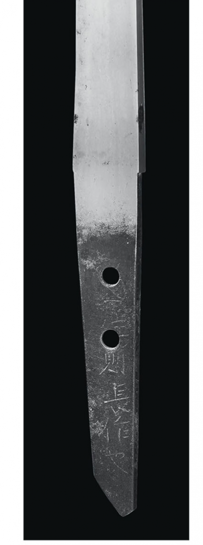

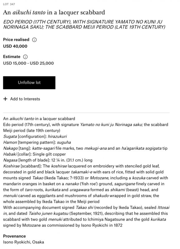

Surfson Posted March 19, 2019 Report Posted March 19, 2019 This tanto just sold today. Spectacular museum quality mounts made by several artists, including Ikeda Takao and what appears to be a late tanto signed Yamato Kuni Norinaga, that certainly doesn't match the famous Kamakura era maker. I thought I would throw in a low bid just in case nobody was watching, but no such luck. Realized price was $40K, a lot for a modern era piece, but the solid gold mounts are truly impressive. I captured a few screenshots so we have them memorialized on the NMB. 1 Quote

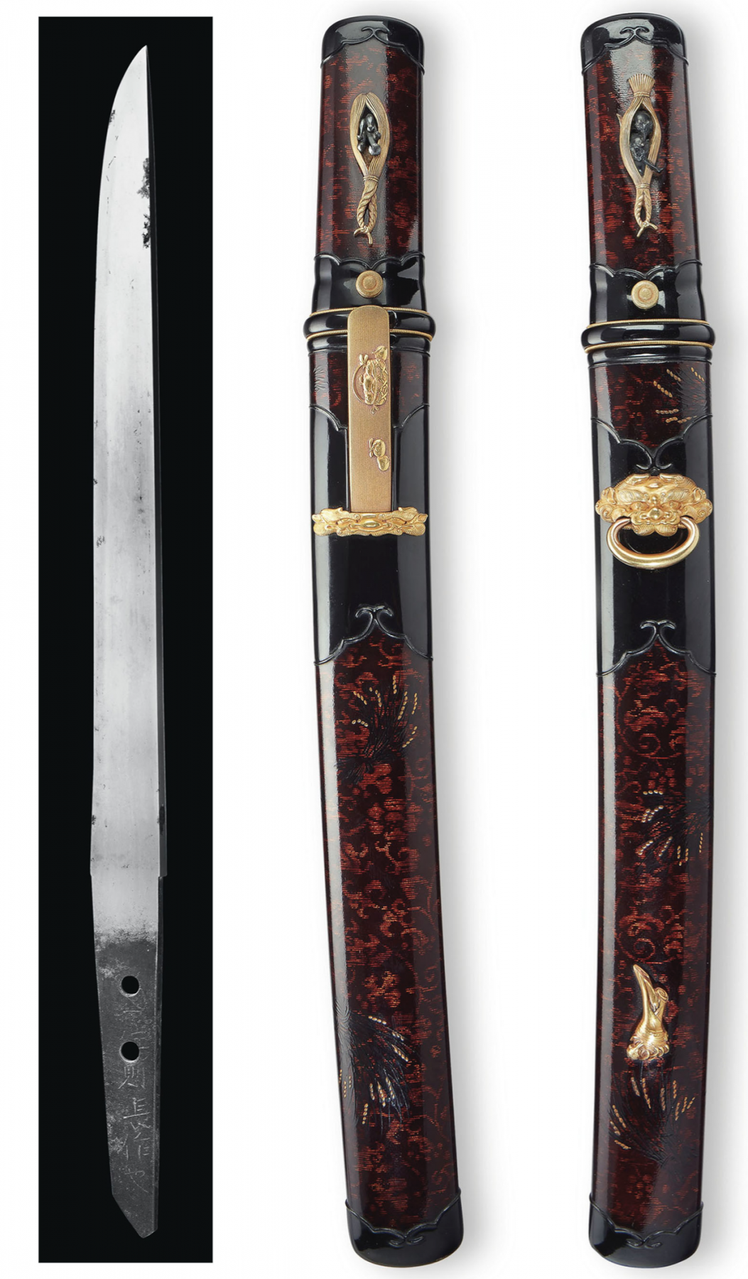

Surfson Posted March 19, 2019 Author Report Posted March 19, 2019 One more that makes the case. Quote

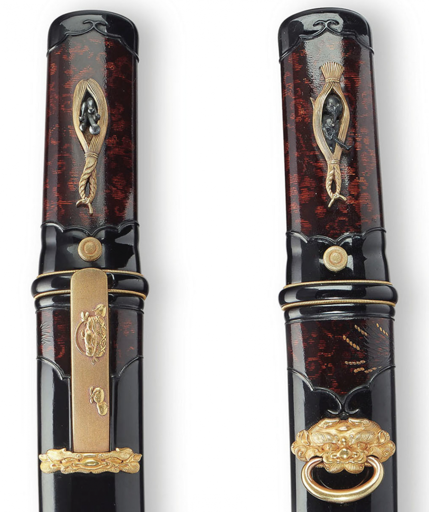

SAS Posted March 19, 2019 Report Posted March 19, 2019 Those mounts are happening. The blade looks like it might be running out of polishes. Quote
Hoshi Posted March 19, 2019 Report Posted March 19, 2019 Those mounts will go Juyo. The maker is one of the best late Meiji makers. The dagger confuses me. 17th century does not seem correct, and the signature is not the typical EDO, deep chisel strokes but more a tentative old signature in the koto flavor. No idea what it is. Speculatively, and I can't read the Kanji, it could be one of the Shikkake line Norinagas, and signed work is incredibly rare. If that's the case, blade could go Juyo too. On the other hand, the Nakago seems to have a too 'thin' patina for this to be old Yamato work and the shaping of the Nakago is not good either, unless it's been reshaped. It's a bit of a mess and raises many red flags. My money is on some no name Edo smith. Original blade was high quality, and got swapped later. But the provenance is the original client for the Koshirae, which makes this unlikely. Puzzling. The mounts itself justify the price though. A typical case of Christies hiding a specialized item into Painting & Pottery. Quote

Surfson Posted March 19, 2019 Author Report Posted March 19, 2019 My quick thought about the tanto was gimei, based on Hawley's, Fujishiro and the Nihonto Zuikan. But this was a very quick study. Quote

Prewar70 Posted March 20, 2019 Report Posted March 20, 2019 Gimei or not that blade is in sad shape Quote
