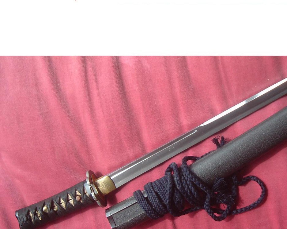

I just got this yoroidoshi from a friend who has an antique shop.
Any ideas as to age? It's unsigned. Nagasa is approximately 12 3/4" (32.4cm) long and 7/16" (.44" or 1.1cm) wide at the habaki. Tang is kiri with beveled finish. Blade shape is unokubi-zukuri and hamon is suguha.
It's a nice sturdy piece with simple fittings.

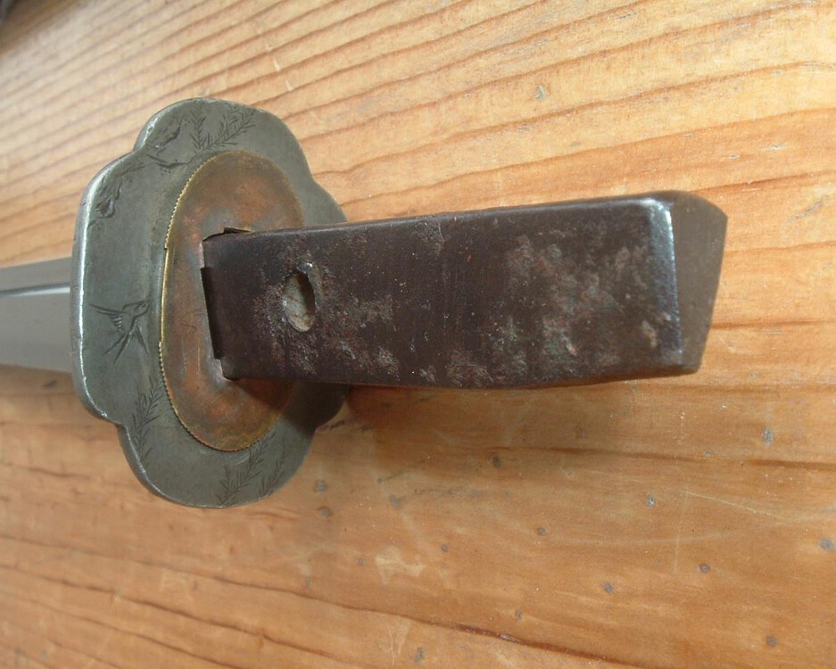

The nakago looks unusual, and not in the style a tanto is usually finished in. It definitely looks shortened from a long tang, which might well make it a shortened yari of kikuichi style.

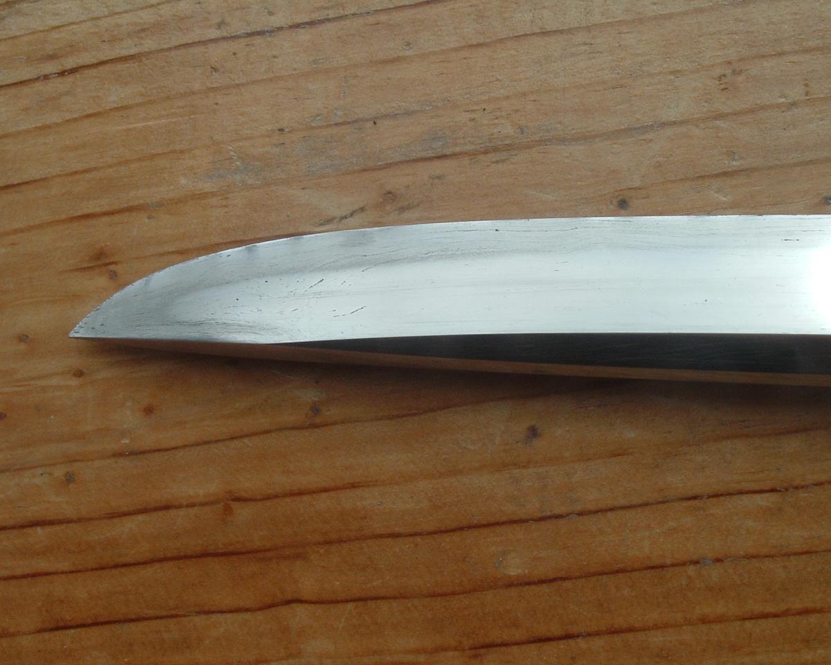

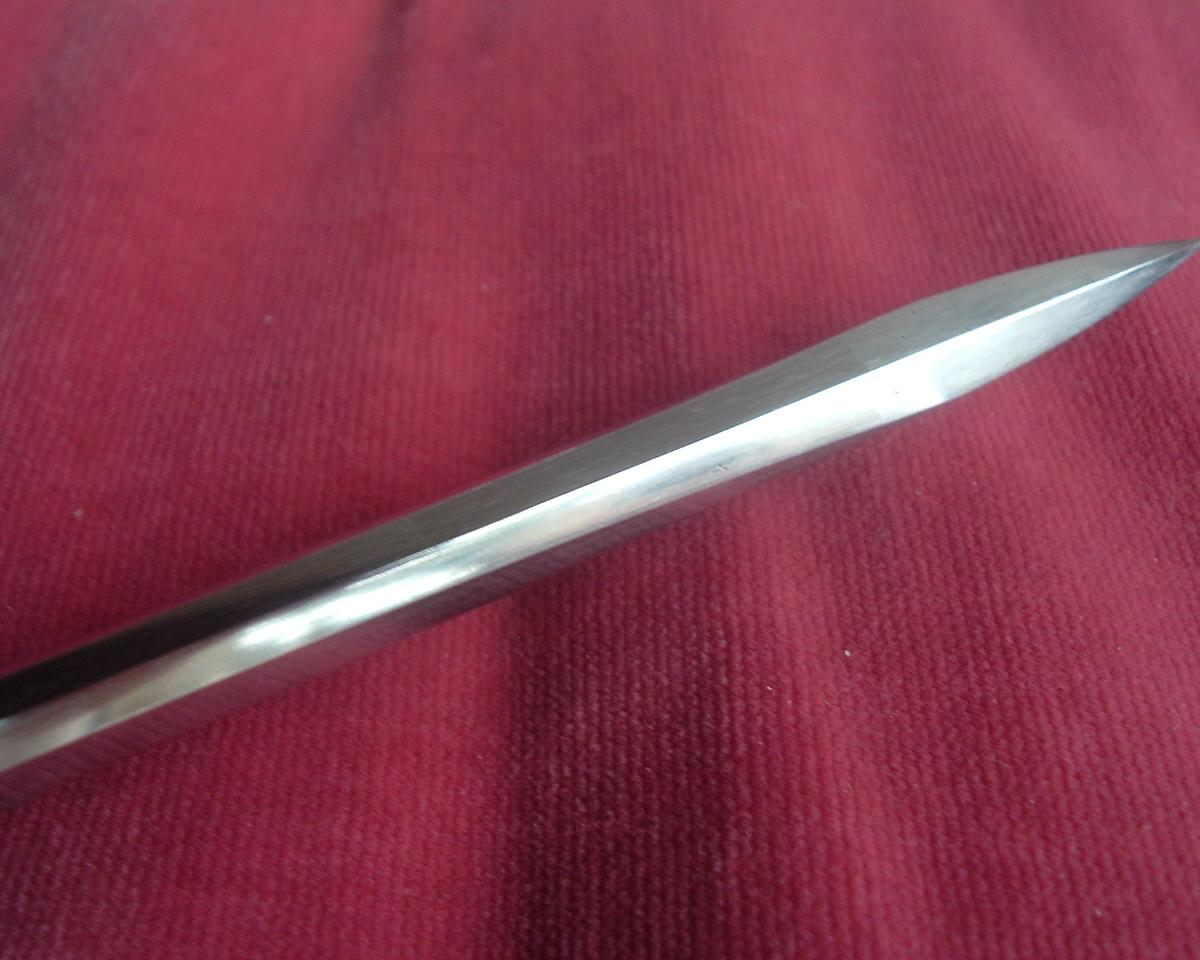

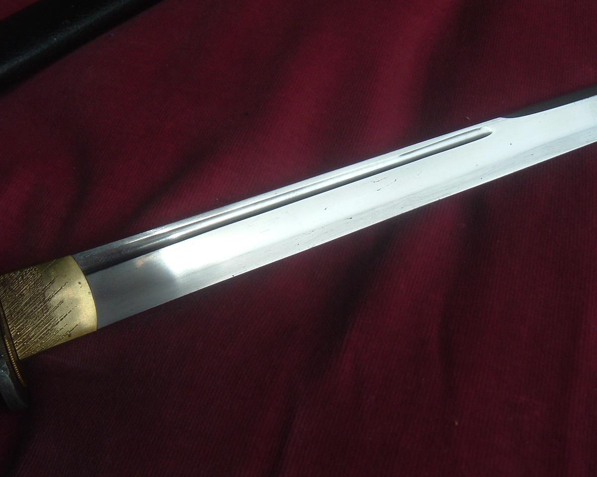

I've added a few more images. Maybe they can provide more hints as to the age. I am speculating later than Nanbokucho. But then, perhaps I'm basing that on what it is now, a yoroidoshi, as opposed to what it was originally, a yari.
Not much to add. The forging looks a little rough, much like many yari. They didn't always put as much care into the forging of a spear as a sword (yes, I know there are many exceptions)
Mounts are, I think, later, so I stick with my guess of a remounted yari. I doubt hada and/or hamon will lead to a closer attribution of age.

Just to add my halfpennyworth, I also think think that this is a cut down Kikuchi yari, the nakago has that huge width across the back shown in the picture of the cut, absolutely Kikuchi nakago. Looks like a nice blade too. Anybody any idea of age ? Chris F.
