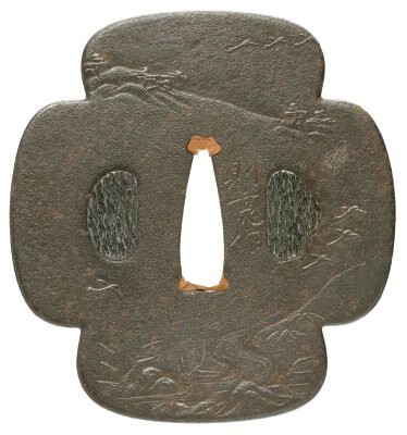

rkg Posted March 30, 2018 Report Posted March 30, 2018 Hi, I got this not too long ago, and its still confusing me. The piece was papered to Norisuke, and I'm still trying to figure out how they got to that. I did a bit of searching through what little I have on hand by this tsuba maker, and it doesn't really seem to look like their "usual" work. First up, here's a couple of images of the piece: The piece measures 82.6mm (H) X 76.7mm (W) X 3.30mm (T, web), 4.32mm (t, max, mimi), 4.83mm (t, max). Oh, and a couple of 360 image sets - as an aside, after I shot these I realized the surface would appear to "shimmer" in direct light as it moved - cool...http://www.rkgphotos.com/facebook_stuff/crane_norisuke/crane_norisuke_front/crane_norisuke_front.html http://www.rkgphotos.com/facebook_stuff/crane_norisuke/crane_norisuke_back/crane_norisuke_back.html When I first saw the auction, I thought it might be toryusai school work, as I think I've seen them do this surface treatment (and actually bori) like this before. In hand though the bird definitely isn't done they way those guys would, so its a head scratcher. My next guess would have been mito work or something (as they seemed to copy -everything-). Paper (since I scanned it - just in case anybody's interested): Comments appreciated. Thanks, rkg (Richard George) 1 Quote
John A Stuart Posted March 30, 2018 Report Posted March 30, 2018 Isn't this Ishime surface not common on Iwata II tsuba? John Quote
TETSUGENDO Posted March 30, 2018 Report Posted March 30, 2018 I believe Curran has devoted a lot of time in the study of Norisuke, his input could solve your riddle. The Norisuke were acomplished chameleons. Quote
christianmalterre Posted March 31, 2018 Report Posted March 31, 2018 i do not know Naotane, nor Norisuke to have worked with " implements " expressions in their´s Tsuba Richard. must be something other, close to this taste and time....( maybe a Kinko artist ). reliability of the papers, i think, do not need further discussion. ------------------------------------------------------------------------------------------------------ despite the above written- a lovely and strong Tsuba here Richard! very nice! Christian Quote
rkg Posted May 30, 2018 Author Report Posted May 30, 2018 FWIW, I actually ended up talking to Haynes about this one - he didn't think it was related to Norisuke either - his guess was Sano school work. Maybe a bad day Natsuo, right? (my joke, not his...) Best, rkg (Richard George) 1 Quote
TETSUGENDO Posted May 31, 2018 Report Posted May 31, 2018 I can see that vis-à-vis the Tanaka/Otsuki thing, a handsome piece whatever the attribution. Cheers, Quote
