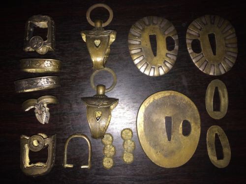

On original kaigunto’s the kabutogane, fuchi ,kuchigane ,ashi ,shibakiki and ishizuke was made by 2 sides solded together. Sakura was applied afterwards on kabutogane and ishizuke.
This way of making the fittings is not present in the fakes.

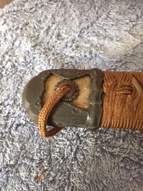

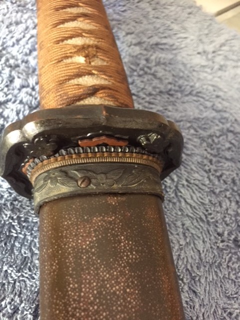

Hey guys, this a silver plated example of mine, on shark skin Saya. With a Shinto blade. So they do exist, and to my experience, were on up market outfits.
Neil,
WHat a beauty! So, it's actually silver? Looks like it because it's oxidized, right?
Chris , I remain pretty sceptical about the sword on Ohmuras site with the "silver" fittings . If the fittings are silver plated you would expect to see some wear on the plating yet there is none here . Perhaps they are solid silver but that seems unlikely. What appears to be recent binding only heightens my doubts . Ohmura certainly has some fantastic items on his site and if this is original it would of course be really unique .
Ian brooks
I've owned a gendaito with a solid silver habaki. They do exist.
Silver plated Bruce. Not pure silver. I read an article some month ago that many army civillian swords from higher ranked persons had silver plated fittings in army koshirae. I think it was in one of the military forums. The article was about a Japanese army hospital.
