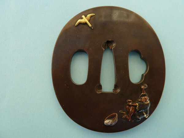

JohnTo Posted January 3, 2018 Report Posted January 3, 2018 I thought that I’d post this tsuba for all you soft metal enthusiasts. The tsuba is a mumei, shibuichi plate of mokko form, probably 19th C. The shibuichi is a grey, green silver colour, rather than the brown patina usually seen with shibuichi. Are the two colours of shibuichi a result of different pickling processes and/or a variation in the nominal 25% silver content of the alloy? Perhaps Ford would like to comment. OK, let’s take a closer look at the decoration. The main figures on the lower right hand side of the tsuba are two kimono clad women, one with a baby on her back and the other holding a flower to amuse the child. The figures are executed in gold, copper, silver and shakudo iroe takazogan and are remarkably life like and detailed, e.g. the patterns on their kimono. The next feature is the flowers (probably bell flowers and a lily) depicted in engraved outline and inlaid (honzogan) with copper, silver and gold. The inlay varies from a light wash of material to a complete inlay. The fine engraving in this and other features are precise and evenly cut. At the top left is a thatched cottage in fine gold inlay in a mountain scene. The top right shows two honzogan inlay butterflies, one gold, the other shakudo. Of particular note is the fine gold inlay lines on the shakudo butterfly (1.5 cm wingtip to wingtip) and the ca. 60 minute inlaid gold spots on the wing. I assume that the artist used a needle punch to make the tiny holes and rubbed in a gold mercury amalgam into the holes and then heated the tsuba to drive out the mercury (I believe the technique is called keshikomi zogan). The reverse side of the tsuba is decorated using similar techniques and shows a pair of quail in gold takazogan amongst flowers looking at the moon. Can anyone tell me what the significance of a pair of quail is in Japanese art? I have pairs of quail on the reverse of two other unrelated tsuba. I believe that Mandarin ducks signify wedded fidelity, but quail? To my eyes, the execution of all the items in this tsuba is of the highest quality. In view of the number of techniques involved I wonder if this is a ‘workshop’ piece involving several specialist craftsmen. Any ideas on the school and even the craftsmen? I did see a grey shibuichi tsuba from the Otsuki school with a similar mixture of engraving and inlay in the design amongst the Wrangham Collection (Part IV, Lot30) and that would be my best guess. However I realise that in the 19thC there seems to have been a more fluid interchange of kinko artists and techniques between schools. Now we come to the downside. One of the things I love about pictorial tsuba is identifying the theme of the designs, which are often representations of Japanese or Chinese history or mythology. The components of this design look totally unrelated. I call this tsuba my ‘Sound of Music’ tsuba because it reminds me of the song ‘My Favourite Things’ sung by Julie Andrews in the film. You know the song: Raindrops on roses And whiskers on kittens. Bright copper kettles and warm woollen mittens Brown paper packages tied up with stringsThese are a few of my favourite things. The reason behind this sobriquet is that I find the subject matter of this tsuba to be a random collection of pleasant images with strong feminine influences. Or to use the current colloquialism, ‘it’s a bit girlie’. Am I missing the big picture and does anyone know the tale depicted here? Looking at pictorial tsuba with human figures in various books and sale catalogues the figures nearly always face the seppa dai, or at the scene on the other side of the tsuba. In this tsuba the ladies are walking away from the hut and the idyllic scene in the background. Is this a symbolic representation of the ladies leaving ‘the Garden of Eden’? Perhaps one of the girls has been sent away from home for having an illegitimate child. I cannot imagine a macho samurai wearing this tsuba. It was probably made for the gaijin tourist market, but there is some staining around the seppa dai, indicating that is was mounted on a sword. Of course it may have been mounted on a garish set of koshirai on a sword put together for tourists, but then sold separately or removed once exported. If it was owned by a Japanese person, I can’t help feeling that it was for someone in the ‘floating world’, possibly a merchant, or a kabuki actor. Comments welcome Happy New Year, regards John (Just a guy making observations, asking questions and trying to learn) 2 Quote
JohnTo Posted January 3, 2018 Author Report Posted January 3, 2018 Ooops, I forgot the tsuba dimensions: Height: 8.2 cm Width: 7.0 cm Thickness: 0.3 cm at the rim John Quote
peterd Posted January 3, 2018 Report Posted January 3, 2018 I have never seen brown shibuichi. Sentoku is brown-orange. Shibuichi is silver grey to dark grey ? Quote

peterd Posted January 6, 2018 Report Posted January 6, 2018 Hi John. Your tsuba looks a lot different to the picture in the catalogue, although definitely the same piece it appears dark grey, almost black in there picture. Would be better to see in hand. I think the red-brown colour comes from the more volatile elements having oxidised leaving behind a copper rich surface. For your interest please look up. (in tosogu what shibuichi looked like when it was new 01sep 2015). Please let me know what you think, we are both here to learn. Best regards Peter. 1 Quote
JohnTo Posted January 7, 2018 Author Report Posted January 7, 2018 Hi Peter, I agree that most of the literature describes shibuichi in various shades of grey-green, apart from kuro shibuichi, which is black. Nonetheless, the brown alloy that I see in kodogu at the London auctions is described as shibuichi. The only other shibuichi item that I have is the first piece of kodogu that I bought (not attached to a sword), back in 1975, at Sotherby's. It is an Omori waves style fuchi/kashira and is a chocolate (between milk and plain) brown. As a result of owning this I always take a particular interest in Omori wave pieces when they come up. To my best recollection they were always described as shibuichi and are chocolate brown. This is why I asked Ford to comment regarding patination. We are all trying to improve our knowledge base. Maybe the auction houses are using the wrong terminology, some of my pieces were badly catalogued, including a black 'bronze' tsuba which proved to be magnetic. Next time that I am in London for a viewing, I'll pop into the V&A and take a better look at their pieces and how they are described in their handy catalogue situated by the display. All the best, John Quote

Babu Posted October 4, 2020 Report Posted October 4, 2020 I'm a little On 1/3/2018 at 4:24 PM, peterd said: I have never seen brown shibuichi. Sentoku is brown-orange. Shibuichi is silver grey to dark grey ? I'm a little confused by the above statement. I don't think the poster is an active member any longer but whatever the case its completely wrong I have over 60 fuchi kashira and kozuka in chocolate brown shibuichi of varying shades.. Quote
peterd Posted October 4, 2020 Report Posted October 4, 2020 Adam. I just formed my opinion from a topic. What shibuichi looked like when new. In tosogu 1 september 2015. Some one called Ford Hallum. Quote

Babu Posted October 5, 2020 Report Posted October 5, 2020 11 hours ago, peterd said: Adam. I just formed my opinion from a topic. What shibuichi looked like when new. In tosogu 1 september 2015. Some one called Ford Hallum. I'm just stating I have a collection of many fuchigashira and I've a great many with varying shades from golden to chocolate brown and they are not faded colours. I see brown shibuichi more than the grey you mention although I do have the Grey's. I would expect most people into Nihonto to have seen brown shibuichi at some point but clearly I was wrong. It's probably making up 30% if my collection. What I do know is that the mix for shibuichi will determine the colour outcome and that this is always at the discretion of the artist . Some of the skills are also lost. Ford is a respected and exceptional artist and he is hopefully doing work for me in 18 months , but thinking he is the font if all knowledge is foolhardy to say the least and I expect he would admit this. He does not have all the answers to questions from over 200 years ago. What say you ford , Do you know everything or are you still as we all are learning ? Quote
peterd Posted October 5, 2020 Report Posted October 5, 2020 I thought the word shibuichi means three quarter. I assumed (which is probably where i got in trouble) that it means 75% copper 25% silver. If other metals are added this would make a difference. Quote
ROKUJURO Posted October 5, 2020 Report Posted October 5, 2020 I have read that the term SHIBUICHI is to be interpreted as 'one part of four', so it is indeed 25% silver. 1 Quote
parfaitelumiere Posted October 5, 2020 Report Posted October 5, 2020 I think some other variable can have incidence, what kind of copper, is it yamagane based, I think even the term yamagane can be subject to interpretation. There are probably several copper silver and other alloy sources in Japan, and probably some foreign sources too. Depending on refining abilities, the final patina will change, also, depending on metal mixing, the final result will be different, there is virtually infinite combination possibilities. That makes me think about antique gold coinage and jewelry, made from natural gold metal, called "electrum" silver percentage varying from almost zero to almost 100%, making color vary from strong gold to greenish shades to almost white color, even native gold color can vary in the same mine (example, rosia montana mine in romania, very nices leanes and crystals on quartz). Lets suppose some older metal recycling too, because gold is expensive, so, combination and final color can be almost infinite. Only individual chemical test could bring knowledge about the specific alloy used for specific item. 1 Quote
Brian Posted October 5, 2020 Report Posted October 5, 2020 54 minutes ago, Babu said: Ford is a respected and exceptional artist and he is hopefully doing work for me in 18 months , but thinking he is the font if all knowledge is foolhardy to say the least and I expect he would admit this. He does not have all the answers to questions from over 200 years ago. What say you ford , Do you know everything or are you still as we all are learning ? 1 Quote
Ford Hallam Posted October 5, 2020 Report Posted October 5, 2020 No, I can't say I do know everything...even in my chosen speciality of fine metalwork. But to suggest that I'm just like you, and 'still learning' misses a pretty significant difference.🤔😉 What I offer is based on my 40 years of craft specific experience, literally 100's of XRF analyses and 100's of restoration jobs on some of the very finest Japanese metalwork available (not ebay dross). There's nothing that immediately comes to mind with regard to shibuichi that remains vague or a mystery to me. I absolutely would not say, at this stage, that there is anything lost from how shibuichi was made or worked, certainly not in my understanding of the subject. And to reiterate, this is based on 40 years experience as a professional Goldsmith, training in Japan, countless hours of scientific analysis and 1000's of pages of textual research. I will state unequivocally that when newly made and traditionally patinated shibuichi alloys exhibit a grey tone. The exact shade of grey, nezumi-iro, is dependant on the actual silver percentage AND how long the alloy mix was held at liquidus, or allowed to stew when fully melted. For a detailed explanation on the making and processing of shibuichi you can watch this film we just posted last week. Shibuichi exhibits a finely granular surface structure, a bit like a stone wall, with particles of silver seemingly embedded in a copper matrix. This structure is what gives rise to the characteristic 'nashiji' surface effect in shibuichi. It also means that when the silver and/or copper particles are acted upon by pollutants they can each develop different oxides, chlorides and sulphides. Silver can develop a layer of silver sulphide and then the shibuichi turns very dark, almost back. Or, it may develop silver chlorides, and turn the patina decidedly green. The copper component can become redder or blacker...,or even more green than the tone silver chloride causes, at which point there's a real corrosion problem, again, depending on the pollutants in the immediate environment of the shibuichi. I've worked on a number of very fine shibuichi pieces, Unno Shomin, Unno Moritoshi, Kaigyokusai Kazuhisa et al, where they've been needed to be dismantled to some degree. Panels in frames, boxes, stands with feet etc, and often found that their lovely greenish or brown tinted shibuichi patina wasn't in evidence in the areas that had been covered or otherwise protected from the atmosphere or handling. On those, untouched, surfaces the patina was unchanged and perfectly grey, and often startlingly fresh, as though done the day before. As a specialist, with the additional advantage of greater scientific and metallurgical insights (I stand on the shoulders of others here) than those that were available to Edo workers I'm advantaged in having a better understand the mechanisms by which all of this comes about. But, after a couple of hundred years of using the alloy Japanese metalsmiths of the Edo period knew what effects were stable and what would likely happen to pieces over time. I've even read accounts in period diaries that mention the need to have tosogu periodically refinished, so some degree of ongoing maintenance was not uncommon but deliberately applying effects that would lead to damage or the 'muddying' of the work's visual impact simply isn't something that I've found any evidence for. To summerise, shibuichi is grey, of various tones dependant on silver content. But, beyond the exact control of the maker the final patina colour can also be affected by the melting time and conditions. Any other hints of colour are the result of later interactions between the surface patina and immediate environmental conditions. Some of these later developments in the surface patina are stable, while some are ongoing and will result, eventually, in significant surface degradation. Adam, I'm also very curious to know why you think that "Some of the skills are also lost." I assume this is with reference to the subject at hand, shibuichi, or why else would you mention it? 8 1 Quote
Babu Posted October 5, 2020 Report Posted October 5, 2020 2 hours ago, peterd said: I thought the word shibuichi means three quarter. I assumed (which is probably where i got in trouble) that it means 75% copper 25% silver. If other metals are added this would make a difference. Absolutely correct but it's still variable depending on the artists choice of outcome and the mix he used. Quote

Ford Hallam Posted October 5, 2020 Report Posted October 5, 2020 Barry, I'm now pretty keen to get the book out too. It's going to provide a few points that will no doubt require some rethinking in terms of dating of certain non ferrous pieces, so that'll be fun to watch And, as I describe in the film I linked to, shibuichi is actually mistranslated as being a 1/4 alloy. One important Edo period text explicitly describes it as a 20% silver and copper alloy ,and that being the origin of it's name. This is further supported by numerous analyses I've carried out. There are in fact two, three at a push, distinct groupings of shibuichi alloy. The 20% ball park composition (actual analysis results show a little variation, around 2 percent either way) is by far the most common. The only other trace metals we find are lead and gold. The lead, usually less than 0.5%, is a residue of the copper refining process and the gold is inevitably residue in the silver from it's refining. Again typically less than 0.5%. Neither of these trace metals alter the working and patinating properties in any significant way. The book will provide exhaustive data analysis that accurately provides a pretty clear picture of the whole Japanese alloy pallette. Quote

Ford Hallam Posted October 6, 2020 Report Posted October 6, 2020 Perhaps I ought to add at this point in the discussion that if your suspected shibuichi pieces are a chocolate brown colour then they are most probably not shibuichi but rather either nigurome (copper with the addition of shirome, itself a spiese, or refining byproduct, containing arsenic and antimony, and which tends towards a reddish brown) or a copper alloy with literally only 1 to 4 percent silver present, which would fall outside of the generic shibuichi group. Of course, an accurate identification of an alloy would only really be possible with a chemical analysis. This brown patinated alloy has previously not been documented but is essentially a sort of shakudo but for the substitution of silver for gold. I actually predicted this alloy might be more commonplace over 20 years ago when I had a piece by Shoami Katsuyoshi analysed and which contained one such sample. I then found more samples in the surveys I carried out at the V&A. It would appear to me that, based on the quality of the pieces I've identified, that is may have been a cheaper substitute for regular shibuichi, when used as the ground material, given the very small amount of silver used. I would suggest this particular alloy goes unnoticed often when it shows up as a small detail in an iroe composition, like as a staff or other 'wooden' object. Quote
Babu Posted October 6, 2020 Report Posted October 6, 2020 16 hours ago, roger dundas said: "Adam's audacity and self assurance is fascinating " Jeese no one's allowed an opinion on the NMB are they. How on earth do you learn? If as Ford stated all the chocolate brown finish that both John Lissenden and myself have always referred to as a "chocolate brown shibuichi" then I stand corrected and am more than happy to re-educate myself and change the descriptions on my pieces to nigurome. I was merely educated by John's description of the material and on many of his peices . I find it strange that in all the years Docliss was on here he was never corrected by Ford or indeed anyone else in his description of that chocolate brown polished metal colour which he's always called shibuichi. In fact it's only come to light now so my questions have in essence helped you all. So for the record are you saying for that this is not shibuichi and that's a fact? Regards Adam Quote
