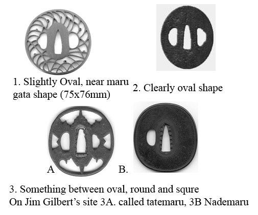

Now there would be no serious problem, but we have three kinds of oval tsuba, and each author gives a different terms for them.
How would you called each of this tsuba shapes:
It would be great if someone could provide some serious source for these terms, and make it straight. :bowdown:

Thank you both for reasuring me. It was quite frustrating while describing tsuba, seeing not exact explanations in few books, conflicting each other (I did not mention all books here in my post). So I started to wonder... :crazy:
On the other hand. I'm quite curious, when - in your opinions - we can start to call tsuba to be oval? Some of the authors are very restrictive, describing tsuba as oval, even if differences between lenght and width is of 1mm. The other ones are starting to call them oval when the difference is bigger (3-4 mm at least) - and it is a method I'm supporting, judging the shape of a tsuba not only by its dimensions, but through the overall look.
What are yours opinions and methods of distinguish the small border between oval and round shape?
Thank you!
I think there are slight differences in those terms and their corresponding shapes. But before giving my thoughts, I would like to make sure of Nademaru-gata. Isn’t the correct term Nadekaku-gata (撫角形) ?
I'm familiar with both terms: nademaru and nadekaku, and there are some glossaries/books where you can find both terms described as quite different ones. Nadekaku is often described as "a slighly oval, square shape", "rounder square shape", or "square shape with rounded corners" and I believe this shape looks like here: http://www.aoi-art.com/fittings/7600-7649/07625.html
Isn't it?
But I admit nademaru term is rarest from all three mentioned here. I found this term in one Polish book but also in the glossaries on www pages: http://www.shibuiswords.com/glossary1.htm and also here: http://www.nihontokanjipages.com/kanji_for_tsuba.html and few others (just type this term in google). It doesn't mean anything, while still this terms doesn't have to be right, so if you have any clue please share! Interesting is, in Polish book the shape given as Nademaru gata is indeed a "square with rounded corners"!!! and the shape on the picture above (3B) is also close to the nadekaku indeed.
Regards!

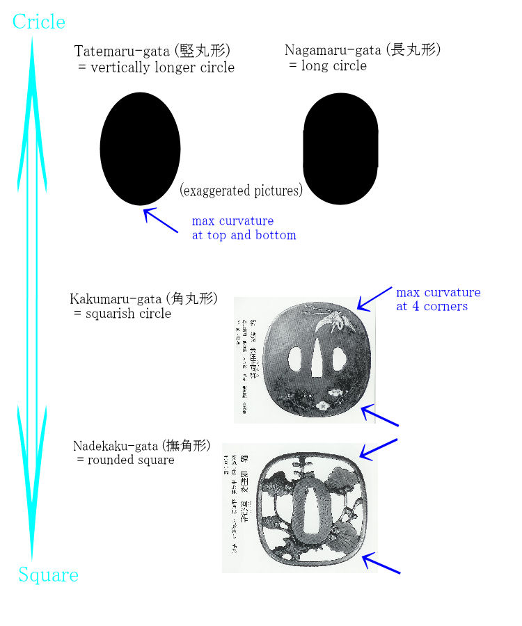

At least, I found five terms about oval (?) like shape. Their literal meanings are loosely as follows;
Tatemaru-gata (竪丸形) – vertically longer circle
Nagamaru-gata (長丸形) – long circle
Kakumaru-gata (角丸形) – squarish circle
Nadekaku-gata (撫角形) – rounded square
Nademaru-gata (撫丸形) – rounded circle???
Though Tatemaru and Nagamaru are different words and they have different meanings, practically they seem to express the same oval like shape in tsuba world.
Kakumaru and Nadekaku are more close to square shape categories. According to the glossary of Choshuya-ginza, Kakumaru-gata is rounder than Nedekaku-gata.
One point I noticed is the curvature on the circumference. General oval shape has two max curvature points on its top and bottom naturally. On the other hand, Kakumaru-gata and Nadekaku-gata have four max curvature points on their corners, as their shapes are based on squares.
However, the practical usage of above terms does not seem to be so strict.
- Tatemaru and Nagamaru are used for the same shape.
- I found many cases in which the shapes like Kakumaru-gata are called as Tatemaru-gata.
I could not understand Nademaru-gata. I found one example with its picture in NBTHK magazine. But I do not know why they call that Nademaru.
