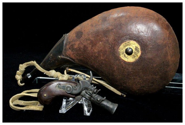

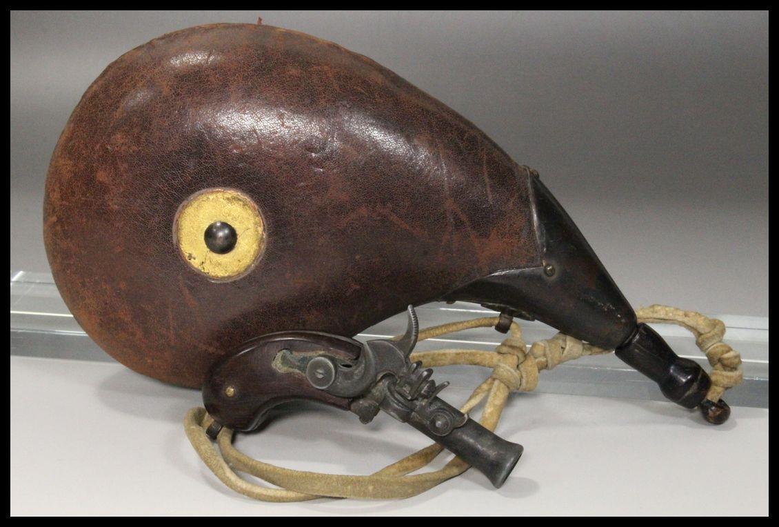

Hello Guys, :)
Hi Eric  :)
I don't know if this will help.
I just got this Kayakuire...
Looks like an Egg Plant shape.
The parts on the Netsuke move.
The top trigger is spring loaded.
I am just getting into Japanese firearms, after watching Kagemusha..
Thought this was a nice little collectable to have.
Alton Takata :)
Hi Alton
The ‘Netsuke’ looks like a toy, (what does the pan look like?) but the powder flask looks genuine, and it could well be Japanese, although granted it is an unusual shape. A Nasubi shaped Kayaku-ire, hmmmm....we like that idea!
(Hard to see properly and a shot of the opened stopper would be great if possible.)
