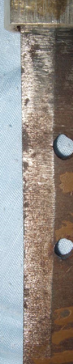

The nakago really looks reworked in places. The blade itself looks machine-made. Not too many good pictures of the blade, but it looks like the typical oil hardened suguha to me with no hada and this fine nioi line .
I am really surprised there is no stamp. What I like are the bold characters of the mei which look much better than the usual signature on machine blades.
The habaki, by the way could easily be removed with a piece of wood and a hammer without doing damage to the blade.
Best, Martin
The sword probably had another mount before it. That's why the nakago has two holes.
There are no other mei on the painting side. Just the signature of the blacksmith on one side of the nakago.
